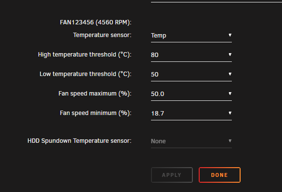

  8. the logging on my recycle bin is broken. been using for years, updated to 7.0.0 shortly after release, been fine. i updated recycle bin recently and noticed that it isnt logging when i delete files. now when i delete a file thru smb, it moves the file to the recycle bin folder (as it should). but nothing shows in the log. when i go delete the file from the recycle bin folder (also thru smb), then it shows in the log. this was never the behavior before, it would show in the log immediately, then after the 5 min interval, would actually show in the recycle bin to be emptied. is this a known issue, or am i missing something? does using exclusive shares have anything to do with logging behavior? share exclusivity and updating recycle bin plugin are the only thing on my server that ive changed recently. thanks!
  9. when below your minimum temp setting, the fans run at the fan speed minimum. once it hits above your minimum temperature, it starts applying the curve between your fan speed minimum and fan speed maximum depending on your temps for the settings you posted, your fan logic would be: -run the fans at 1.5% until the CPU hits 20 degrees. -between 20 degrees and 80 degrees, apply and set the fan speed/curve between 1.5% and 75% depending on where the temperature sits between 20 and 80. -any temp past 80, run the fans at 75% (the "fan speed maximum") these are bad settings because your CPU will never run below 20 degrees. my CPU idles in the mid-40 degree range, so I have my low temperature threshold set to 50, so the fans don't bounce around with minor temp changes at idle. it doesn't start applying the curve until it hits 50 degrees (my low temperature threshold), which means the CPU is actually doing something, so it starts ramping the fans up (at 50 degrees)
  10. post your fan control page and what temps you're seeing
  11. ah ok, that is the discrepancy then. i ditched the midplane and put the tower heatsinks in mine and i can get it to idle at 18% (or even lower if i wanted, really) and be pretty quiet and stay cool.
  12. how how it is in the room where your server is? what is "idle" to you? these are my settings (r730xd with 2x 2680v4): my fans have been idle all day (at 18%) and my cpus are in the 44c-47c range. something seems off. do you have the flat, low profile heatsinks or the tower heatsinks?
  13. it still polls at the time you set, but only posts to the log if it is actually making a change to the fans, as to not clog up the log with a bunch of redundant non-changes you were below your low temp threshold, so the fans were just running at minimum speed

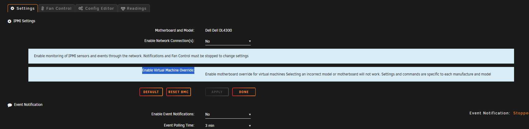

  14. when you are below your "low temperature threshold", your fans will run at the "fan speed minimum" which it appears to be in the log. what are your temps getting up to and its not increasing your fans?
