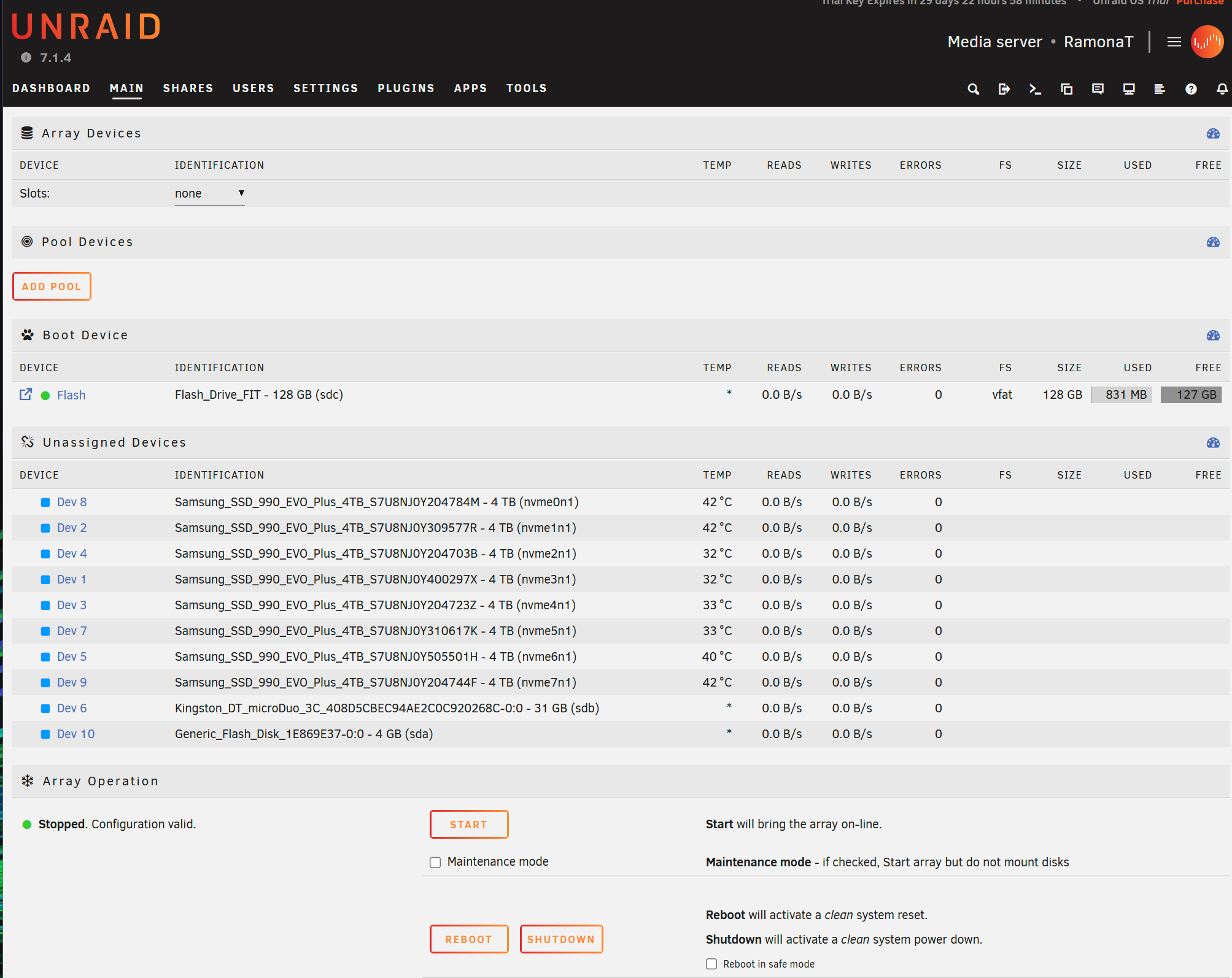

  1. Hi there, I am new to Unraid, apologies for newb q's. The system I had a TRAID configuring in Terramaster TOS 6. The NAS is NVME drives only, 8 x 4TB Samsung 990 EVO Plus. I make the recommended BIOS changes to boot drive, secure boot, and VT-d. I created a flash install and booted the system with no changes to Unraid 7.1.4. I have connected to the NAS via tower.local and am on the Main tab. I have a Kingston flash drive externally in the USB port for use as a dummy array disk. I intend to have all NVME drives in the Pool. No Disk 1 appears under Array Devices, nothing is in Slots. The Array Operation shows the array as Stopped. I have never configured an array in Unraid, I am assuming this is an error perhaps it is seeing some info from the TRAID array it was configured as. What have I tried to do to fix I have gone to Tools and New Config. I have tried to reset the array disk config, this does not do anything I can see. I have rebooted after doing New Config, even though I was not prompted to do so. Stuck. I am an hour into this and not making progress. Google Gemini was pretty helpful so far, but troubleshooting has stalled after new config. Ideas? I have attached a screenshot of System Devices under Tools. Also a screenshot of main tab for clarity. Thanks!
