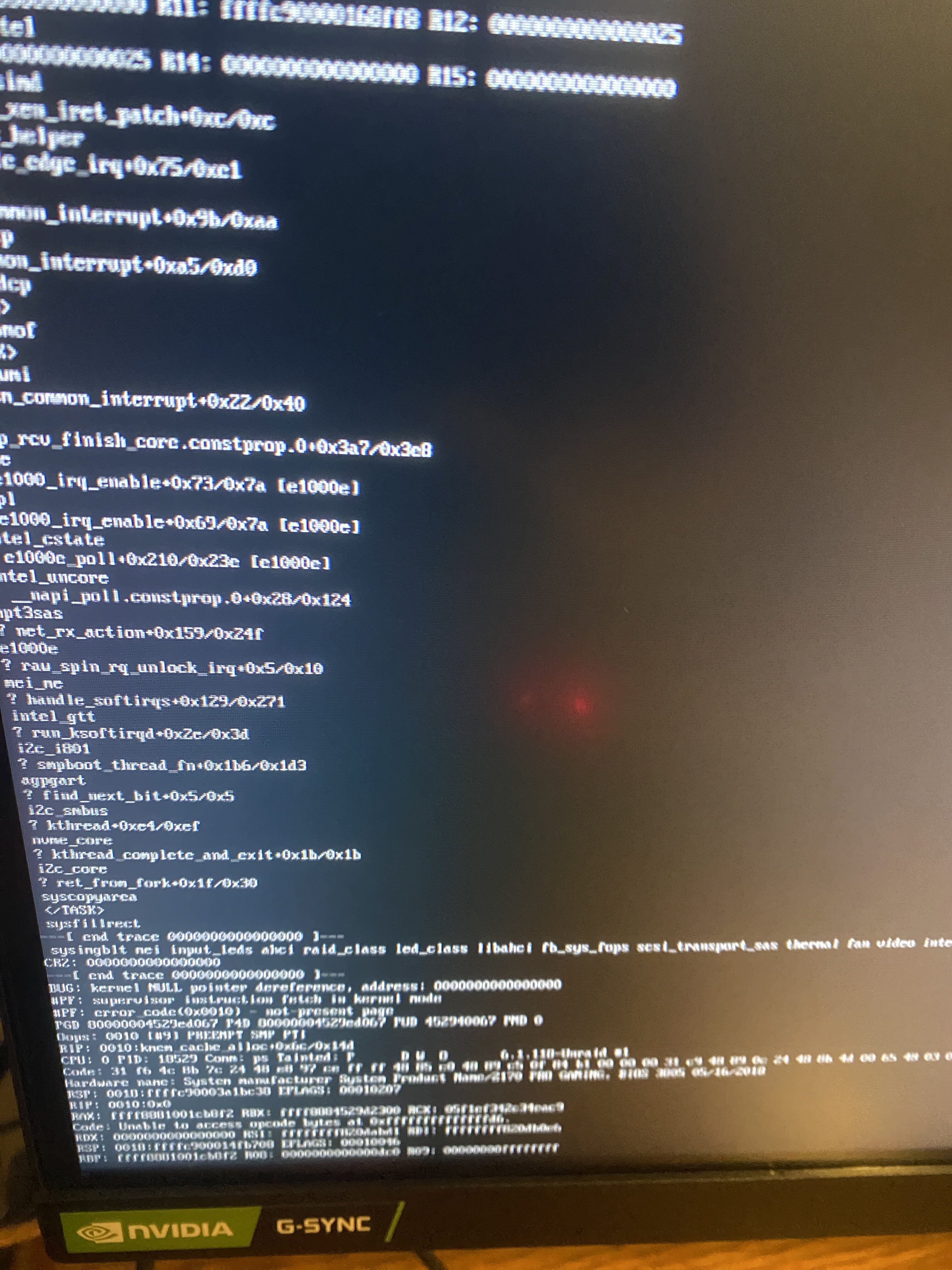

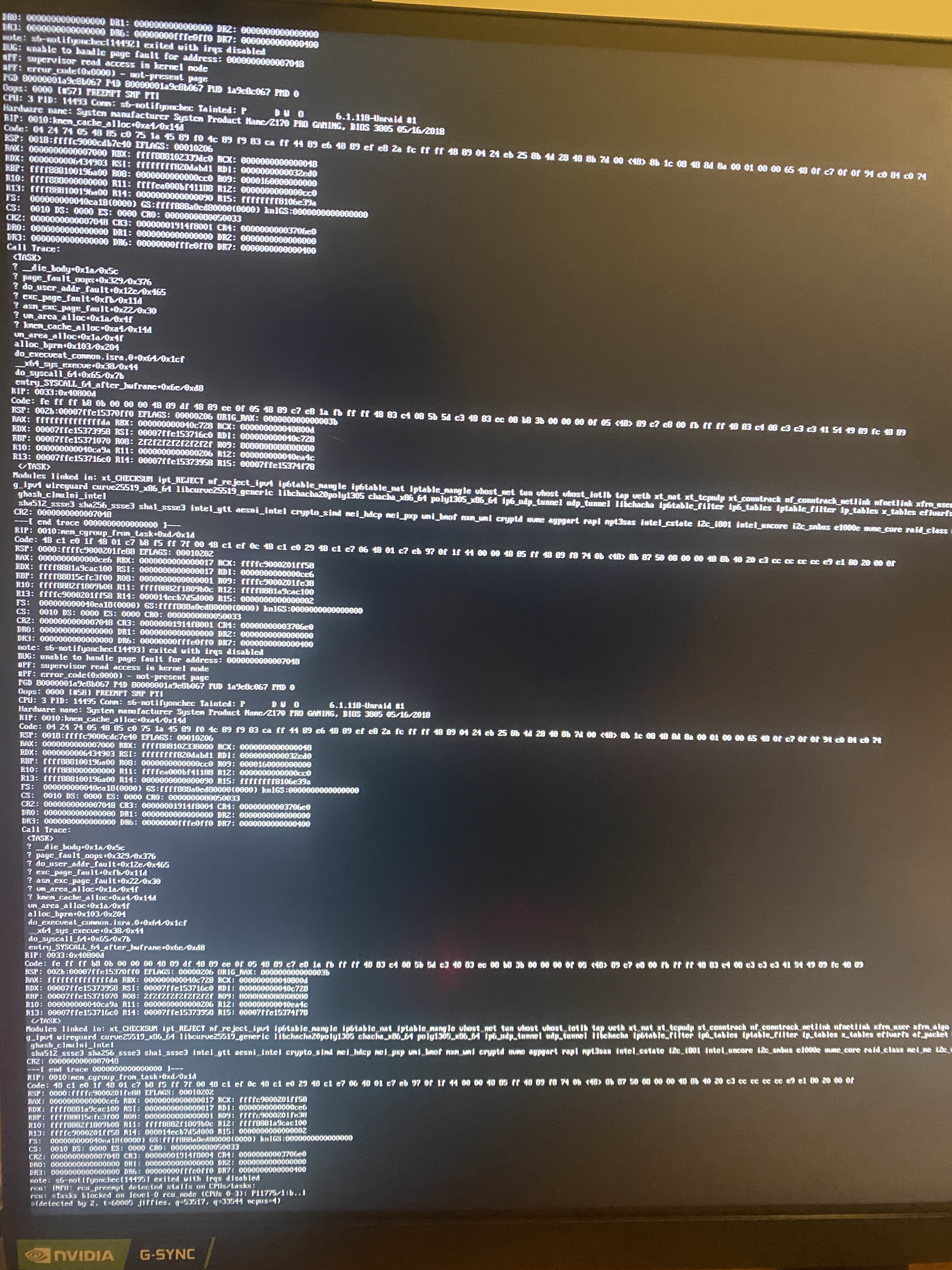

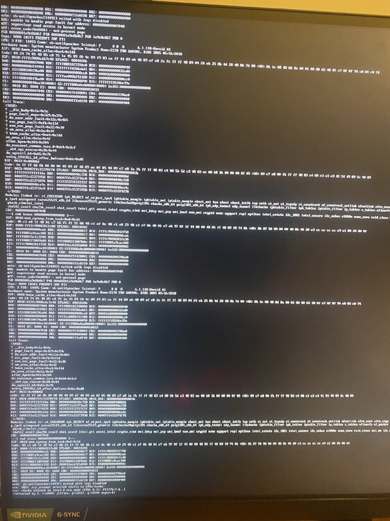

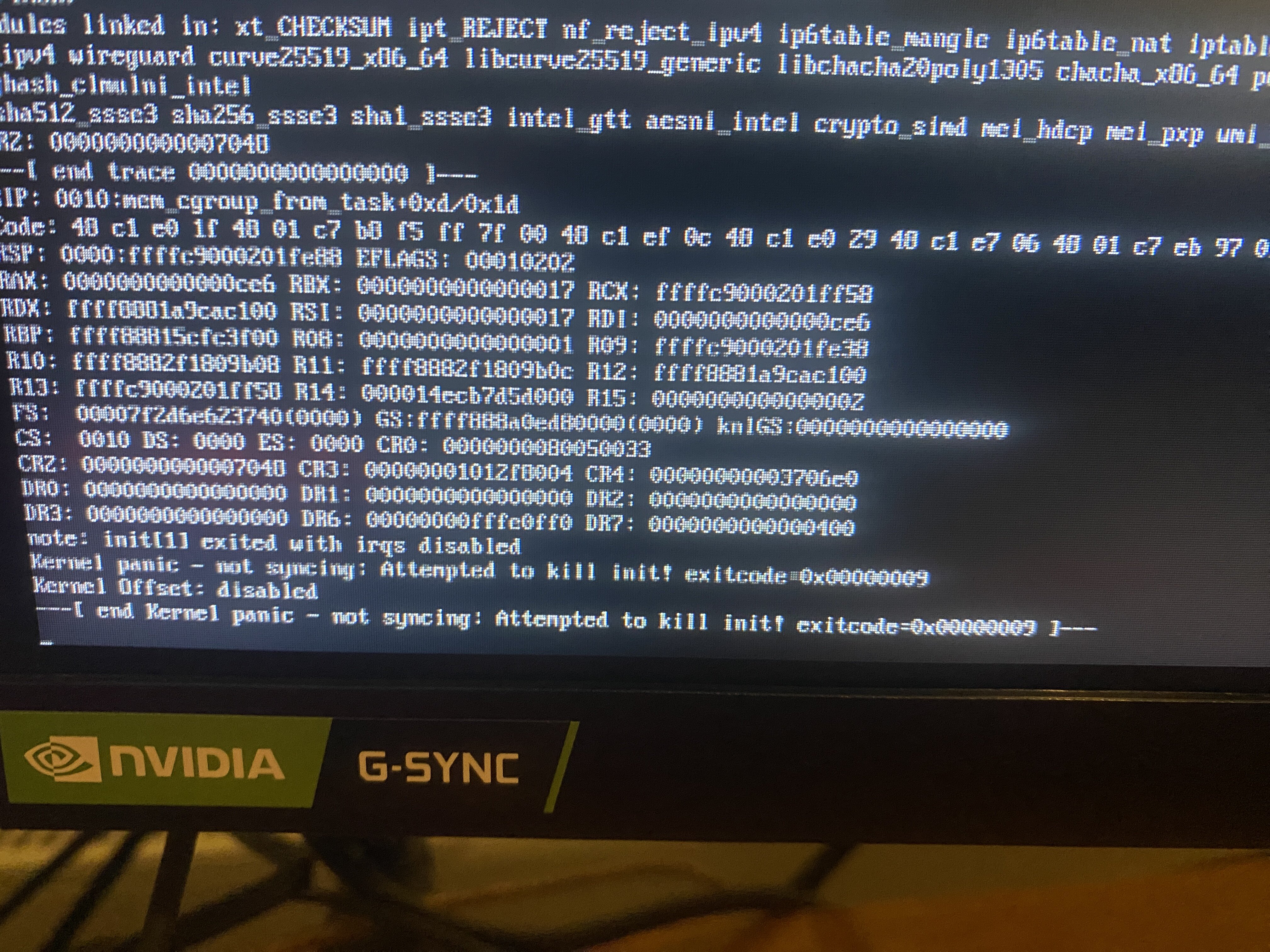

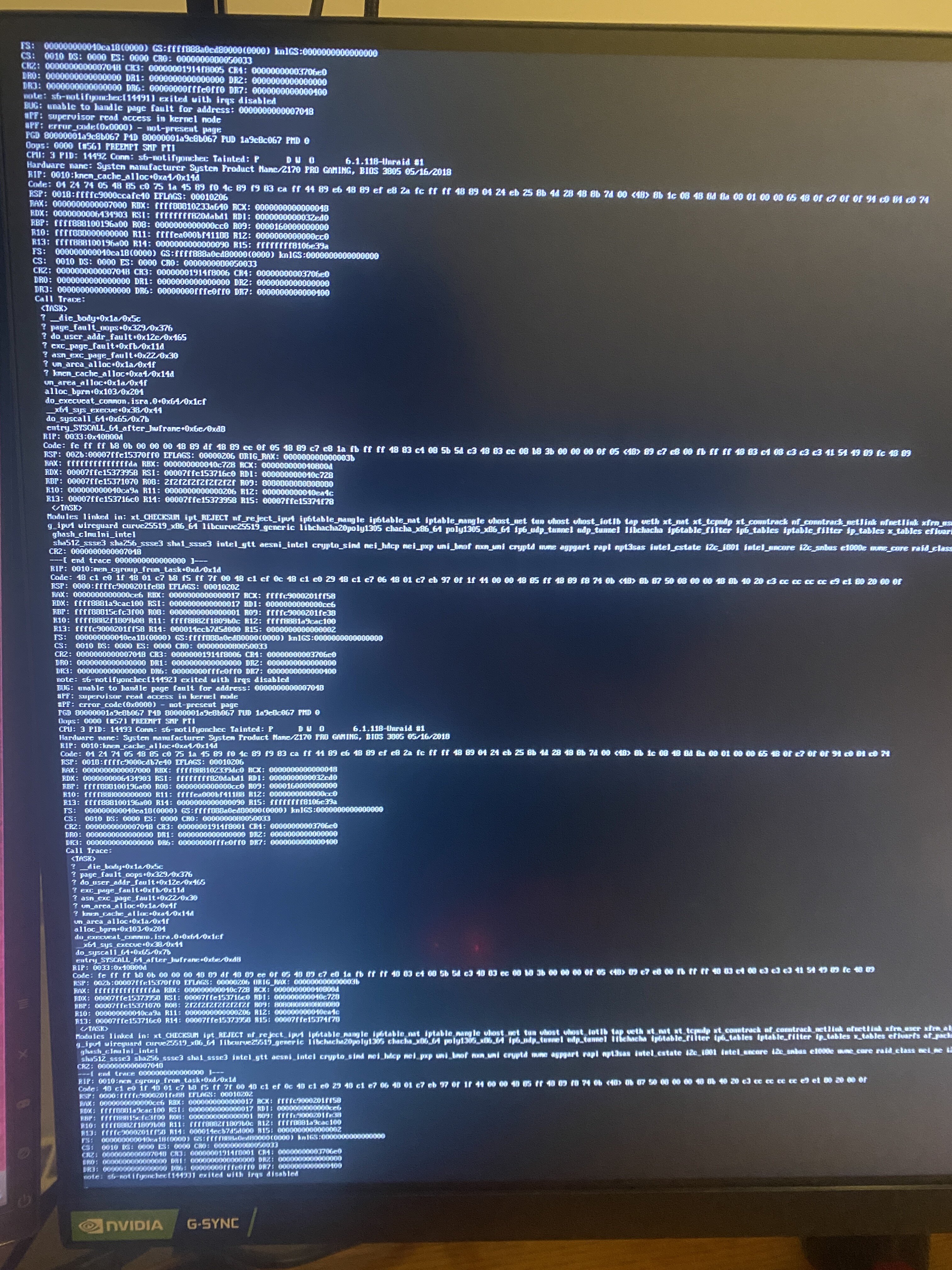

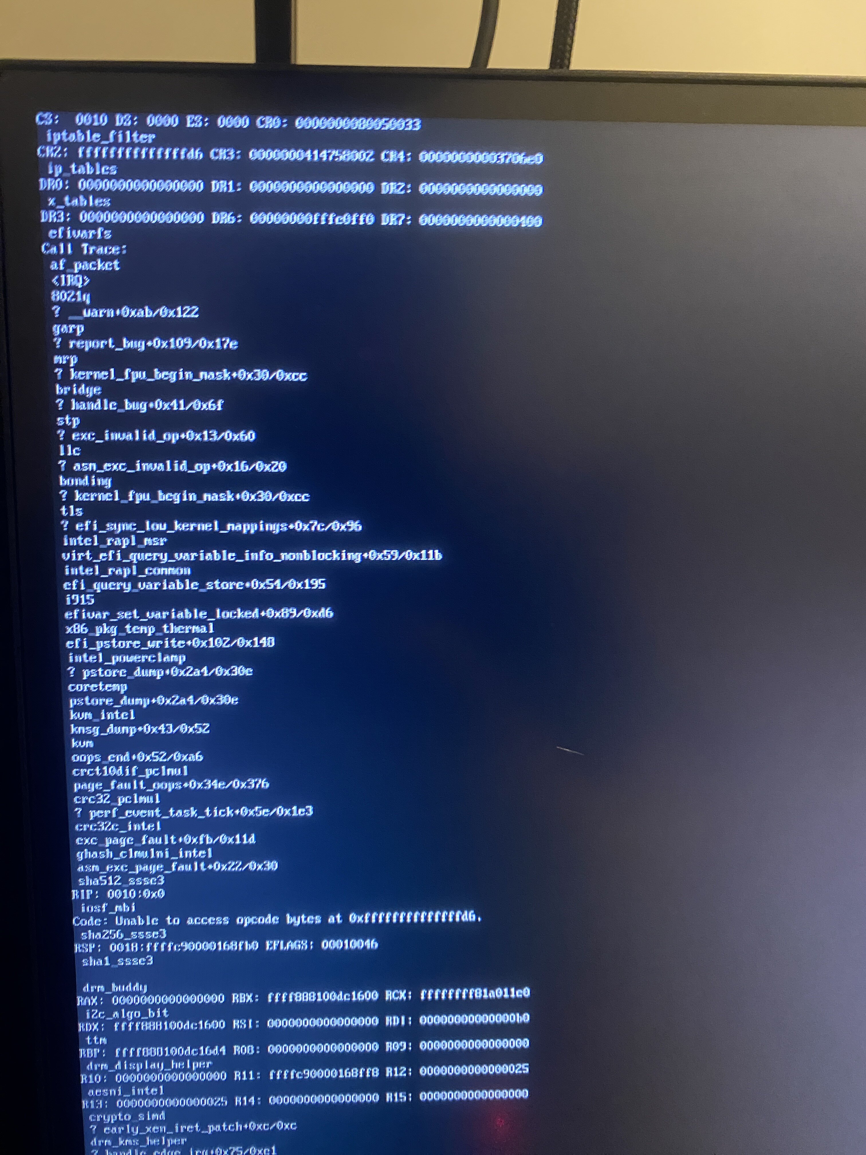

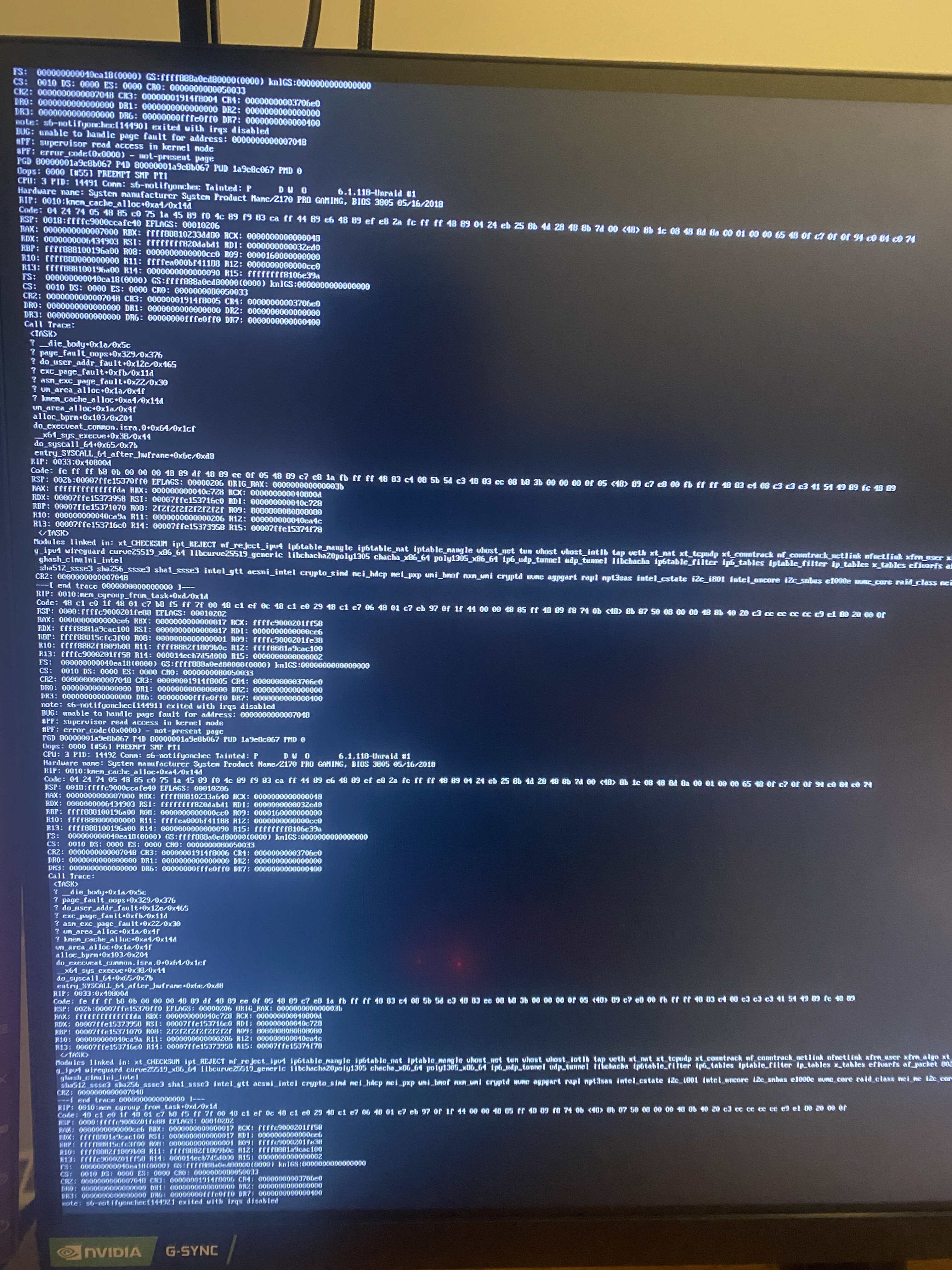

  9. The server boots up and goes down a few minutes later with these screenshots form the console. I couldn't find anything searching. Is anyone familiar with this?

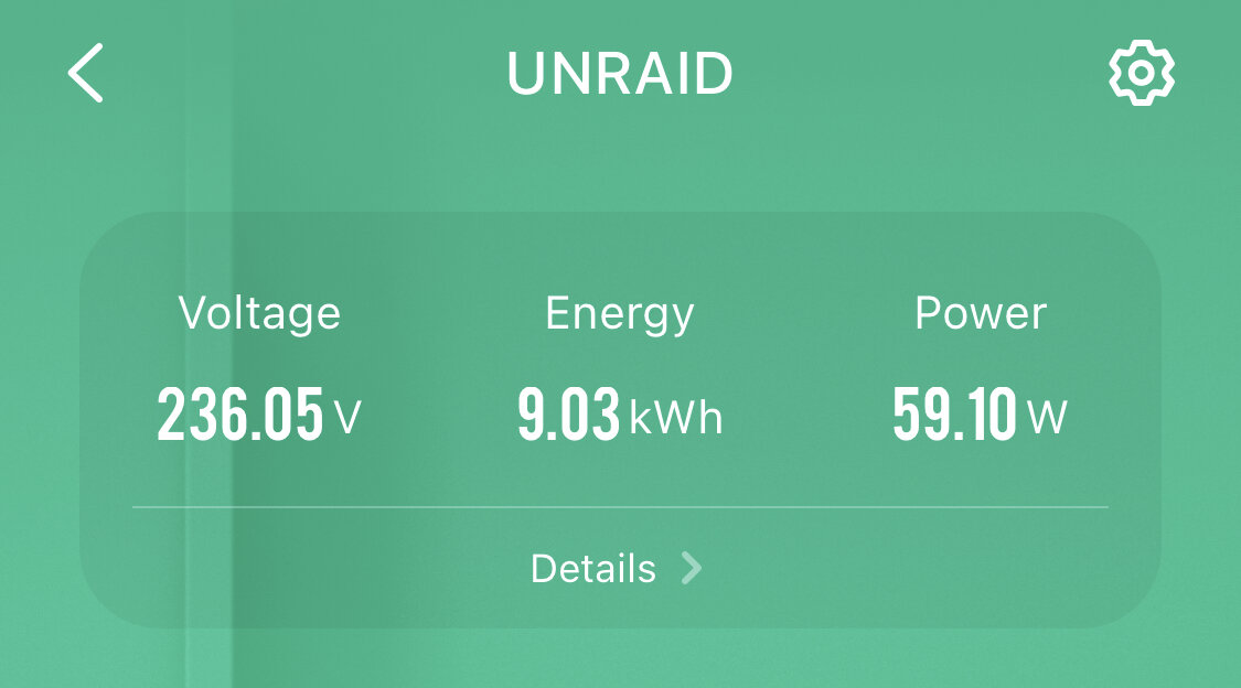

  10. Hi I'm running Unraid 6.12.10 I have a APC Smart-UPS 750 FW Link Here For my statistics I see my system showing usage of W "Real Power" as 25W Then I see the VA "Apparent Power" usage at 60VA. I have a smart plug energy monitor in the outlet which only monitors the UPS, and that shows that the total use of power is around 60 Watts My question is, is there something wrong with my system? Is it normal for the VA to be 3-4 times the W in the UPS statistics? My system is a i5 6600k MSI mobo 32 gb ram 4 18tb drives - 2 spun down 2 SSDs 1 NVMe I've also attached a photo of the UPS page in Unraid and what my outlet is reporting
