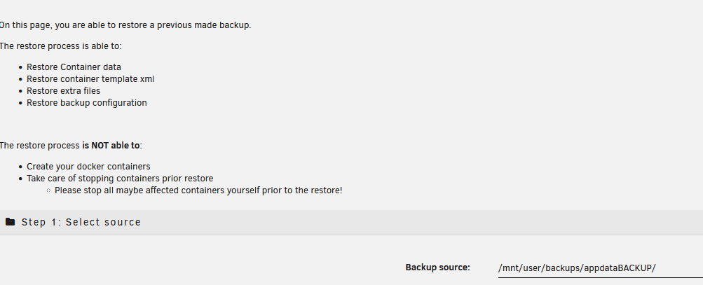

  5. found it: backup destination was not the same: dunno why i i put it in appdatabackup. How can i show thoses folders/files on the explorer when accessing the server remotely ? should i restore it like this (i don't care about unchecked apps) ?: also what does it mean to restore container ? because you need to install the app after that right ?

  7. hi can anyone help me ? following this thread:https://forums.unraid.net/topic/191384-unraid-working-strangely-lately-boots-randomly-and-now-parity-and-disk-1-missing/ i'm trying to recover my appdata, so i can recover the config of my dockers. long story short, original ssd cache (where appdata and dockers where stored) broke, replaced it, and forgot to copy the appdata to array before giving the broken ssd to the company for repair.... now i'm trying to recover it with appdata backup but there are several things i dont get it. you need to install previous installed apps beforehand ? when i do so, the apps are not installed completely. by that i mean (so far what i found): the configuration i had is gone I do have my plex library, but the media files are not accessible custom network is gone ip adresses are not set also do you need to install previous apps before doing the restore via appdatabackup ? maybe i got it wrong but i believed that appdata was where you stored the config files of the dockers and that's what i wanted to backup. also, if i set appdata share to visible, it doesnt show anything when i search it remotely via windows10. thanks and take care
  8. when installing apps it says : docker run -d --name='jellyfin' --net='bridge' --pids-limit 2048 -e TZ="Europe/Paris" -e HOST_OS="Unraid" -e HOST_HOSTNAME="TomiServer" -e HOST_CONTAINERNAME="jellyfin" -e 'JELLYFIN_PublishedServerUrl'='192.168.0.5' -e 'PUID'='99' -e 'PGID'='100' -e 'UMASK'='022' -l net.unraid.docker.managed=dockerman -l net.unraid.docker.webui='http://[IP]:[PORT:8096]' -l net.unraid.docker.icon=' -p '8096:8096/tcp' -p '8920:8920/tcp' -p '7359:7359/udp' -p '1900:1900/udp' -v '/mnt/user/tomiserver/Media/Tv Shows/':'/data/tvshows':'rw' -v '/mnt/user/tomiserver/Media/Movies/':'/data/movies':'rw' -v '/mnt/user/appdata/jellyfin':'/config':'rw' 'lscr.io/linuxserver/jellyfin:latest' c408d2aadc667e688a31bdbe25f019e3474c1f4d62ce277236c2485ea239f62f docker: Error response from daemon: error while creating mount source path '/mnt/user/appdata/jellyfin': mkdir /mnt/user/appdata/jellyfin: no medium found. The command failed. what should i do ? I'll leave this here if someone is insterested. i had to format the new ssd into btrfs format. Now i don't have any error message. Unfortunately, i cannot restore appdata. i also don't understand it. It does restore for example plex library, but you don't have the access to the library files into the plex app... also networking config disapeared somehow. very strange, like it restored only a part of it. Also don't get it why you have to install apps if when you restore via appdatabackup the app says restore container. I'm might be too noob to understand it. thanks a lot anyway.
  9. sorry to annoy you with this, but should i install the dockers before doing the restore data ?
