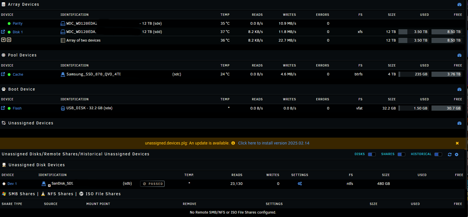

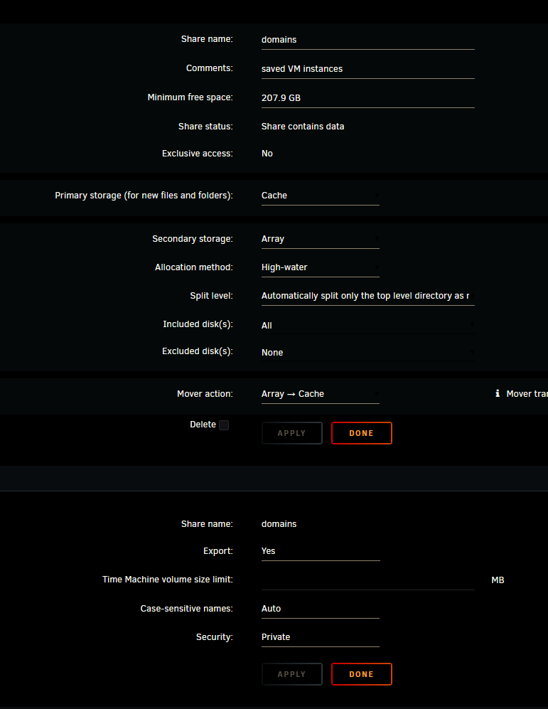

  1. Reporting back. I was able to find and see how the system share had docker and libvirt.img on both the cache and the array. I stopped the VM's, dockers, turned it off in settings, manually ran the mover, and then re-enabled VM's/docker, started them back up, and now the system and domains are only on the Cache, everything works as it did before (no data or functionality loss). All seemingly worked without issue and fixed my problem. Thank you itimpi! Side note: USB manager wouldn't let me shut down HAOS VM (it kept immediately restarting it), so I just unplugged my zigbee and z-wave dongles and then I was able to shut it down in unraid.

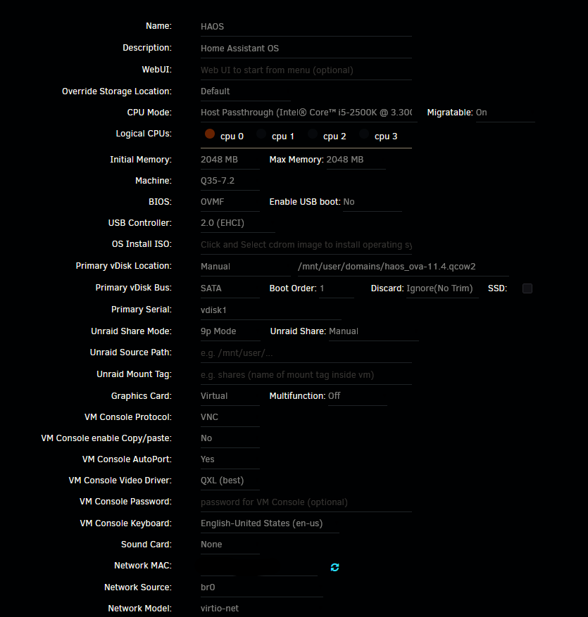

  4. Hi - I'm rather new to this and trying to fumble my way through. I've decided my HAOS VM is most likely preventing my storage drives from spinning down. I purchased a 4TB SSD and am using it as a cache drive. My thought was I could put the HAOS VM on the cache drive so it's persistently active state wouldn't keep my drives spinning. However, it does not seem to have fixed the problem and I'm trying to troubleshoot. A few questions: 1. Does anyone know if this logic is solid? It should just utilize the cache if done right and leave the spinning disks idle right? Would the cache being pinged spin up the storage drives for some reason (and can I stop that)?. 2. Why I think HAOS VM is the problem: When I shut down the VM my drives do seem to behave appropriate and spin down based on the settings I've chosen. When the VM is active the drives never spin down (going on 1yr of no spin down now :(). 3. Did I actually move the HAOS VM to the Cache properly? I feel like I messed this up and must be doing something wrong here as I am a noob. Thanks in advance, I appreciate any help as I've been working on this but just don't have as much time as I used to to figure this stuff out. Setup is below but 1 4tb cache ssd, 1 12tb storage, 1 12tb parity.
