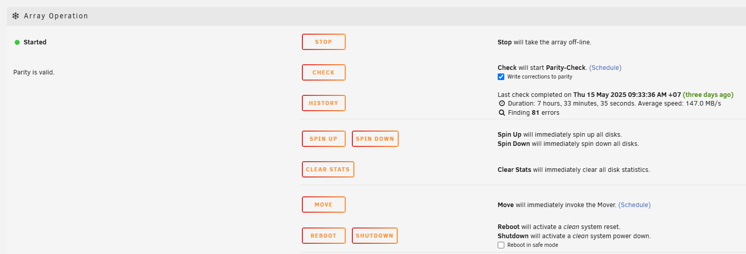

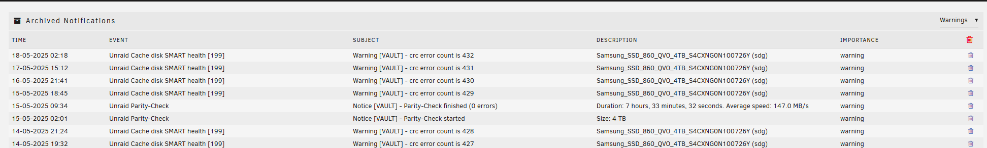

  1. Hi, today I fouind out that I have 81 errors displayed in the Array Operation like so: But when I checked the warning notification, it said Parity-Check finished with 0 errors. So I went ahead and checked the System Log during that check, and there are 81 sectors marked incorrect. Does the '0 errors' in the warning means the errors are solved, or do I need to do anything else? The log is attached, thanks in advance. syslog.txt
