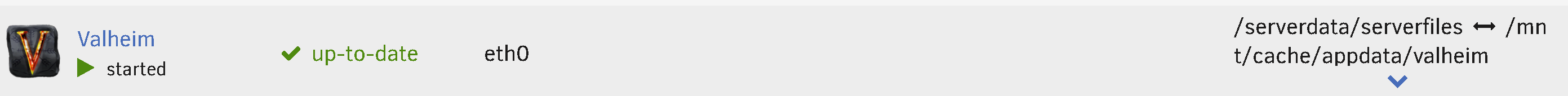

  5. Hi, I installed the Valheim server using macvlan custom eth0: (192.168.50.18) , but unlike my other docker containers on custom et0, this one doesn't show anything, is there anything that needs to happen before IP is shown ? I went to the console and installed net-tools and it seems the IP is valid root@f282f8f29240:/# ifconfig eth0: flags=4163<UP,BROADCAST,RUNNING,MULTICAST> mtu 1500 inet 192.168.50.18 netmask 255.255.255.0 broadcast 192.168.50.255 ether 02:42:c0:a8:32:12 txqueuelen 0 (Ethernet) RX packets 6671 bytes 10280494 (9.8 MiB) RX errors 0 dropped 0 overruns 0 frame 0 TX packets 1842 bytes 215092 (210.0 KiB) TX errors 0 dropped 0 overruns 0 carrier 0 collisions 0 The reason I need custom et0: is because I am behind CGNAT and use Wireguard to port forward to IP:Port I have this kind of setup working correctly with Plex, so I was going to use the same kind of method with Valheim server. Edit: So I it looks like Valheim Server is indeed running and I can connect to it from Steam from another PC in Lan, and I also transferred my World Data files to it and it loads fine. But it's a bit odd that the IP/Port does not show up in the docker dashboard. The real issue is that I can't see the Valheim Server from the outside, https://portchecker.co/ also fails to see the ports being open (works on Plex), I have made sure for my VPN to allow those ports (2456-2458) to be forwarded and the router is configured correctly to listen on wgclient to forward those ports to the Valheim docker IP. But I feel like something is off in the docker container when used with Custom eth0: because when I go the docker allocations I see this: Valheim eth0 192.168.50.18 ???? <-- for ports
  6. Thanks @trurl , I went ahead and changed everything per that document... using custom eth0: now
