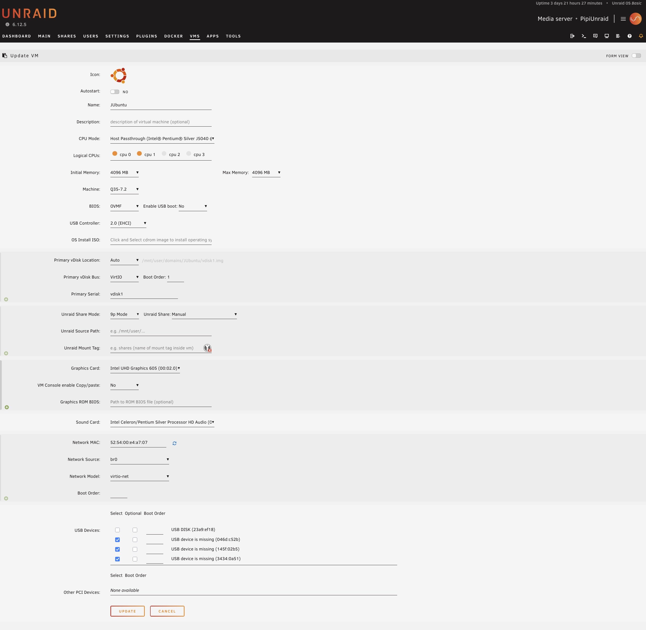

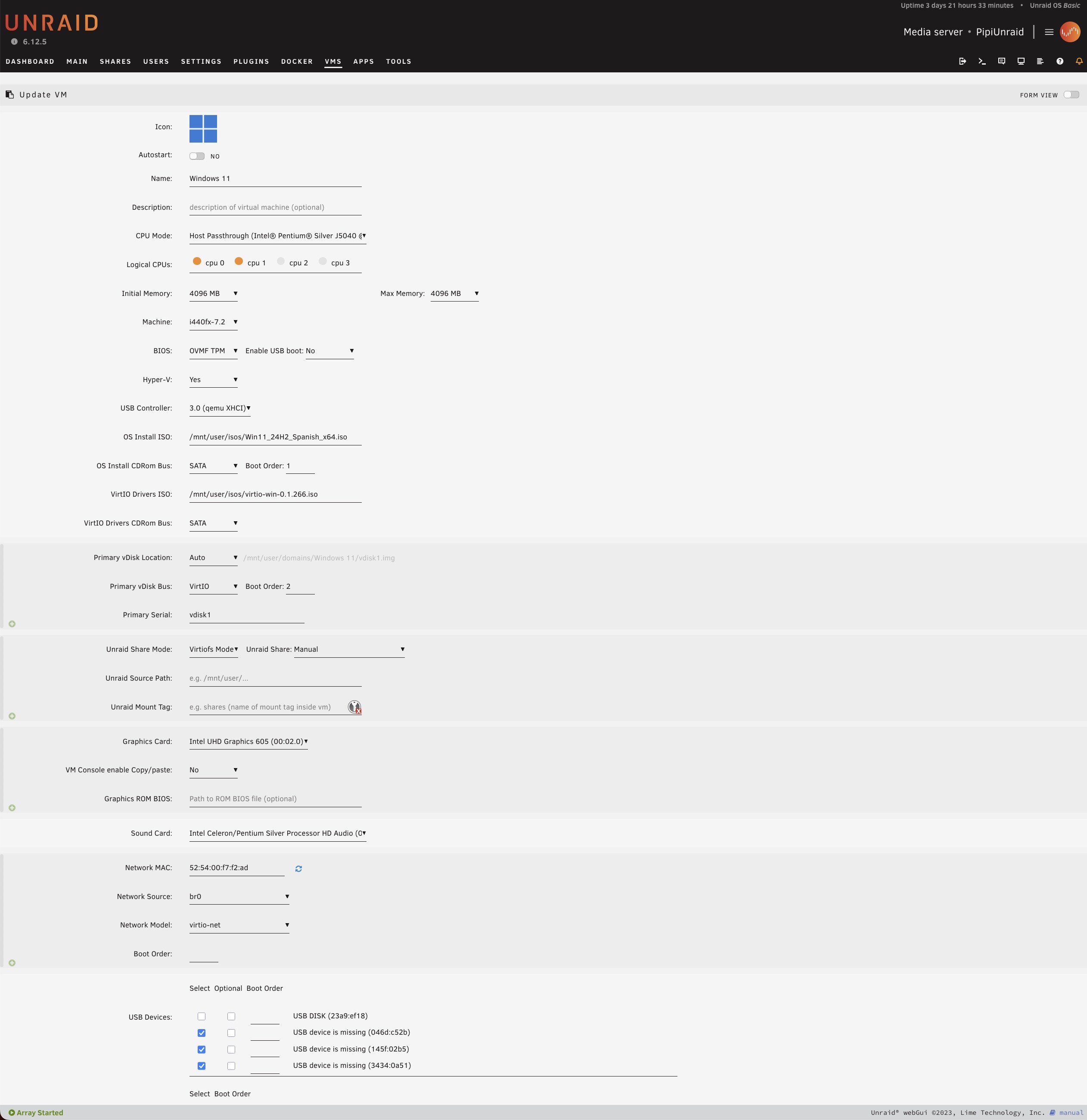

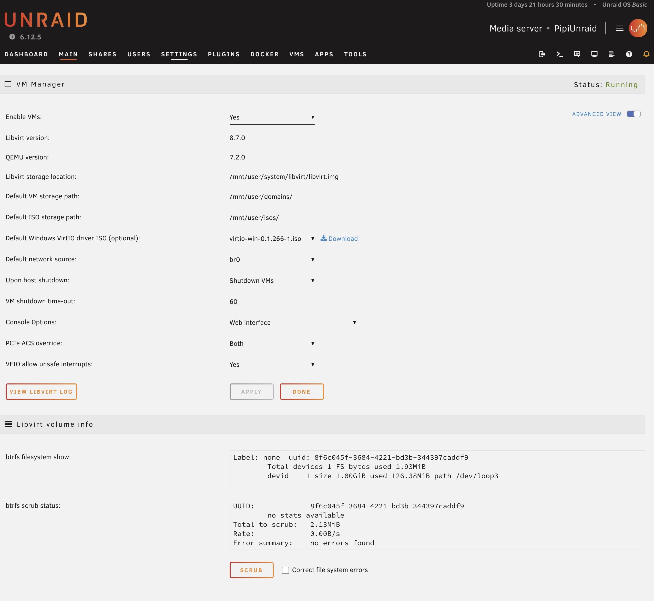

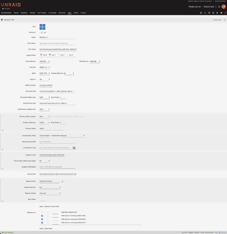

  3. I've created several VMs on my Unraid machine (based on a modest ASRock J5040-ITX) and they seem to work fine if I run them through VNC or Spice. But I've got my server next to a TV on my dining room and I'd like to be able to connect it to that TV through HDMI and then control it with a wireless keyboard and mouse. I've tried Ubuntu and Fedora VMs and the run fine and show video without problems, but there's no sound even if the "dummy output" shows volume going up and down while playing a video in YouTube, for example. I've enabled the integrated sound card but nothing. I restart pulseaudio and confirm that the hardware is detected, but the hardware device detected is the S/PDIF one, not the analog output, and even trying to run alsamixer and changing levels there does nothing. The hardware and the support seems to be there, but I get no sound at all. I've tried with Windows 10/11 but the problem there is even worse: there's no video output when I connect my unraid machine to the TV (I'm using the latest version -0.1.266-1- of the virtio drivers). Nothing. I've tried to check VM Manager in settings, but I can't get this to work and it would be great to have video and audio working through HDMI. Any ideas?

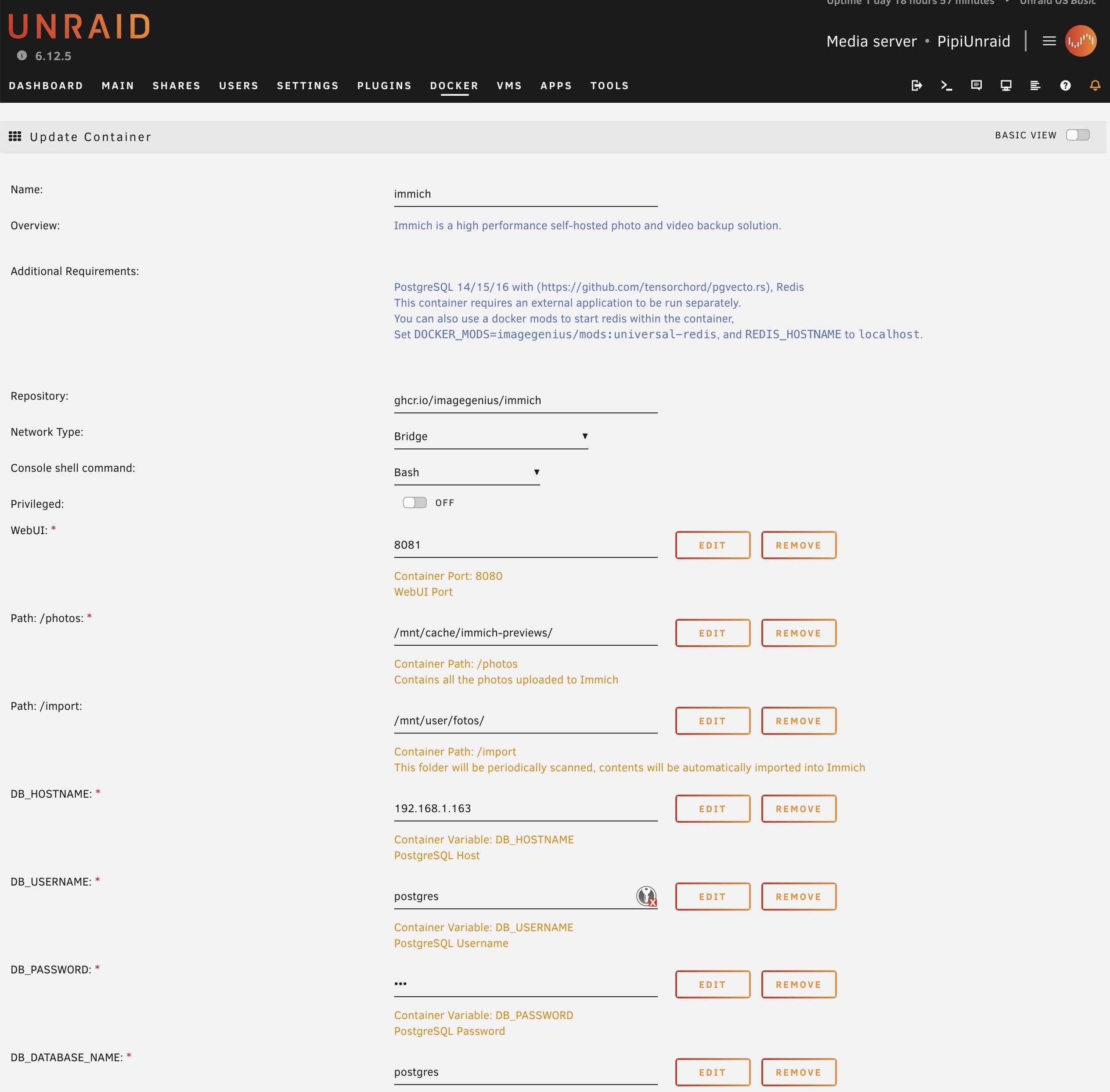

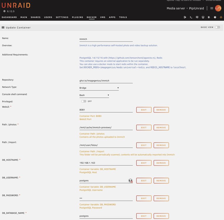

  4. I have the same problem, but I'd like to do that so if I'm using an external library, how to use an internal one? I've got a pretty big library, over 150K pictures and around 10k videos, 1.5TB in size overall. As you can see on the container configuration, i've got /photos -> /mnt/cache/immich-previews (internal library, I guess, but this is 195GB in size and is full of thumbnails) /import -> /mnt/user/fotos (external library with my folder organization untouched, I do create forlders as albums there from my own sanity as I sync/uploads pictures and videos to manage them). Is this somekind of permissions problem? A 'ls -la' shows as follows on these directories: drwxr-xr-x 7206 javipas users 7208 May 2 08:30 fotos/ drwxrwxrwx 6 nobody users 6 Feb 10 09:08 immich-previews/ Thanks!

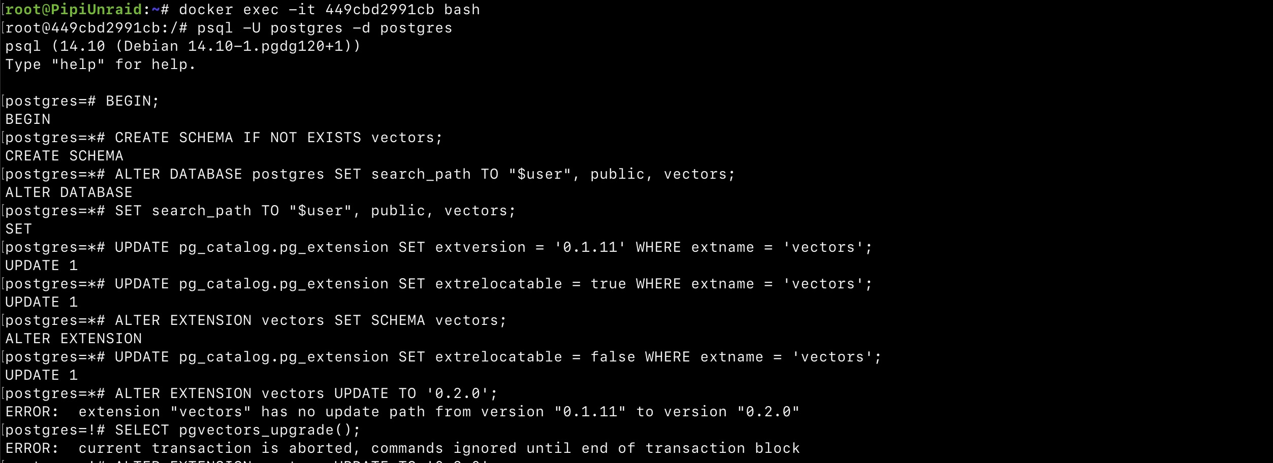

  5. Sorry, I didn't see this. I tried the commands and got an error, so after that I just closed the terminal, changed the repository in the Postgres docker config and restarted it. After that, it worked fine. Don't ask me why 😛
  6. Sorry, I fixed it. After trying your method I just edited the Postgres14 container to change the Repository parameter and put "0.2.0" instead of the 0.1.11 I had before. After restarting both containers (Immich and Postgres) the thing works. Yay! Thank you!
  7. Thanks. I've tried, but somehow the ALTER EXTENSION vectors UPDATE TO '0.2.0'; fails It shows the message: ERROR: extension "vectors" has no update path from version "0.1.11" to version "0.2.0" So I'm again stuck.
  8. Today I saw there was an update available for immich. I installed it from the Apps (ghcr.io/imagegenius/immich) with Postgres14 and Redis and everything was working fine (around 150K photos/videos already indexed), but after the update, who seemed to go well, Immich no longer starts up. The log shows this message: The pgvecto.rs extension version is 0.1.11, but Immich only supports 0.2.0 and later minor releases. And this is consistent with the v1.95 release notes. The problem is, I have installed it through Apps (not following the Unraid howto published on their site) and I don't know how to fix this. Can someone help?
