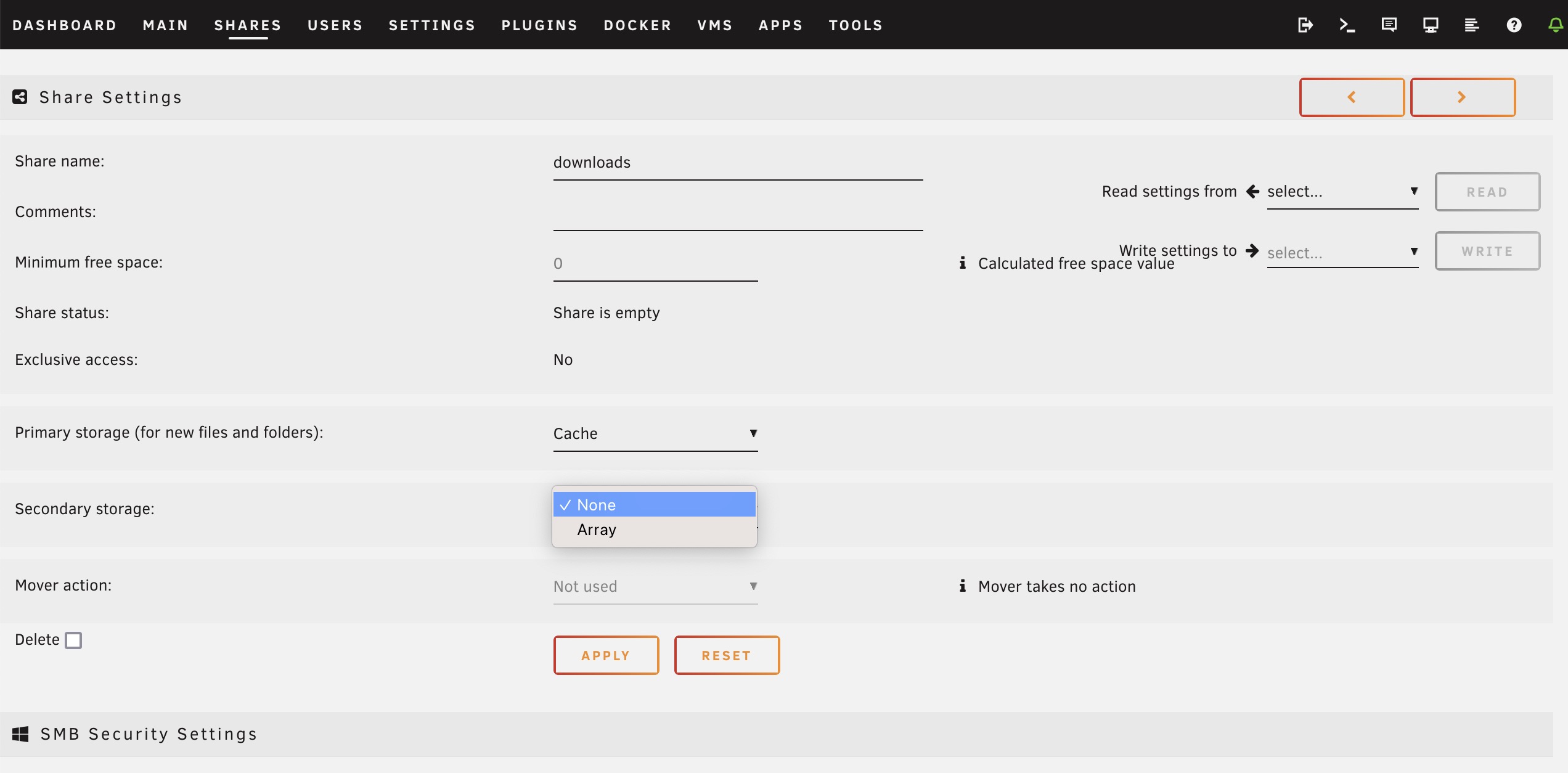

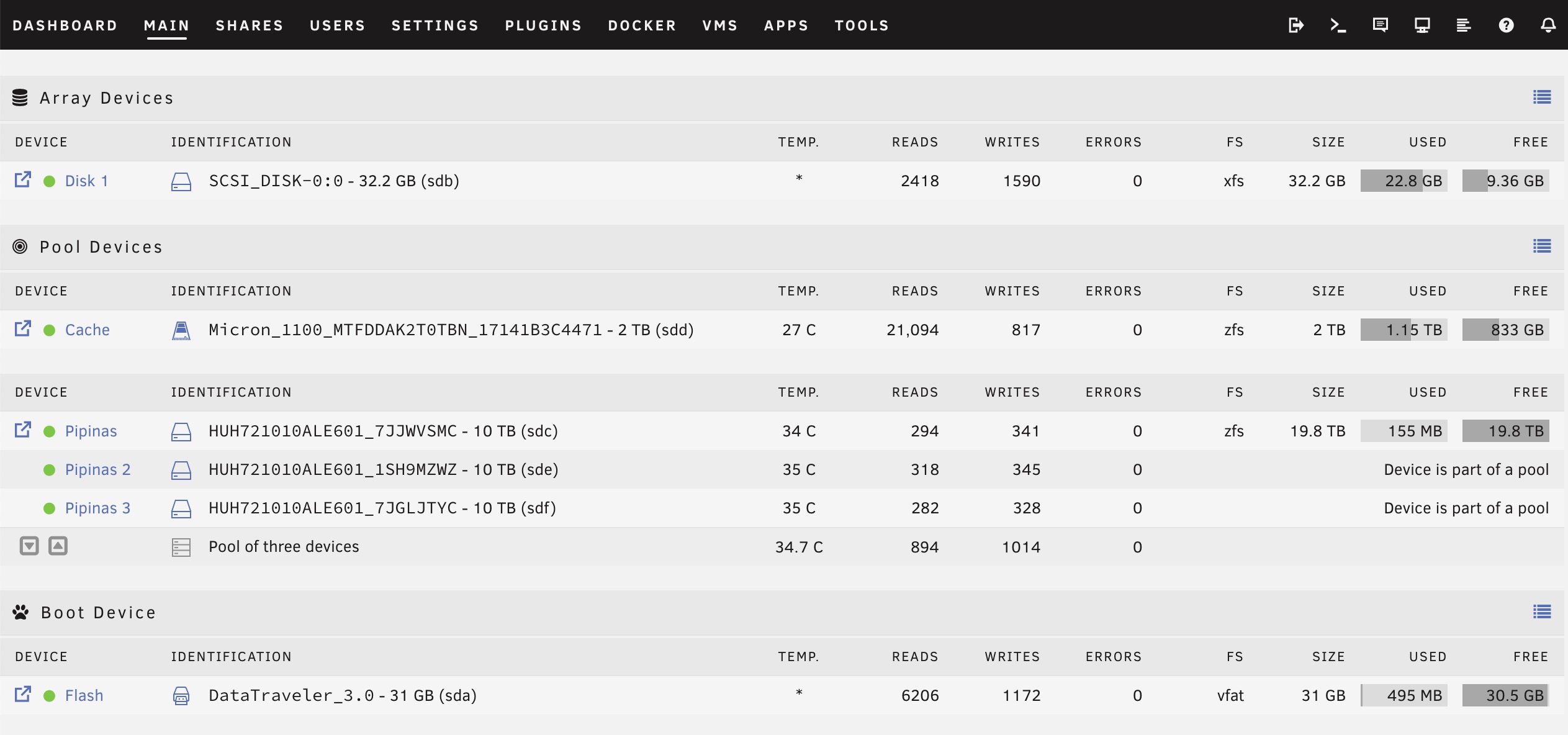

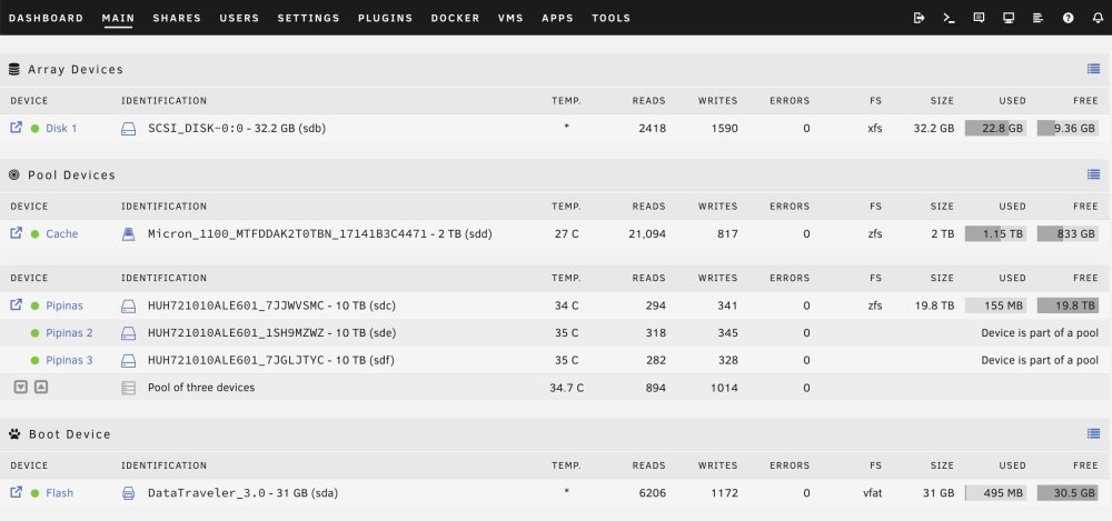

Hi I'm trying to understand the new shares and cache behaviour in Unraid 6.12.x. This reddit post and the corresponding video are quite useful and I thought it was clear enough for me but I'm trying to make just some tests on my brand new Unraid system and I'm confused. On my system I've got (see image): 1. Array -> A 32GB USB drive that is there just because I wanted to configure my HDDs as a RAIDz1 array. 2. Cache -> A 2 TB SATA SSD that I want to use for docker, VMs and some frequently accessed files 3. Pipinas -> The storage pool with three 10TB HDDs configured in RAIDz1, so 20TB available and 1 drive fault tolerant. I just wanted to create a new share called 'downloads' that uses cache as primary storage but the Pipinas (the RAIDz1 ZFS pool) as secondary, and then mover could move the data from cache to the pool when needed. It only shows the 'Array' as option, but 'Pipinas' isn't there (see image). So I can't never select my Pipinas RAIDz1 array as secondary storage, and I don't really understand why. Can somebody explain me this? Thank you

Thanks (¿Gracias? Por tu nombre pareces español ) Yes, I've done that and the new pool seems to be exactly what I was looking for. There's not much details about that: it shows that the pool with three 10TB drives has an available storage of 19.8TB, zfs filesystem and three drives, so I guess it's running with RAIDz1 as I wanted.
