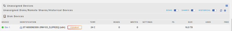

  6. Ok screen-shot should be attached, but where do I find the 'Preclear page'?
  7. Trying to pre-clear a brand-new disk and the red X does not appear alongside the serial number. There is a 'format' box. I downloaded the Unassigned Device + addon and enabled destructive mode but that didn't have any effect. Server is running 6.12.6. Thanks in advance for any help
