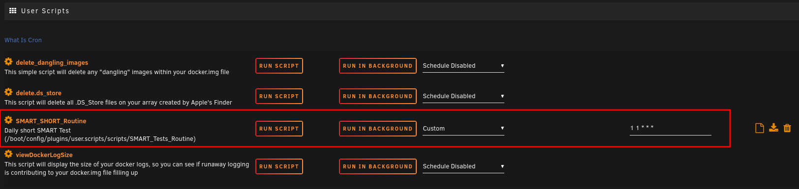

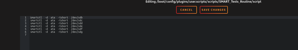

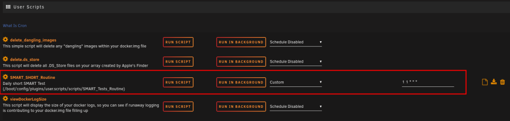

  5. Quick solution 17.01.2024: Since I have no script/programming skills but I really want this "safety net of SMART tests" for my array I looked around what I could achieve myself, this is what I found... And believe it or not it's working successfully 😉 Step 1: install "User Scripts" via the CA plugin/app store Step 2: go to the "User Scripts" plugin and set up a new script (please find screenshots attached) Step 3: find the correct /dev/sdX (X stands for the letter of your array HDD, look under "MAIN" in your Unraid GUI) of all your array HDDs you want to test and then paste commands in your new script you find in the second screenshot attached. As I have 6 HDDs in my array atm my letters run from b, c, d, e, f to g (parity HDD included) Step 4: save the script and let it test run in the background Step 5: check your logs. If everything went smoothly you can now add a cron schedule at which the script should run. For me (see screenhot 1) I run the script daily at 1 minute past 1 o'clock ( 01.01 am) The script only runs a daily SMART short selftest, for adding a weekly SMART long/extend test you can write "smartctl -d ata -tlong /dev/sdX" (X stands for the letter of your array HDD) Hope that was helpful for all of you with no scripting skills like myself and please feel free and comment this. Constructive criticism very welcome since I have no script/programming skills.

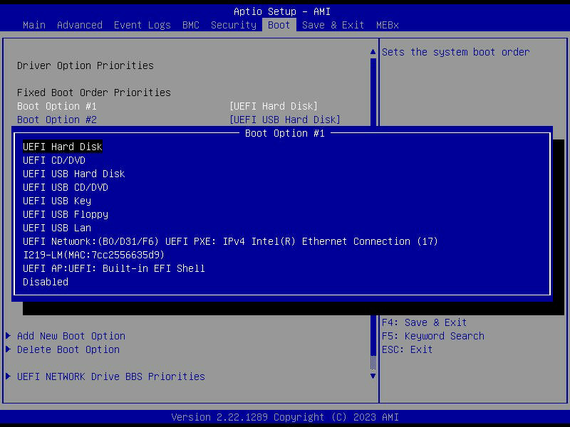

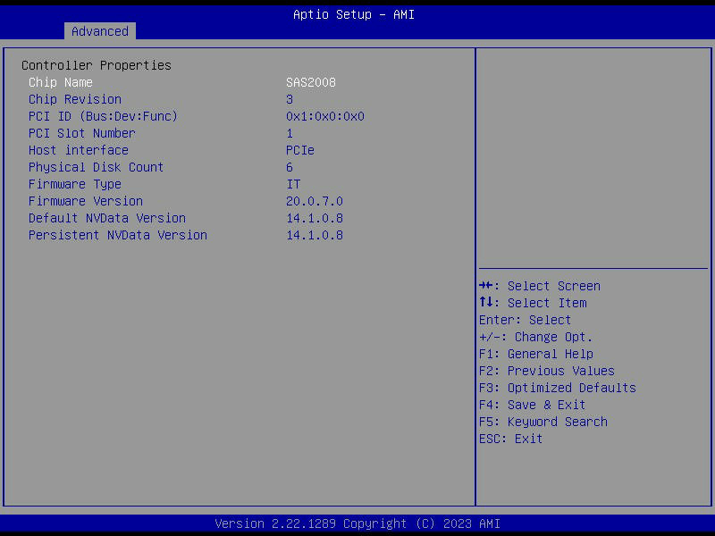

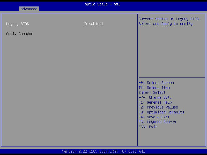

  13. Did all of this, even exchanged the controller for an LSI HBA 9201-8i (also flashed to IT mode)... everytime the same. No disks to be seen. The problem seems to be the BIOS setup of the SuperMicro X13SAE-F. Because it will only boot in UEFI mode (there's no setting to boot in legacy mode) it's not possible to hit "CTRL-C" in POST so you can't change controller settings. You can change the LSI controller settings when you're in the X13SAE-F BIOS settings, please see attached screenshots. So there it is possible to disable legacy boot but nothing changes. When being in the LSI BIOS via the X13SAE-F BIOS the controller sees all HDDs which are attached (screenshot below) BUT outside of the LSI BIOS so when you're back in the X13SAE-F BIOS you should e.g. be able to select the HDD you want which is attached to the controller. This is not the case because the X13SAE-F BIOS sees only "UEFI hard disk" but this is just generic and not one of the HDDs being attached to the controller. So: if the BIOS can't see the LSI controller attached HDDs I think neither Unraid nor Ubuntu etc. are able to see the HDDs later on. The card worked perfectly with TrueNAS for 4 years but the reason was (I think) that everything was legacy boot and not UEFI... Really don't know what do to tried every possible BIOS setup in the X13SAE-F and the controller cards BIOS but it just won't work. Perhaps anyone that has a X13SAE-F mobo can answer how the boot their machine with which settings. Thank you :-) not possible to select any HDD attached to LSI HBA inside the LSI HBA BIOS all 6 attached disks are seen inside LSI HBA BIOS I disabled legacy boot but that solved nothing...
