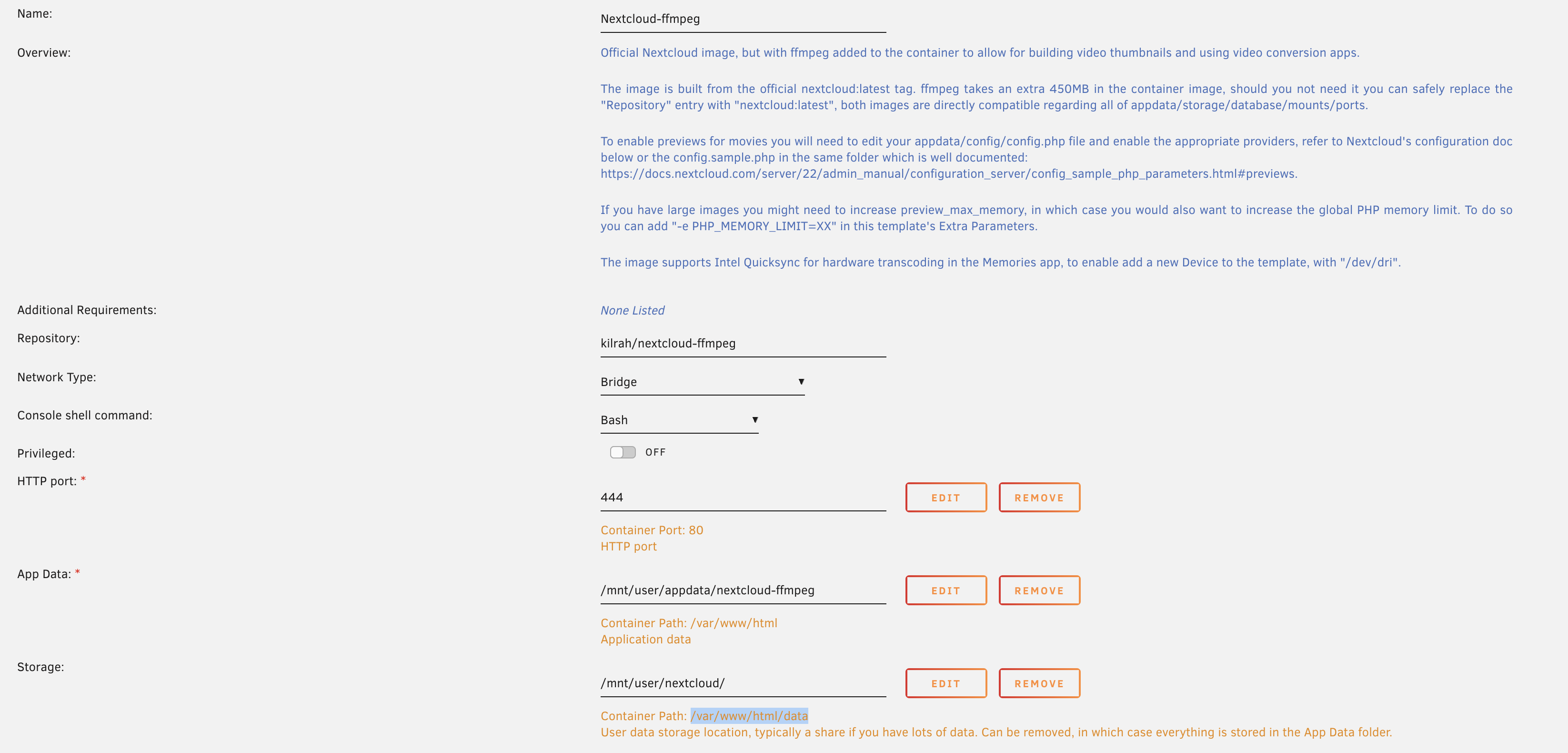

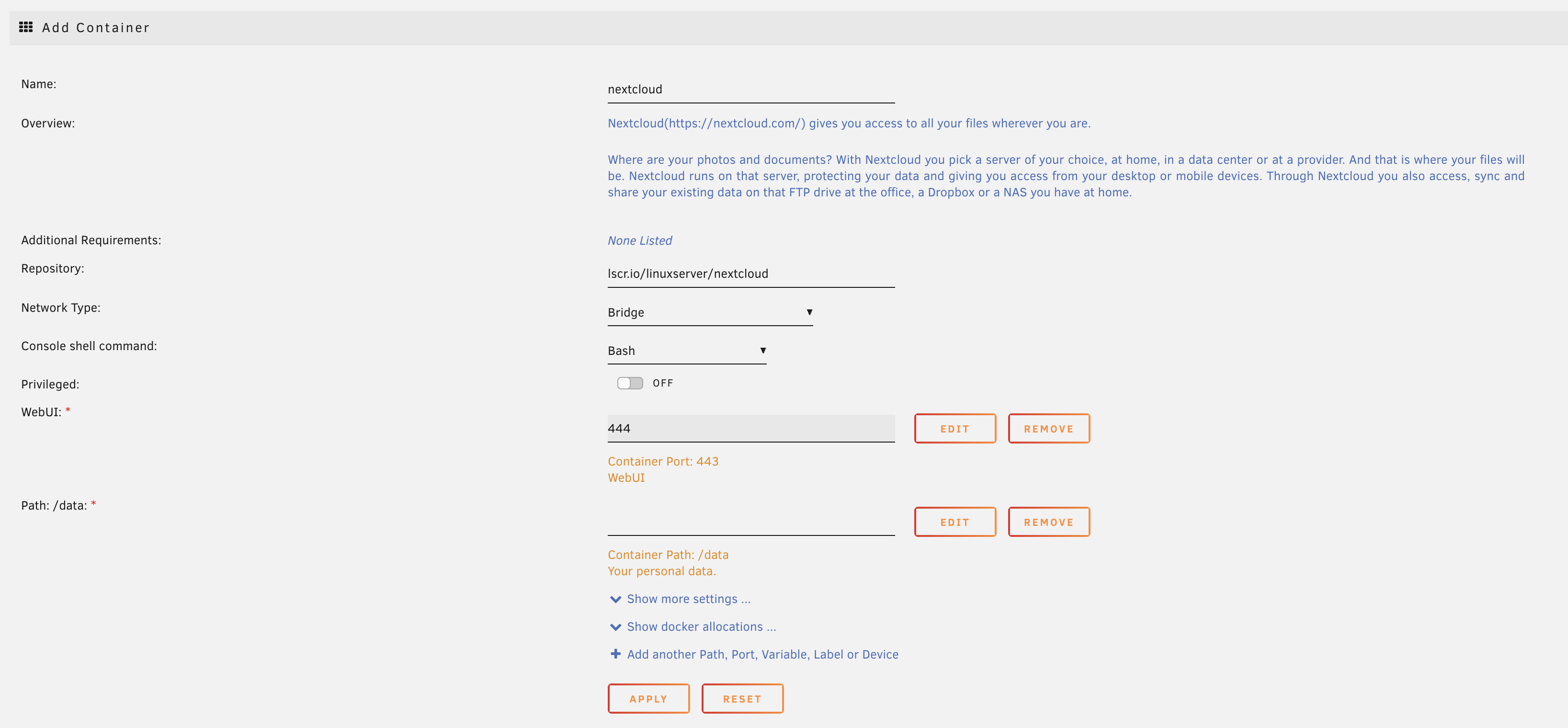

  14. Yeah. Looks like it is looking for a specific table and it is not finding it. "An exception occurred while executing a query: SQLSTATE[42S02]: Base table or view not found: 1146 Table 'nextcloud.oc_appconfig' doesn't exist" Any idea where nextcloud.oc_appconfig is expected to be present or defined ? Also, I'm not facing this issue when using the linuxserver respository. Weird that I followed the exact same steps and seeing this error only in this repo. Is this something within the mariadb container? I wonder if this has something to do with the /var directory being used. A couple of differences I noted between the linuxserver's container (which works) and this one is that: 1. When I opened the Nextcloud webUI for the first time and set up my admin credentials and mariadb info, the Data Folder provided was different. For the linuxserver repo it was just /data and for Kilrah's it was set to : /var/www/html/data 2. Also , in the container settings I see that there is an extra setting for "App data" present with container path set to "/var/www/html" and Storage has container path "/var/www/html/data". I did not touch the /var directory when working with linuxserver's repo, as far as I remember. Could this be something ? Sharing screenshots for comparison of container settings linuxserver: kilrah: No, I haven't done anything with redis. So looks like that's ruled out obviously, in light of the Database error above.
