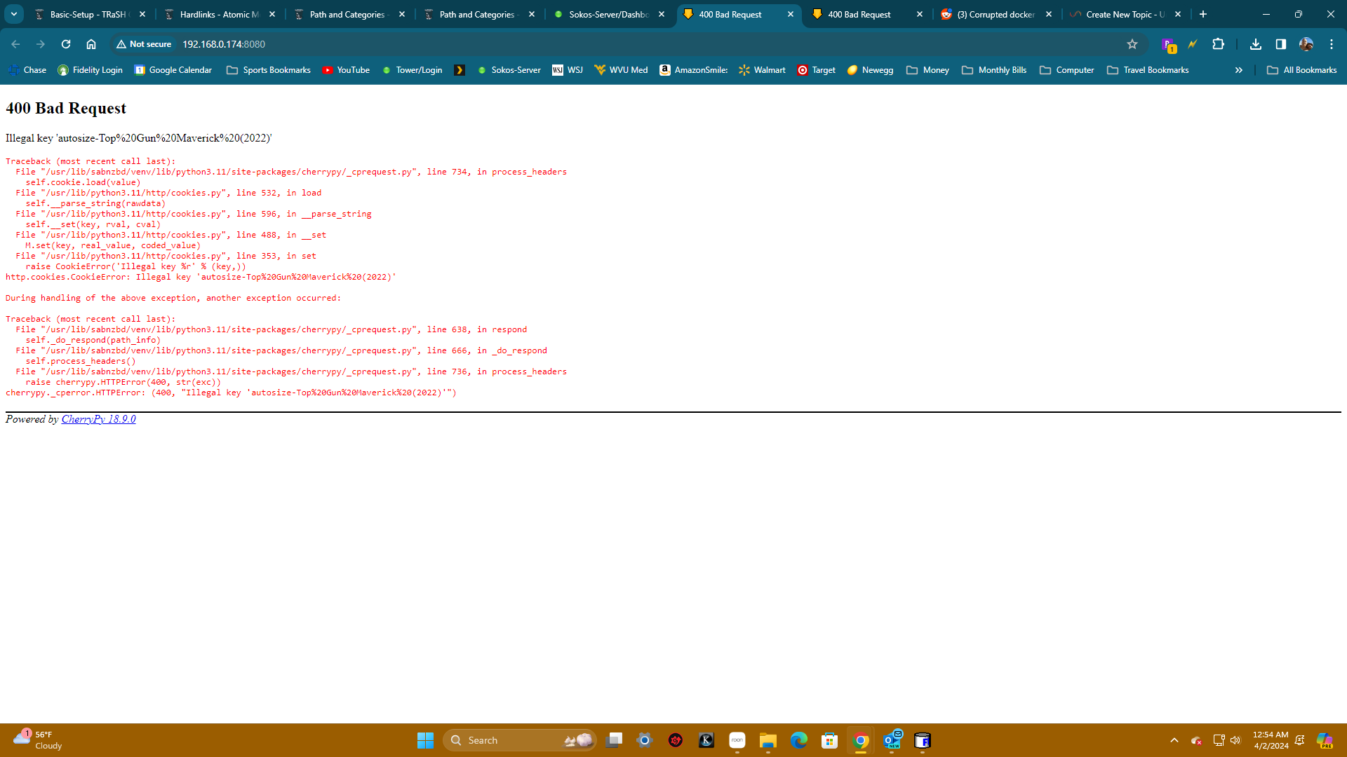

  10. I was doing fine until when I was transferring movie files from a external HDD to the media folder I noticed that the movies were being added as shares. All but three were empty and I was able to delete them. I then tried to reinstall the docker Sabnzbd which was pulled down and finished install ok but when I tried opening it it gave me a error 400 bad request with the error: llegal key 'autosize-Top%20Gun%20Maverick%20(2022)' I then looked in my appdata folder which contained about 6 folders of dockers I had uninstalled previously. I was able to delete half of them with Krusader but had to use midnight commander to delete the rest. Still had the error and I researched it and used midnight commander to delete the docker image file and on reboot it continued to give me this error. I would just do a complete reinstall of unraid but I have * TB of movie files downloaded. I downloaded my diagnostic report. My server is a Dell Precision 5810 with 128MB ECC RAM with a Xeon E5-2680v4 @2.40 GHZ. I have 1 10 TB as parity and two 10 TB for data and two 4TB SSD one for data and the second for my cache. Any help would be appreciated sokos-server-diagnostics-20240402-0044.zip
