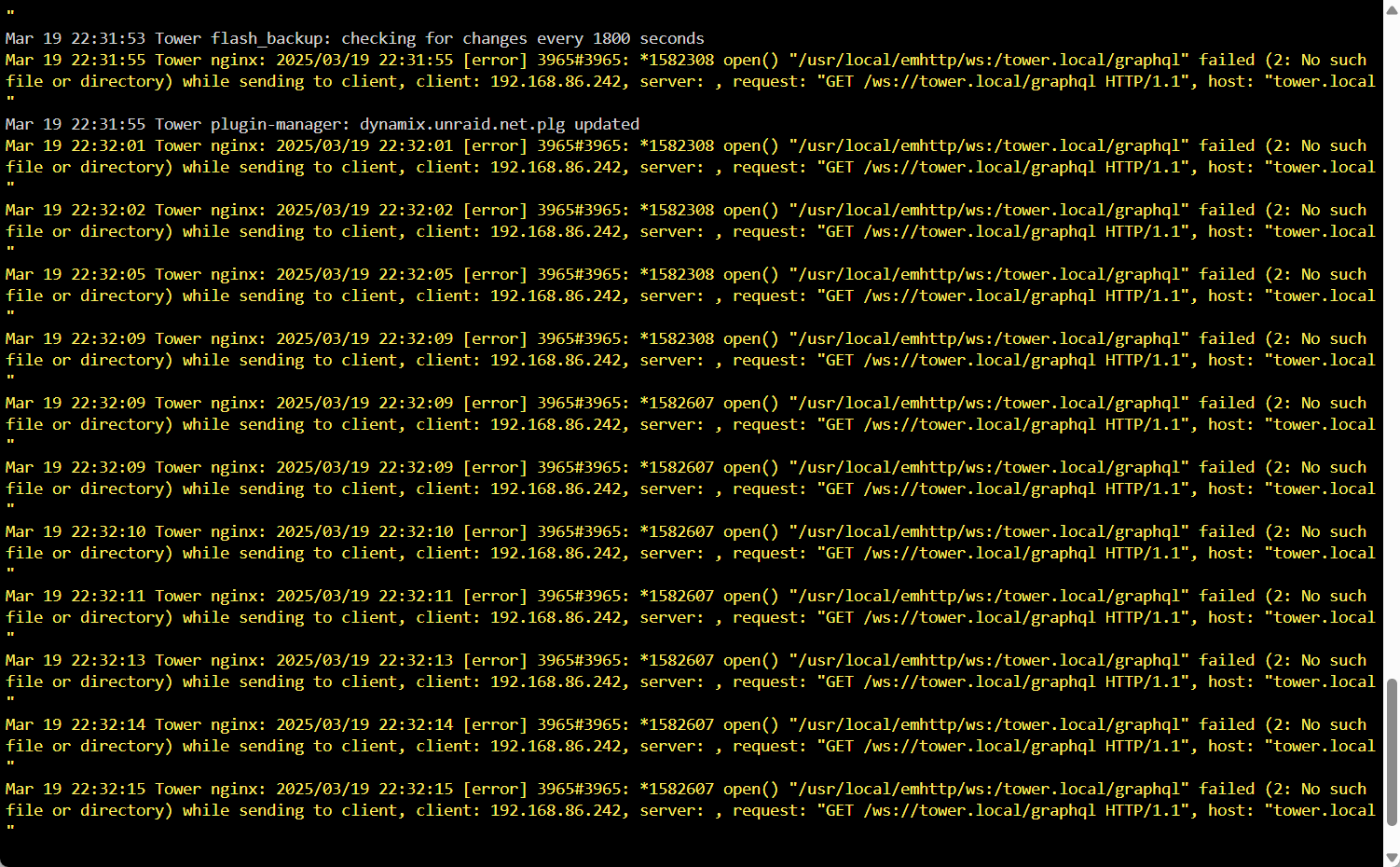

  1. The issue seems to occur when I access the WebGUI from my iPhone. I have stopped accessing from my phone and the error/warnings have stopped.
  2. There is a warning in my system log that keeps populating. I have tried to find resources on how to correct this warning but so far I have not found a solution. If anyone could review and assist me with how to resolve this warning, I would greatly appreciate it! tower-diagnostics-20250321-0838.zip
