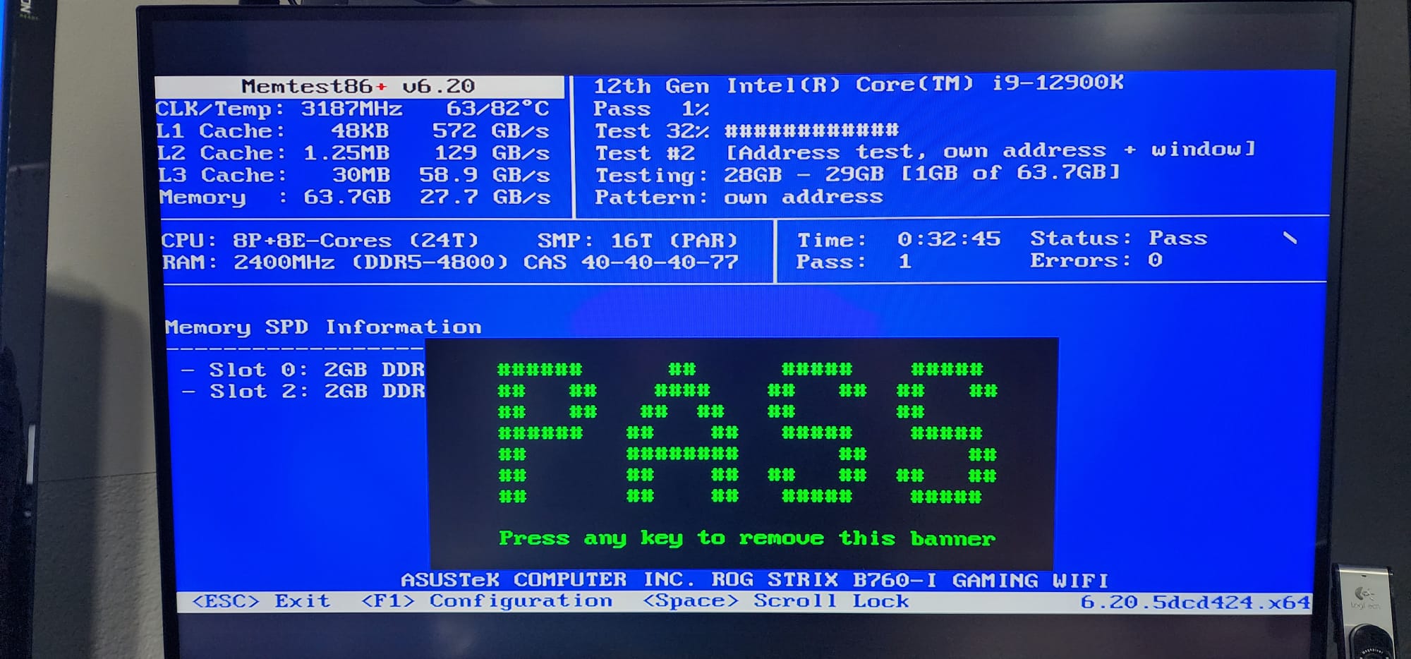

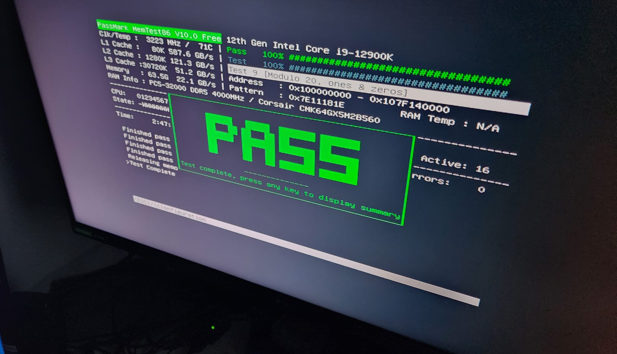

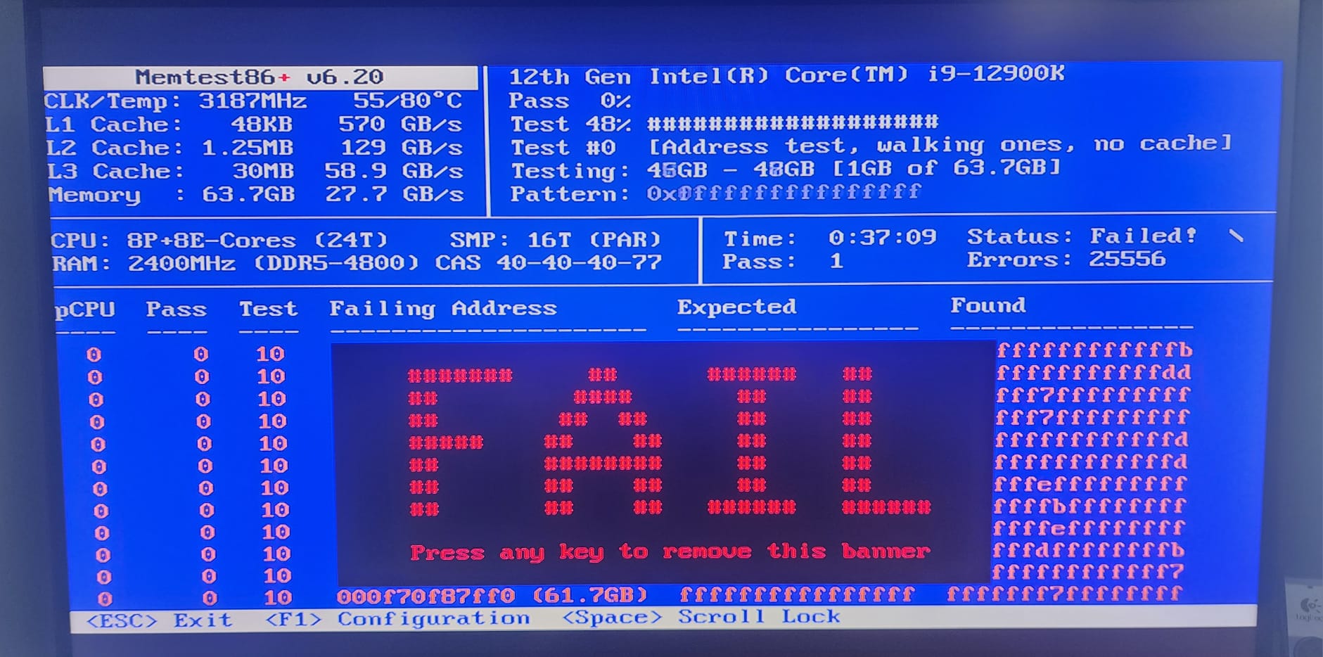

  9. The system had run for about 2 or 3 days without a crash, and then it crashed last night. I took @Vr2Io's advice and started taking action to run another memtest. I discovered the original memtest that I ran back in December was a memtest associated with the motherboard directly in the BIOS (if I understand correctly). That test originally ran for 2-3 hours and passed. Today I ran the memtest that is an option in the Unraid boot menu (where you choose GUI/safe mode/etc), and that test ran for less than an hour before finding errors. I immediately set up a return for the RAM sticks since I just bought them a month or two ago, and ordered a new pair of RAM sticks. They should get here tomorrow. Question 1: Was the RAM test that was done through the ASUS BIOS an inferior test? Why would that test pass and the unraid memtest detect errors/fail? Question 2: Is it safe to assume that most if not all of my system crashes are due to these errors/issues that the memtest is finding? I've seen a number of posts where folks said they system was crashing and replacing the RAM fixed the issue. I'm hoping I will be one of those folks soon. Thanks also to @JorgeB for the suggestion of hardware being a potential cause of these crashes, and to @itimpi for contributing as well. Thanks in advance
