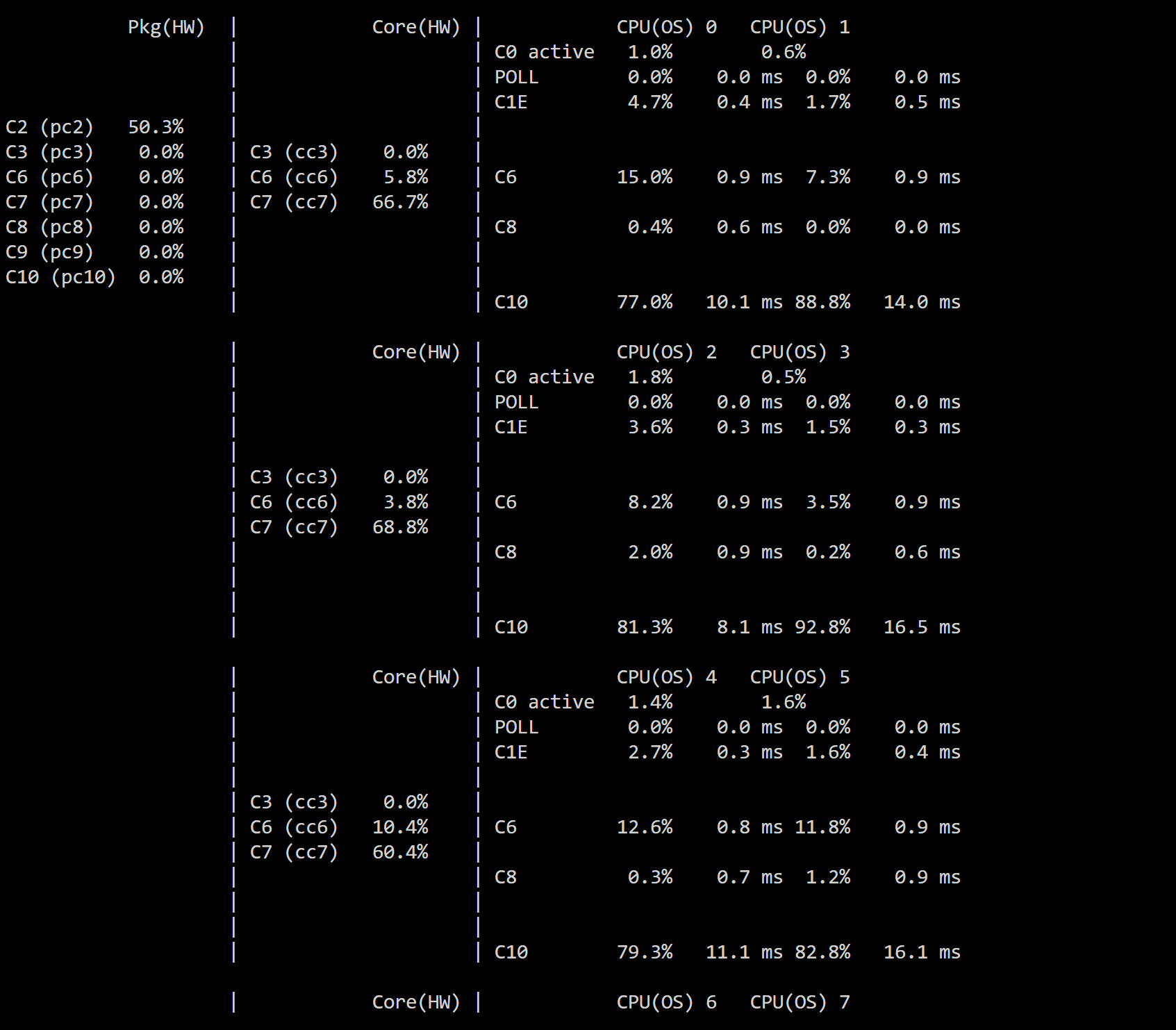

Reduce power consumption with powertop
Thanks this has seemed to make it work. Idle has dropped from 20-23w to 11-13w, so a good power saving. Once I left it a bit longer after the image below I was dropping into c10 state. My question is do you think this will affect plex transcoding? I'm using hardware transcoding to the Intel iGPU - will turning boost off have any effect on that? I will see how server performance goes otherwise with these settings enabled. I'm running plex/sabnzbd/sonarr/radarr/pi-hole/unbound dockers so I think even in it's non turbo boosting I should be okay?
