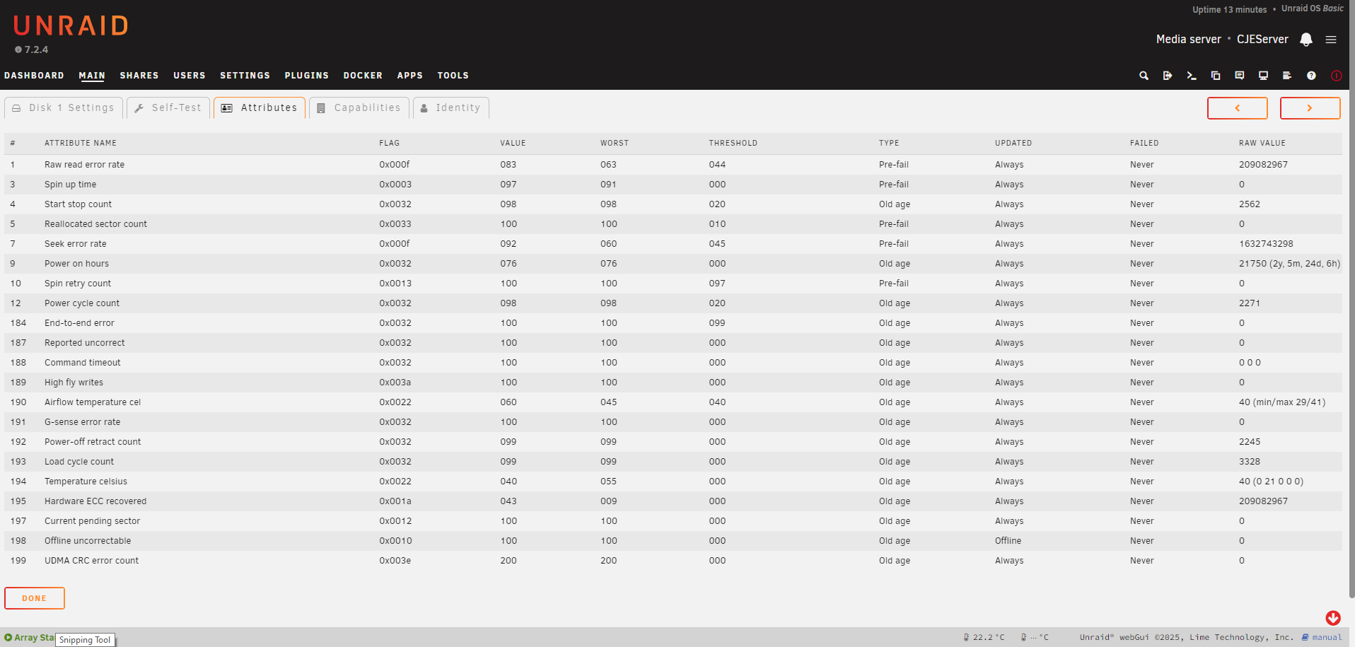

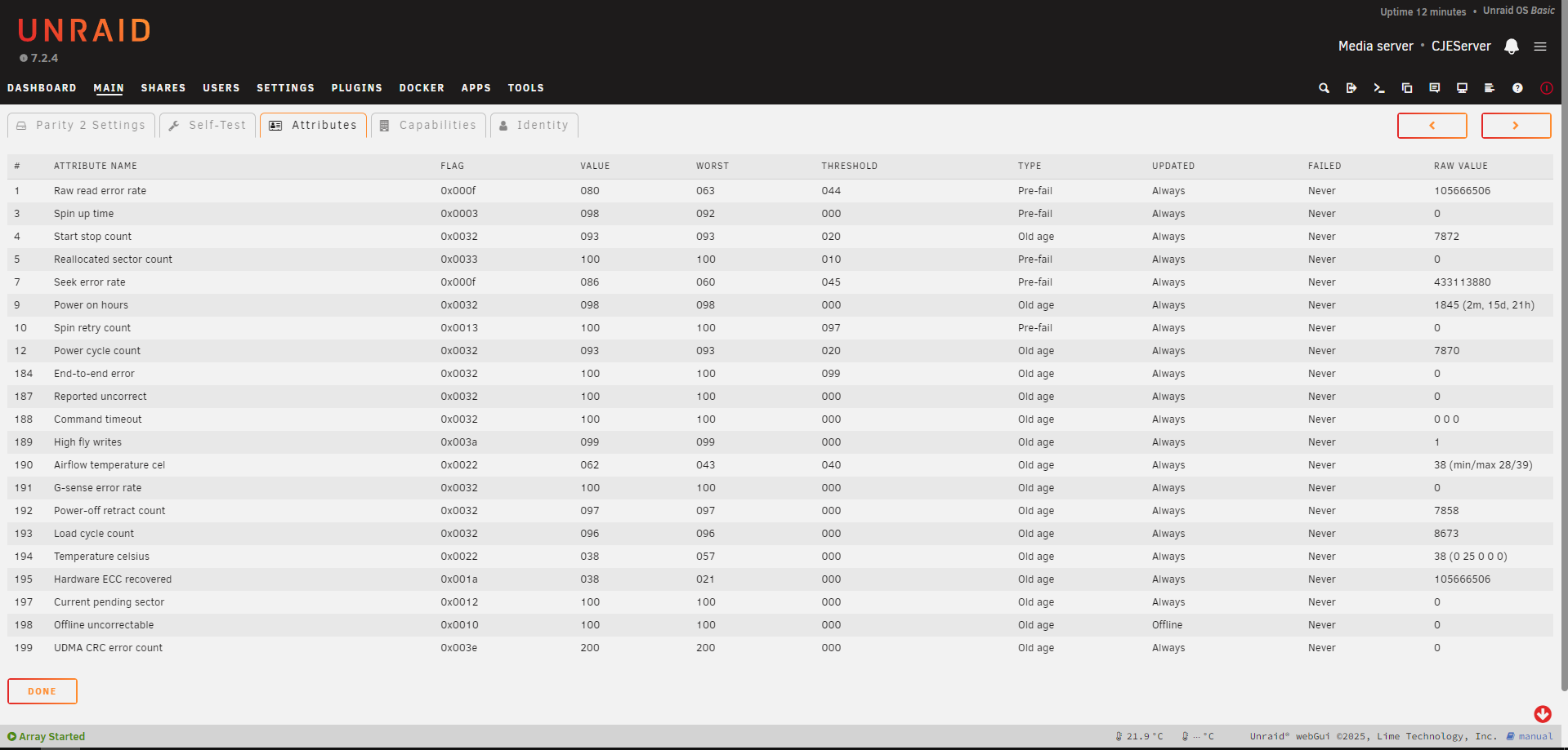

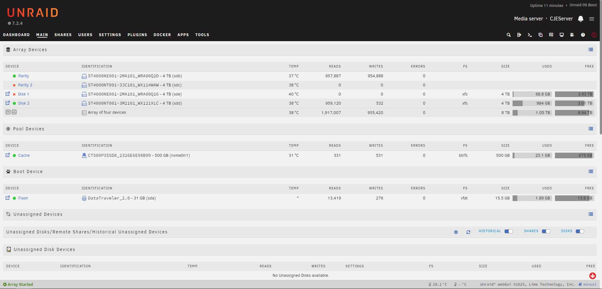

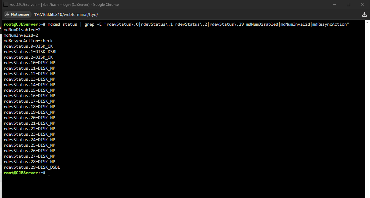

  3. i have swapped to new sata cables and divided the power cables to be 2 drives sharing 1 powere cable. disk1 is accessible now with all my data and files. its just that it is now on X and not the green dot
