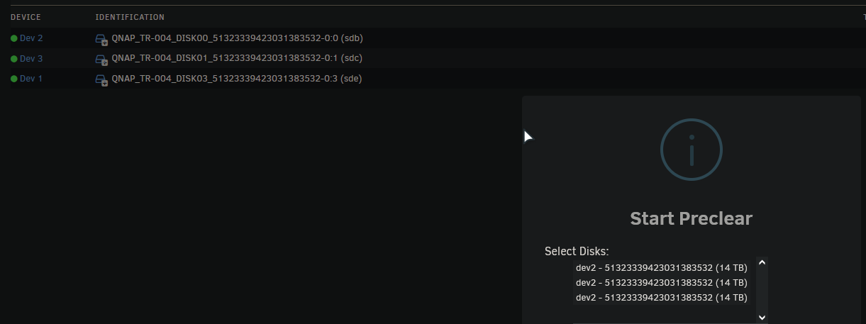

  6. I have a Beelink mini PC running an Intel NUC and 16GB of RAM connected via USB-C to a QNAP TR-004 DAS device. I am actually able to format and assign the drives without an issue. I can also preclear one at a time but I'm curious as to why I can't get multiple instances started at once.
