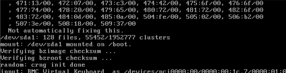

  3. I rebooted it a couple times now, so it should be captured in the log. I tried with the VM running with the VM autostart and with the VM stopped without autostart. Every time the array was not stardet after the reboot. During the startup I noticed something concerning on the monitor connected to the host: unraid-diagnostics-20240119-1231.zip

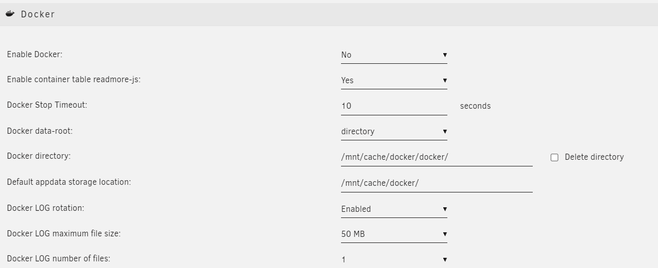

  9. Hello everyone, after two full days of evaluation I think that I will stay around for awhile My goal is to install Nextcloud with recognize app and allow it to use GPU. I am aware of the VM and passtrough (coming from ESXi world) but I like to learn new things and I really like to concept of sharing GPU among containers. This is why I am here. So far I maneged to install: Postgres15 (official) Nexctcloud (lscr.io/linuxserver/nextcloud) Nvidia Driver (ich777) I passed all the nvidia parameters to the nextcloud container and now I discovered that the container is missing Python, PIP, Tensorflow and even if those are installed they won't sustain a reboot. Does anyone have an experience setting this up? Is there a way to add something to the container? P.S. As I am learning more and more I found that there is a "Nextcloud-aio-mastercontainer" but I was unable to find the guide for it.
  10. I stopped Docker, moved files manually, changed paths, enabled docker. Looks like it works.

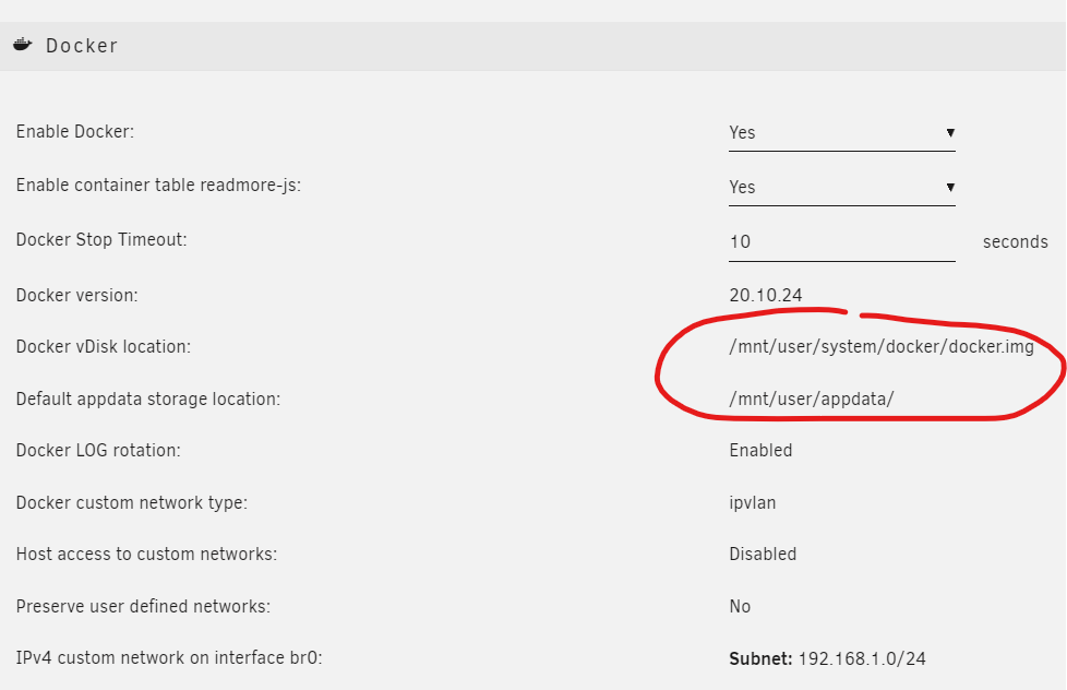

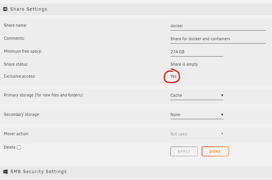

  11. I think that I am mixing terminology, a "Share" doesn't necessary mean a network share. Is it something like a "Dataset" in Truenas? If so... It can be set so that it won't be a symlink but directly pointing to the cache pool. I think that I managed to do that. Now... would the system move existing docker data if I point the docker to a new share here? I don't see "MOVE" to the new location button. Does it requires manual intervention?
  12. Thank you guys for your help. I will read more in the manual, it's a lot of reading and experiemnting for relatively short 30 day trial. I was surprised to see "/mnt/user" where you'd expect system level operations and I think that it's related to what Jorge is referring to. Can you please elaborate on this:

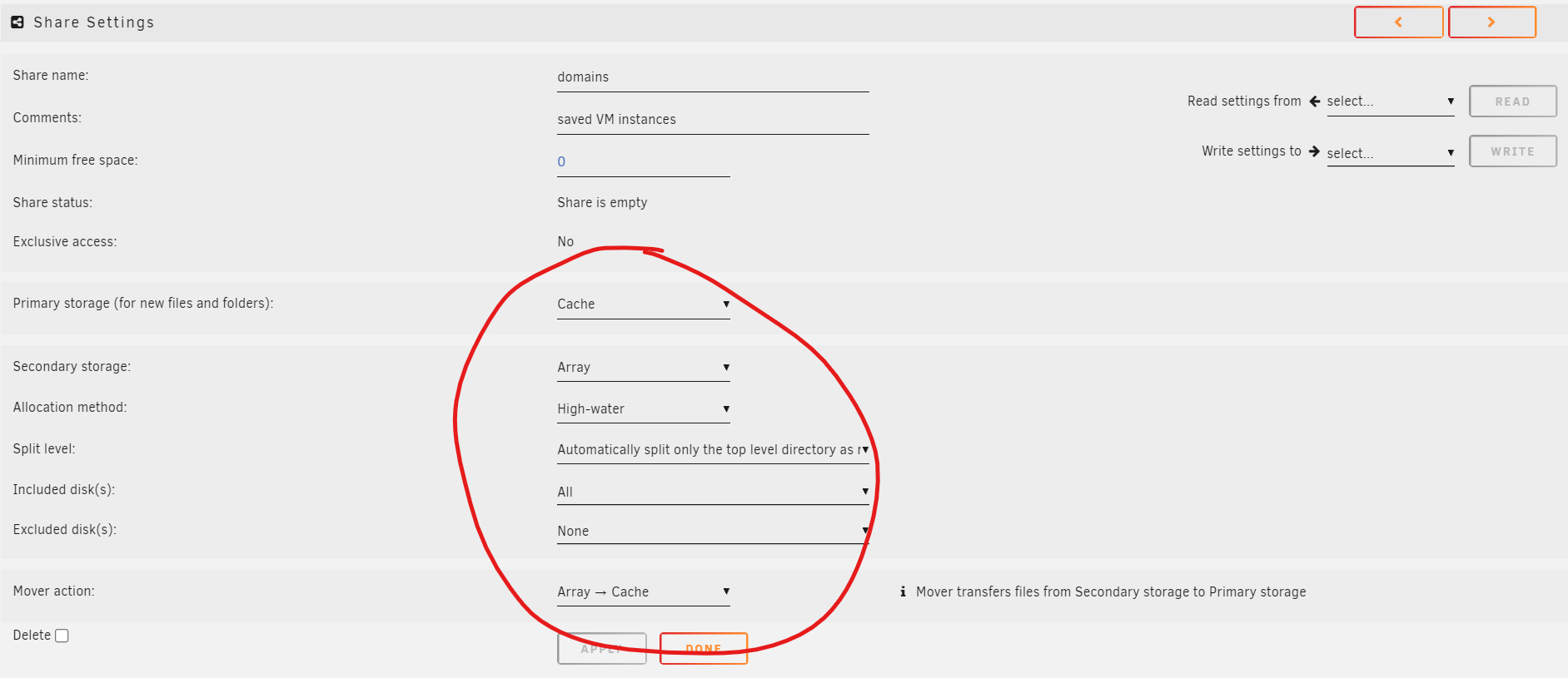

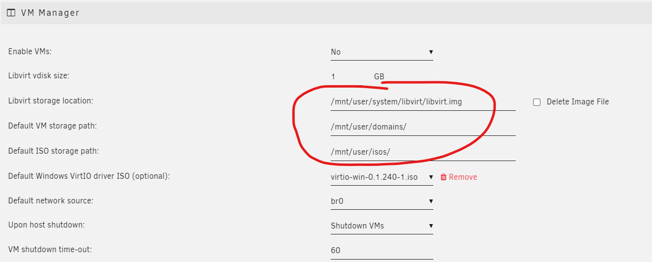

  13. unraid-diagnostics-20240115-1150.zip
