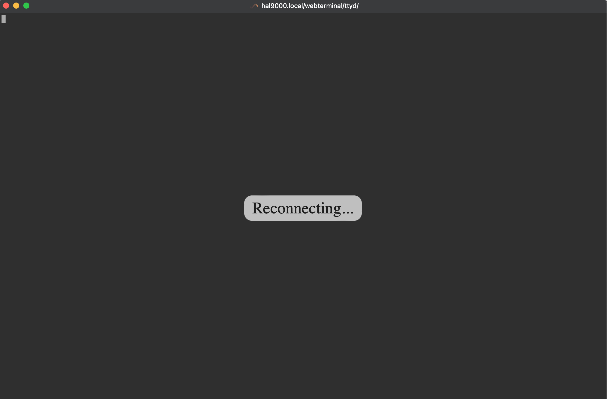

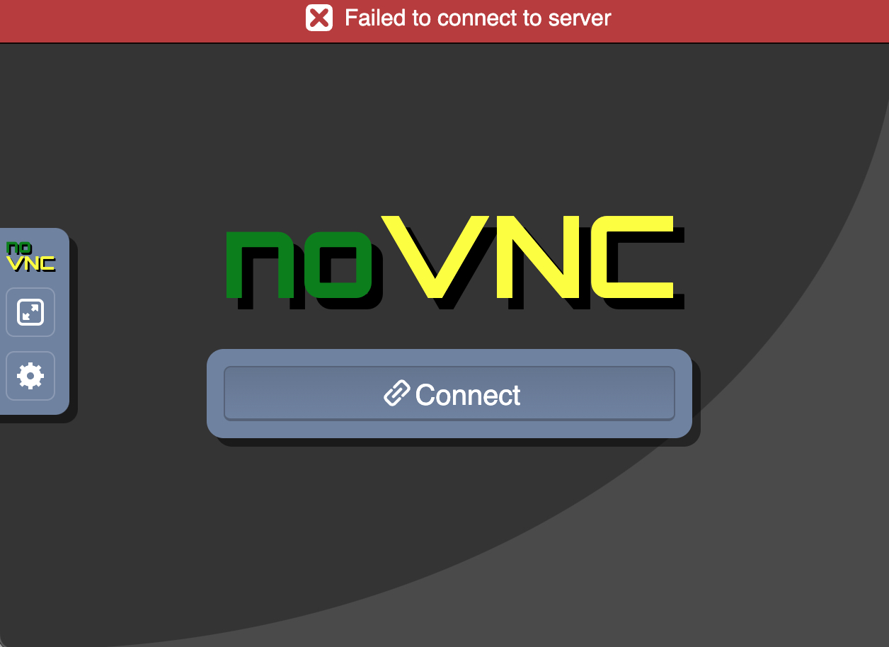

  14. Thank you for helping here! Ok I tried the following but nothing worked: 1. Clearing cookies in chrome 2. Chrome incognito 3. Safari cleared cookies 4. Safari Private 5. Firefox cleared cookies 6. Firefox Private I also disabled all my ad blockers and disabled any in-browser pop-up blocking / site protection I could find. But obviously if it were one of these issues, the problem wouldn't follow me across browsers. Here's the list of previous steps taken that were also unsuccessful:
