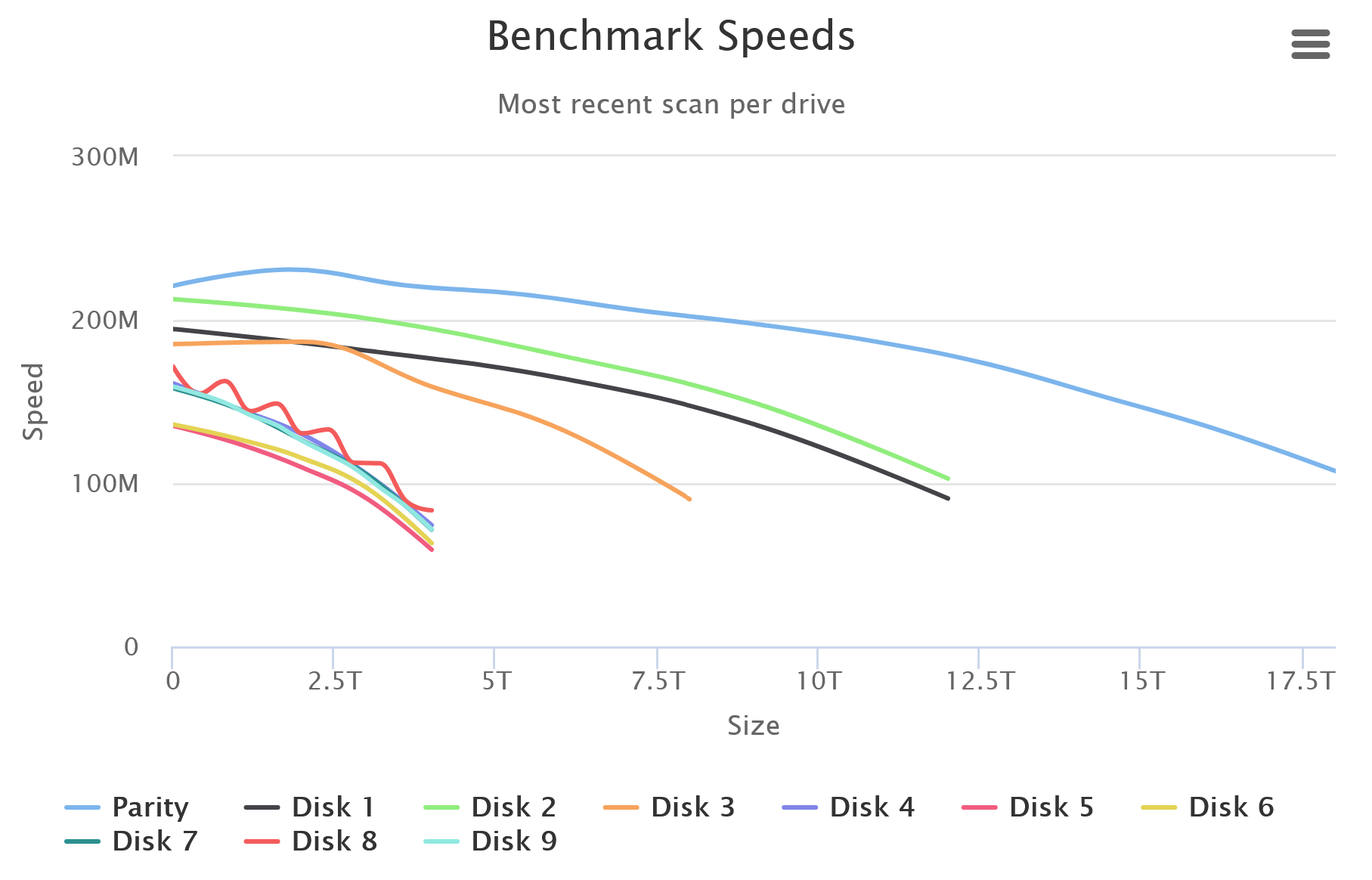

  11. well, the speed tests show pretty much similar reads on all drives, for the second part I don't know how to validate

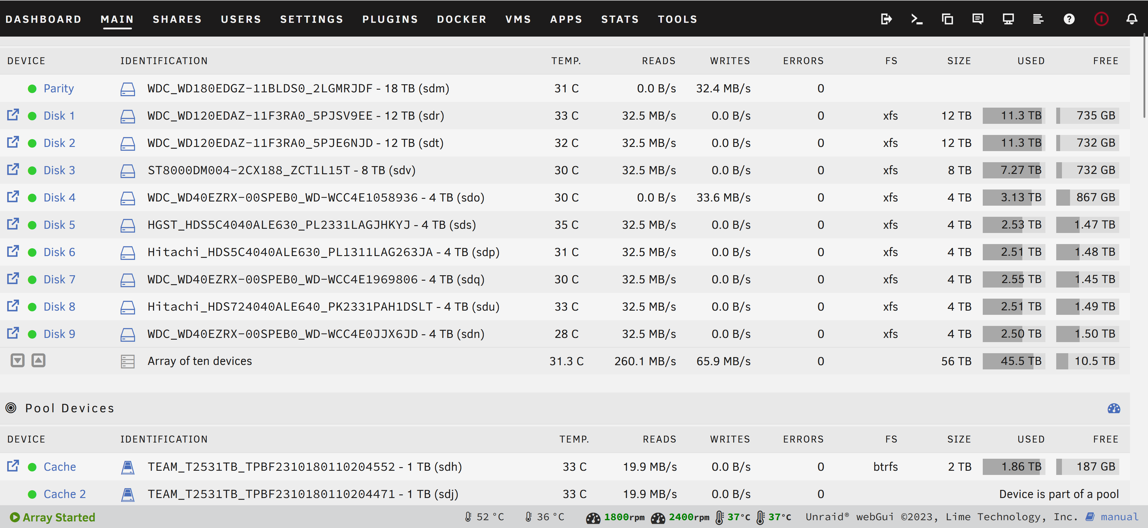

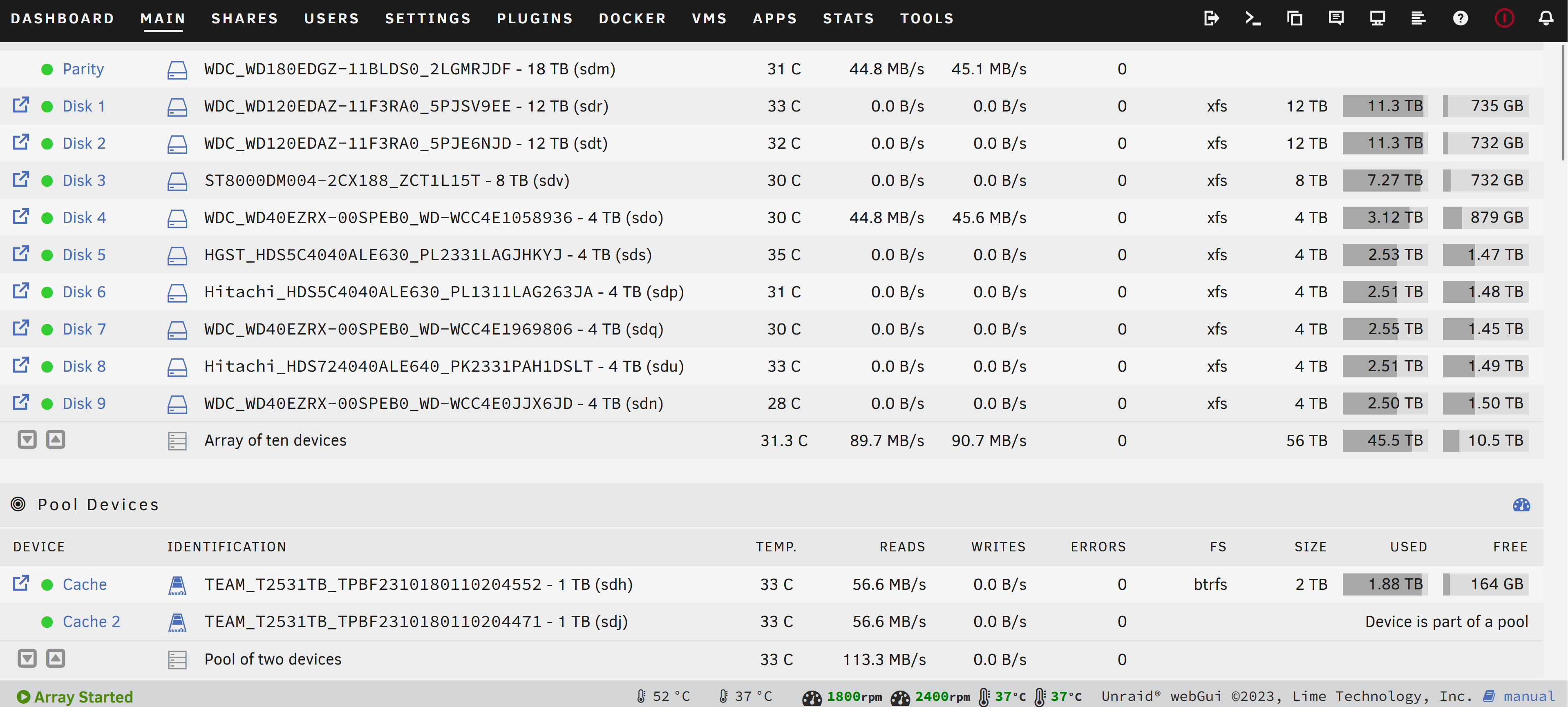

  12. please see the attached file ( was captured during read/modify/write mode if it makes difference) lspci.txt
