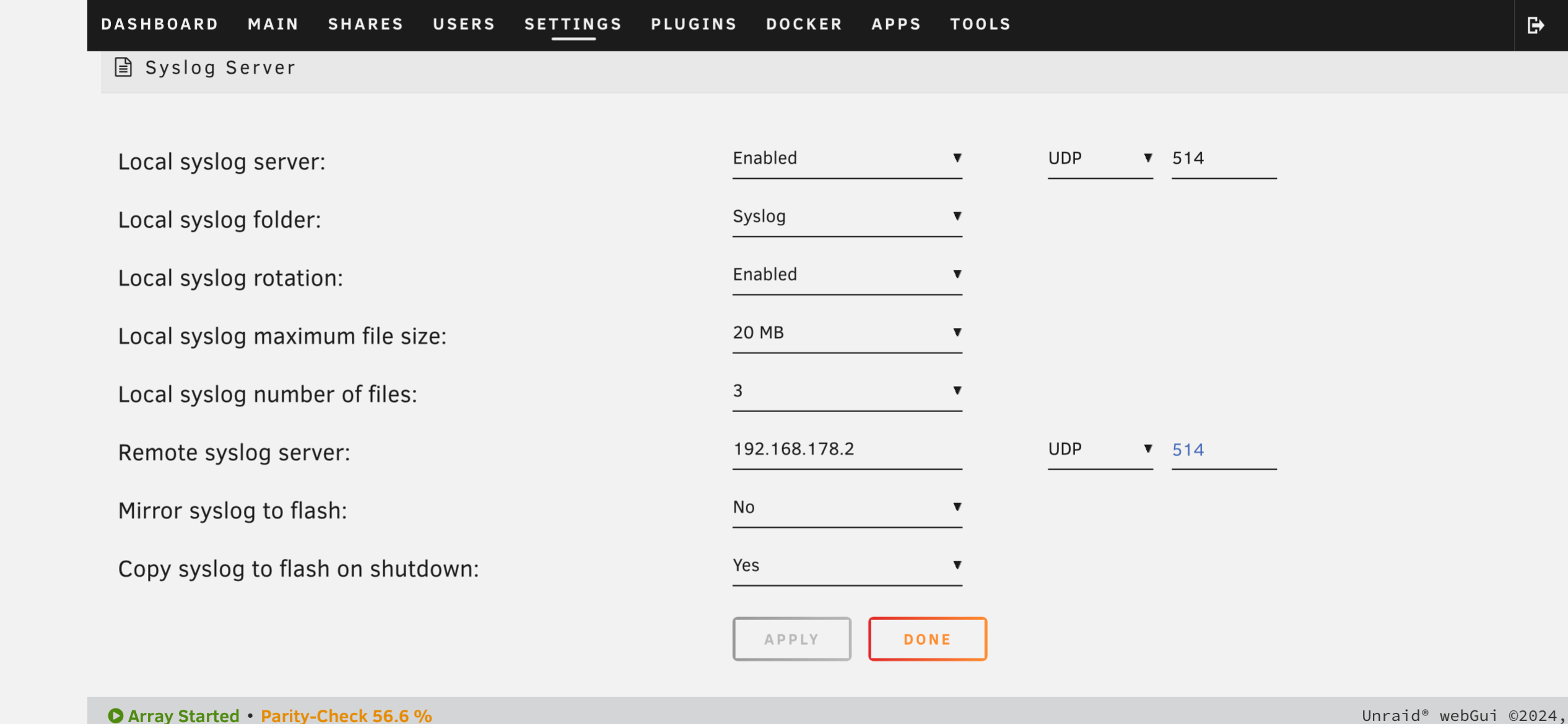

  6. Here is a screenshot of the syslog settings.
  7. I actually did enable the syslog server after the crash before so I hoped the log log now includes the relevant data. Maybe I’ve misconfigured it through if it’s not in there.
