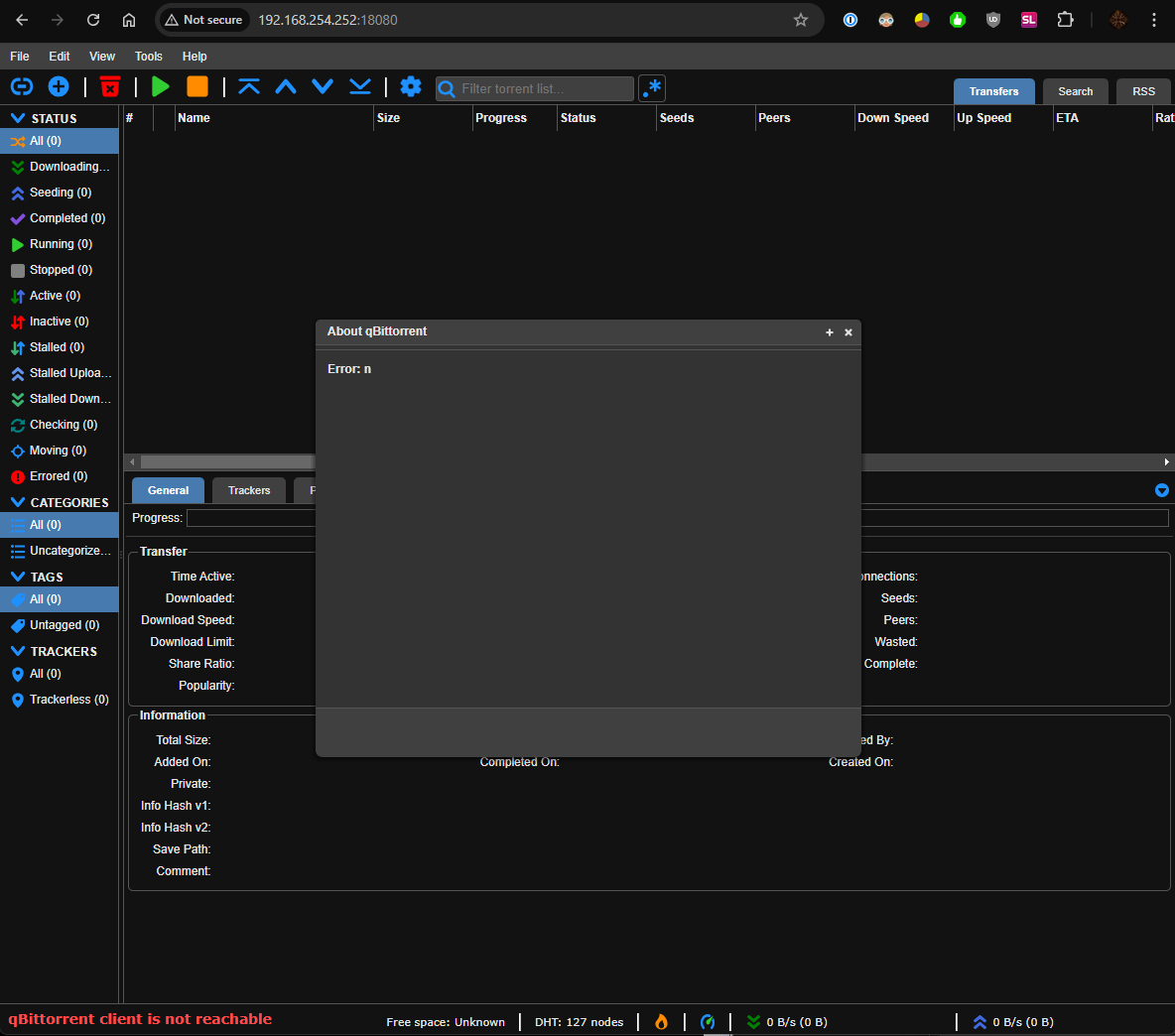

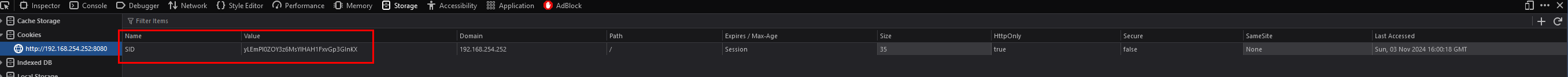

  4. After further testing this morning, I found that once I changed the WEBUI password on the second instance from the temporary credentials in the supervisord.log, the SIDs were different, and I could now open both at the same time. So, I guess this is either the fix or the workaround. Regardless, I'll let you decide if any code changes, etc., need to be made on the backend.
  5. Ok, I see what's happening. The SID cookie is getting overwritten when the second one comes online. I am guessing this is what is causing the problem because it thinks they are the same instance when they are not. Before on 8080: open 18080 before login: Log into 18080 and the cookie for both changes:

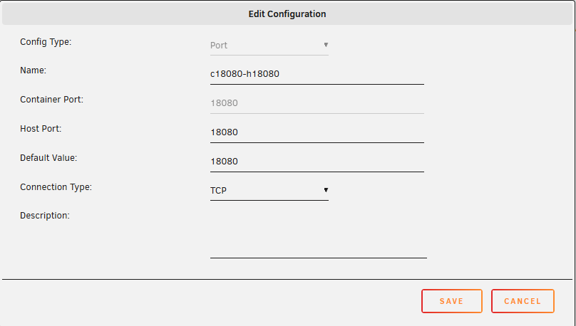

  6. Ok, that fixed the WebUI. Now for the second question. I figured out how to reproduce it. I cleared all cookies associated with my server. I then opened the webui for the second instance (18080). Everything works fine. No errors. While this one is open, I open the first instance (8080). The second instance gives the "can't connect" error when the first instance opens. Trying the about gives the popup.: I tested this on chrome and firefox with the same results. If the first instance (8080) is already open, and I open the second instance (18080) webui, the second instance has the error. The first instance seems always to be the priority.
