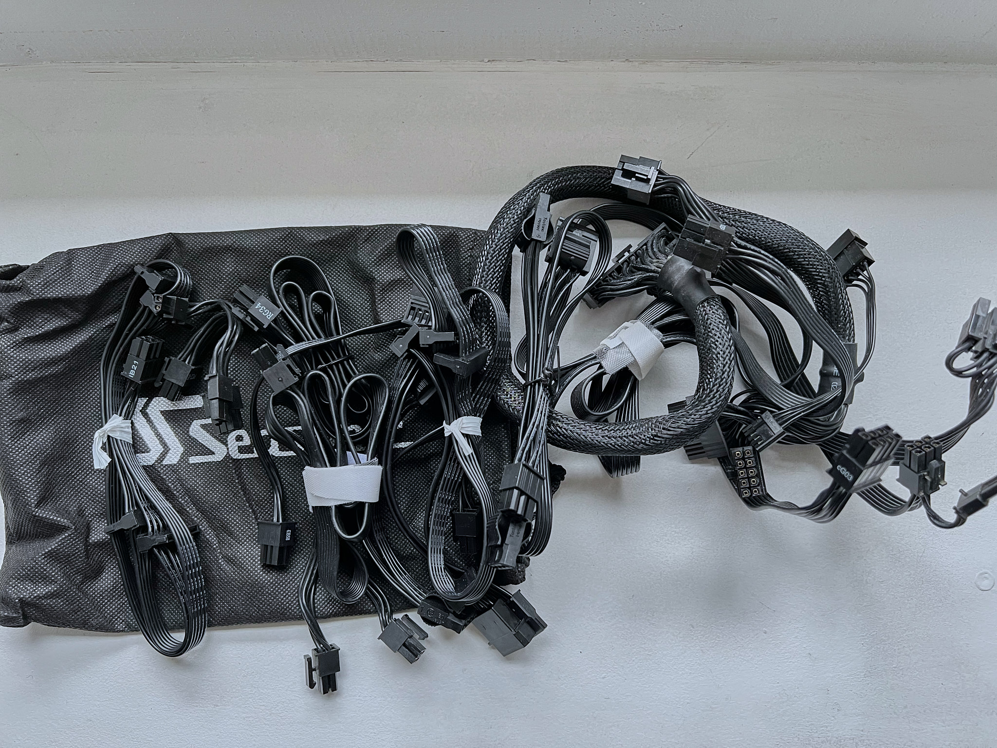

[4Sale][EU-GER] Seasonic Prime Titanium 650W PSU / ATX

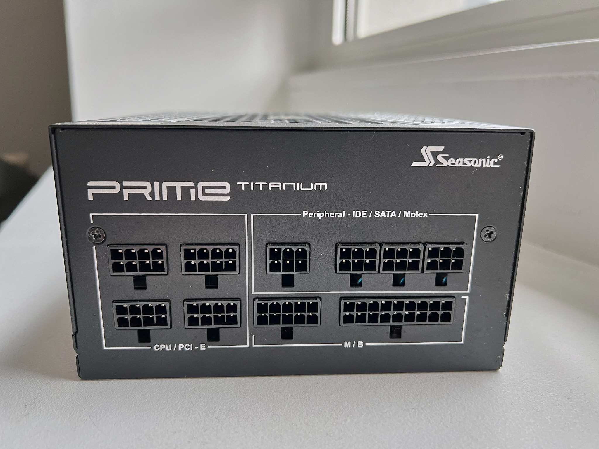

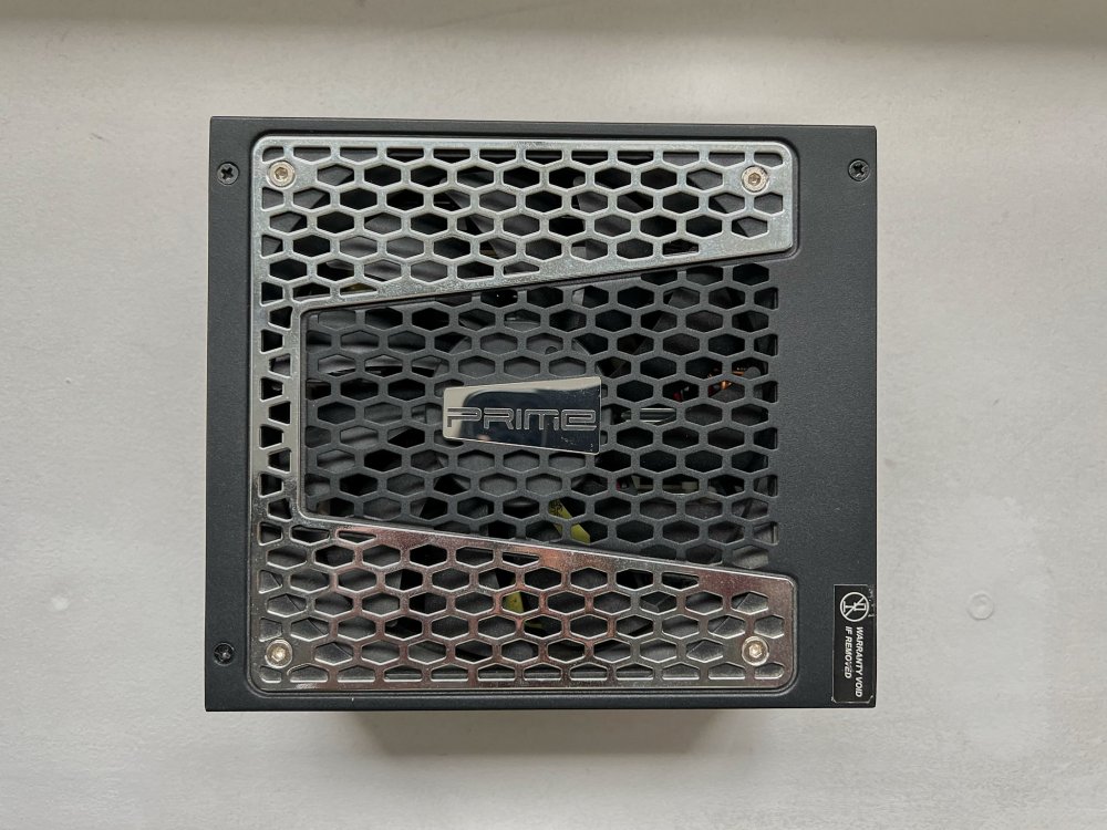

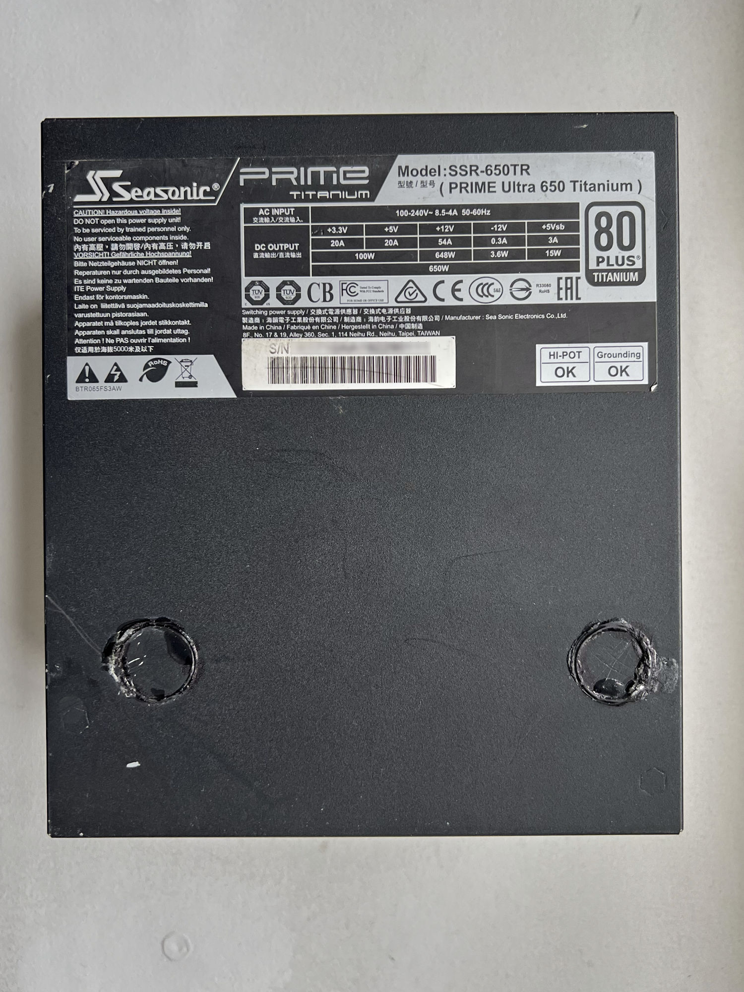

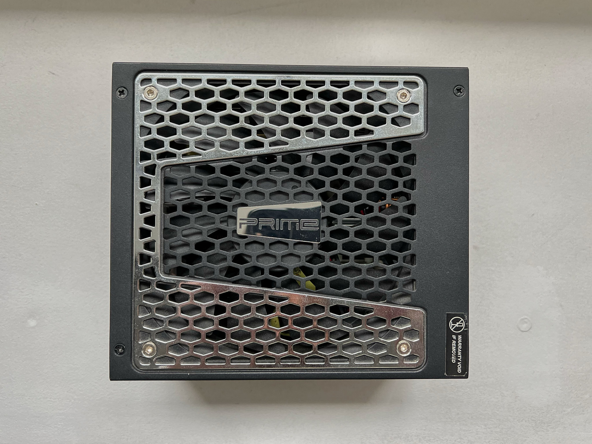

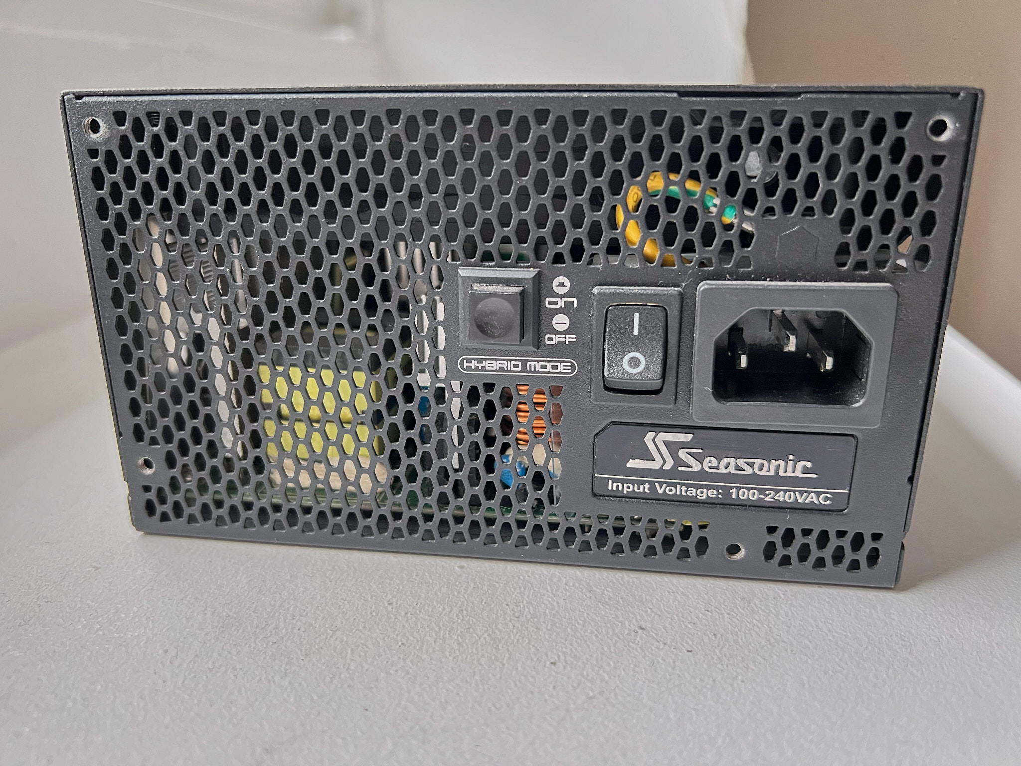

Selling this super efficient PSU from Seasonic that does not fit within my new chassis unfortunately. The unit works flawlessly but has minor scratches on the rear - see pics. Does not interfere with the function of course. Price: 130€ plus additional shipping costs. Payment either via wire transfer or also PayPal. Specs Power: 650 Watt Line: Seasonic Prime Ultra 650 Titanium Model: SSR-650TR Fully modular Connectors: 4+4 CPU, 24 Pin, 6+2 Pin PCI Express, 6 Pin PCI Express, 8 Pin PCI Express Dimensions: 170mm x 150mm x 86mm Comes with original packaging and original content (cables, straps, manual etc.) Notice: It's a private sale of a used unit. I exclude all liability for material defects and it is made under exclusion of any warranty or returns.
