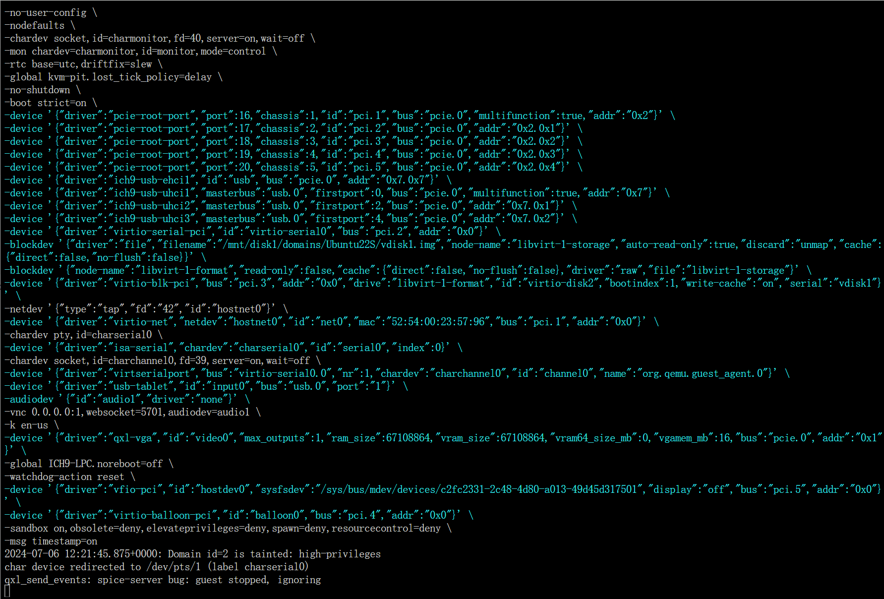

  1. after I changed the vgpu pci address on the vm xml to the physical address, the vm finally worked properly.

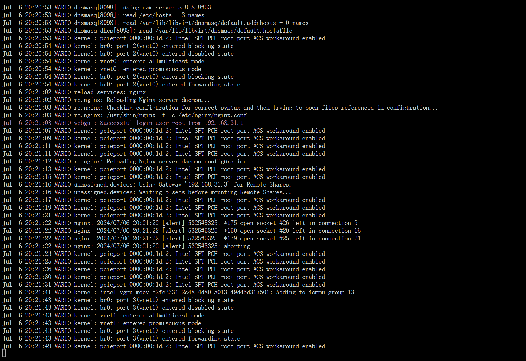

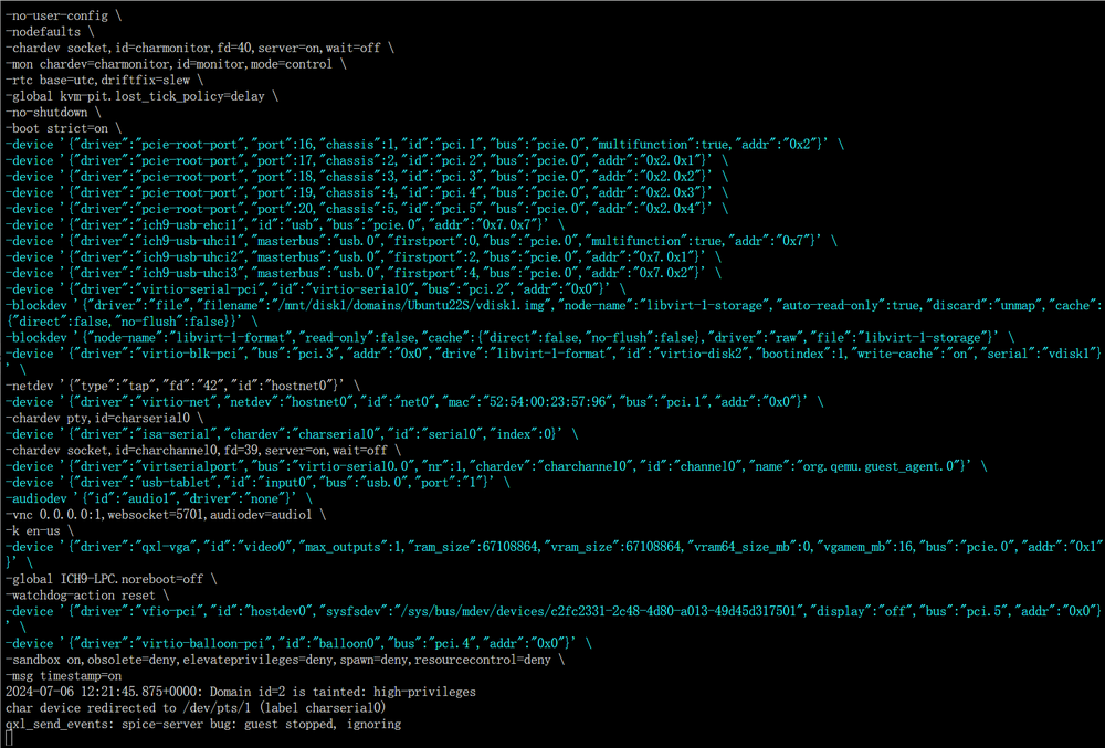

  2. i retry boot ubuntu with gvt-g at 20:03 unraid sys.log Sep 4 20:02:42 MARIO kernel: pcieport 0000:00:1d.2: Intel SPT PCH root port ACS workaround enabled Sep 4 20:03:09 MARIO kernel: br0: port 3(vnet2) entered disabled state Sep 4 20:03:09 MARIO kernel: vnet2 (unregistering): left allmulticast mode Sep 4 20:03:09 MARIO kernel: vnet2 (unregistering): left promiscuous mode Sep 4 20:03:09 MARIO kernel: br0: port 3(vnet2) entered disabled state Sep 4 20:03:22 MARIO kernel: pcieport 0000:00:1d.2: Intel SPT PCH root port ACS workaround enabled Sep 4 20:03:23 MARIO kernel: pcieport 0000:00:1d.2: Intel SPT PCH root port ACS workaround enabled Sep 4 20:03:28 MARIO kernel: pcieport 0000:00:1d.2: Intel SPT PCH root port ACS workaround enabled Sep 4 20:03:33 MARIO kernel: pcieport 0000:00:1d.2: Intel SPT PCH root port ACS workaround enabled Sep 4 20:03:34 MARIO kernel: pcieport 0000:00:1d.2: Intel SPT PCH root port ACS workaround enabled Sep 4 20:03:37 MARIO kernel: pcieport 0000:00:1d.2: Intel SPT PCH root port ACS workaround enabled Sep 4 20:03:37 MARIO kernel: pcieport 0000:00:1d.2: Intel SPT PCH root port ACS workaround enabled Sep 4 20:03:43 MARIO kernel: intel_vgpu_mdev 68af120f-0815-411f-8a18-28c0811b924c: Adding to iommu group 13 Sep 4 20:03:45 MARIO kernel: br0: port 3(vnet3) entered blocking state Sep 4 20:03:45 MARIO kernel: br0: port 3(vnet3) entered disabled state Sep 4 20:03:45 MARIO kernel: vnet3: entered allmulticast mode Sep 4 20:03:45 MARIO kernel: vnet3: entered promiscuous mode Sep 4 20:03:45 MARIO kernel: br0: port 3(vnet3) entered blocking state Sep 4 20:03:45 MARIO kernel: br0: port 3(vnet3) entered forwarding state Sep 4 20:03:50 MARIO kernel: pcieport 0000:00:1d.2: Intel SPT PCH root port ACS workaround enabled Sep 4 20:04:31 MARIO flash_backup: adding task: /usr/local/emhttp/plugins/dynamix.my.servers/scripts/UpdateFlashBackup update but just find some syslog in ubuntu at this time, hope this is useful. and i just had the same problem in debain🙁 Sep 4 20:03:05 ubuntu22s systemd[1]: unattended-upgrades.service: Deactivated successfully. Sep 4 20:03:05 ubuntu22s systemd[1]: Stopping Session 1 of User megumi... Sep 4 20:03:05 ubuntu22s systemd[1]: Stopping Session 3 of User megumi... Sep 4 20:03:05 ubuntu22s systemd[1]: Removed slice Slice /system/modprobe. Sep 4 20:03:05 ubuntu22s systemd[1]: Stopped target Cloud-init target. Sep 4 20:03:05 ubuntu22s systemd[1]: Stopped target Graphical Interface. Sep 4 20:03:05 ubuntu22s systemd[1]: Stopped target Host and Network Name Lookups. Sep 4 20:03:05 ubuntu22s systemd[1]: Stopped target Timer Units. Sep 4 20:03:05 ubuntu22s systemd[1]: apt-daily-upgrade.timer: Deactivated successfully. Sep 4 20:03:05 ubuntu22s systemd[1]: Stopped Daily apt upgrade and clean activities. Sep 4 20:03:05 ubuntu22s systemd[1]: apt-daily.timer: Deactivated successfully. Sep 4 20:03:05 ubuntu22s systemd[1]: Stopped Daily apt download activities. Sep 4 20:03:05 ubuntu22s systemd[1]: dpkg-db-backup.timer: Deactivated successfully. Sep 4 20:03:05 ubuntu22s systemd[1]: Stopped Daily dpkg database backup timer. Sep 4 20:03:05 ubuntu22s systemd[1]: e2scrub_all.timer: Deactivated successfully. Sep 4 20:03:05 ubuntu22s systemd[1]: Stopped Periodic ext4 Online Metadata Check for All Filesystems. Sep 4 20:03:05 ubuntu22s systemd[1]: fstrim.timer: Deactivated successfully. Sep 4 20:03:05 ubuntu22s systemd[1]: Stopped Discard unused blocks once a week. Sep 4 20:03:05 ubuntu22s systemd[1]: fwupd-refresh.timer: Deactivated successfully. Sep 4 20:03:05 ubuntu22s systemd[1]: Stopped Refresh fwupd metadata regularly. Sep 4 20:03:05 ubuntu22s systemd[1]: logrotate.timer: Deactivated successfully. Sep 4 20:03:05 ubuntu22s systemd[1]: Stopped Daily rotation of log files. Sep 4 20:03:05 ubuntu22s systemd[1]: man-db.timer: Deactivated successfully. Sep 4 20:03:05 ubuntu22s systemd[1]: Stopped Daily man-db regeneration. Sep 4 20:03:05 ubuntu22s systemd[1]: motd-news.timer: Deactivated successfully. Sep 4 20:03:05 ubuntu22s systemd[1]: Stopped Message of the Day. Sep 4 20:03:05 ubuntu22s systemd[1]: systemd-tmpfiles-clean.timer: Deactivated successfully. Sep 4 20:03:05 ubuntu22s systemd[1]: Stopped Daily Cleanup of Temporary Directories. Sep 4 20:03:05 ubuntu22s systemd[1]: update-notifier-download.timer: Deactivated successfully. Sep 4 20:03:05 ubuntu22s systemd[1]: Stopped Download data for packages that failed at package install time. Sep 4 20:03:05 ubuntu22s systemd[1]: update-notifier-motd.timer: Deactivated successfully. Sep 4 20:03:05 ubuntu22s systemd[1]: Stopped Check to see whether there is a new version of Ubuntu available. Sep 4 20:03:05 ubuntu22s systemd[1]: lvm2-lvmpolld.socket: Deactivated successfully. Sep 4 20:03:05 ubuntu22s systemd[1]: Closed LVM2 poll daemon socket. Sep 4 20:03:05 ubuntu22s systemd[1]: systemd-rfkill.socket: Deactivated successfully. Sep 4 20:03:05 ubuntu22s systemd[1]: Closed Load/Save RF Kill Switch Status /dev/rfkill Watch. Sep 4 20:03:05 ubuntu22s systemd[1]: Stopping Availability of block devices... Sep 4 20:03:05 ubuntu22s systemd[1]: cloud-final.service: Deactivated successfully. Sep 4 20:03:05 ubuntu22s systemd[1]: Stopped Execute cloud user/final scripts. Sep 4 20:03:05 ubuntu22s systemd[1]: Stopped target Multi-User System. Sep 4 20:03:05 ubuntu22s systemd[1]: Stopped target Login Prompts. Sep 4 20:03:05 ubuntu22s systemd[1]: Stopping Modem Manager... Sep 4 20:03:05 ubuntu22s ModemManager[779]: <info> caught signal, shutting down... Sep 4 20:03:05 ubuntu22s systemd[1]: Stopping LSB: automatic crash report generation... Sep 4 20:03:05 ubuntu22s dockerd[1006]: time="2024-09-04T20:03:05.482724141+08:00" level=info msg="Processing signal 'terminated'" Sep 4 20:03:05 ubuntu22s systemd[1]: cloud-config.service: Deactivated successfully. Sep 4 20:03:05 ubuntu22s systemd[1]: Stopped Apply the settings specified in cloud-config. Sep 4 20:03:05 ubuntu22s systemd[1]: Stopped target Cloud-config availability. Sep 4 20:03:05 ubuntu22s systemd[1]: Stopping Regular background program processing daemon... Sep 4 20:03:05 ubuntu22s systemd[1]: Stopping Docker Application Container Engine... Sep 4 20:03:05 ubuntu22s systemd[1]: Stopping Create final runtime dir for shutdown pivot root... Sep 4 20:03:05 ubuntu22s systemd[1]: Stopping Getty on tty1... Sep 4 20:03:05 ubuntu22s systemd[1]: Stopping irqbalance daemon... Sep 4 20:03:05 ubuntu22s ModemManager[779]: <info> ModemManager is shut down Sep 4 20:03:05 ubuntu22s systemd[1]: Stopping LVM event activation on device 252:3... Sep 4 20:03:05 ubuntu22s dockerd[1006]: time="2024-09-04T20:03:05.487896793+08:00" level=info msg="Daemon shutdown complete" Sep 4 20:03:05 ubuntu22s systemd[1]: Stopping Dispatcher daemon for systemd-networkd... Sep 4 20:03:05 ubuntu22s systemd[1]: plymouth-quit.service: Deactivated successfully. Sep 4 20:03:05 ubuntu22s systemd[1]: Stopped Terminate Plymouth Boot Screen. Sep 4 20:03:05 ubuntu22s systemd[1]: Stopping System Logging Service...

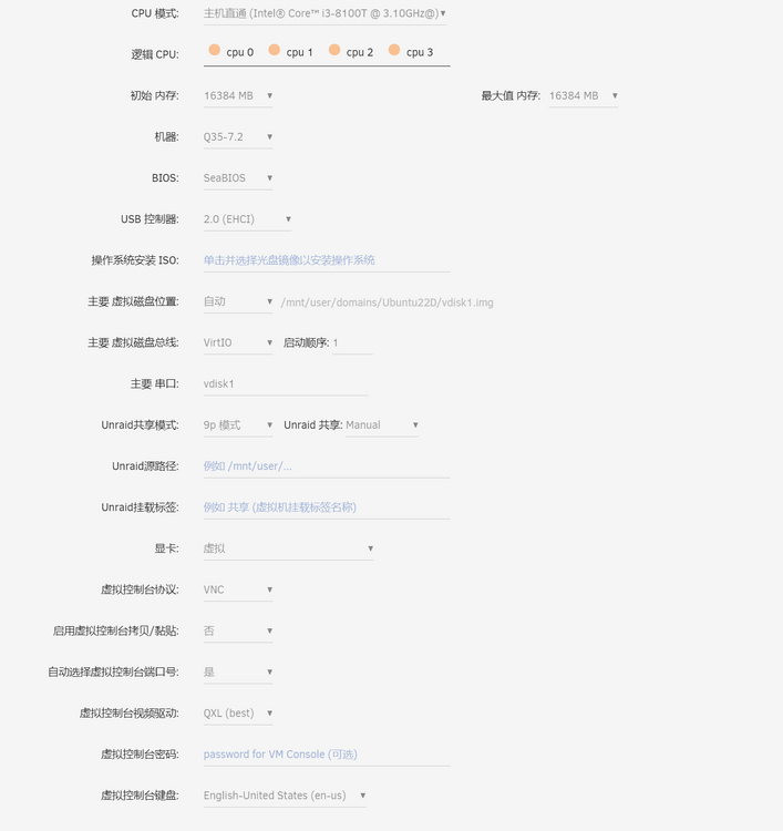

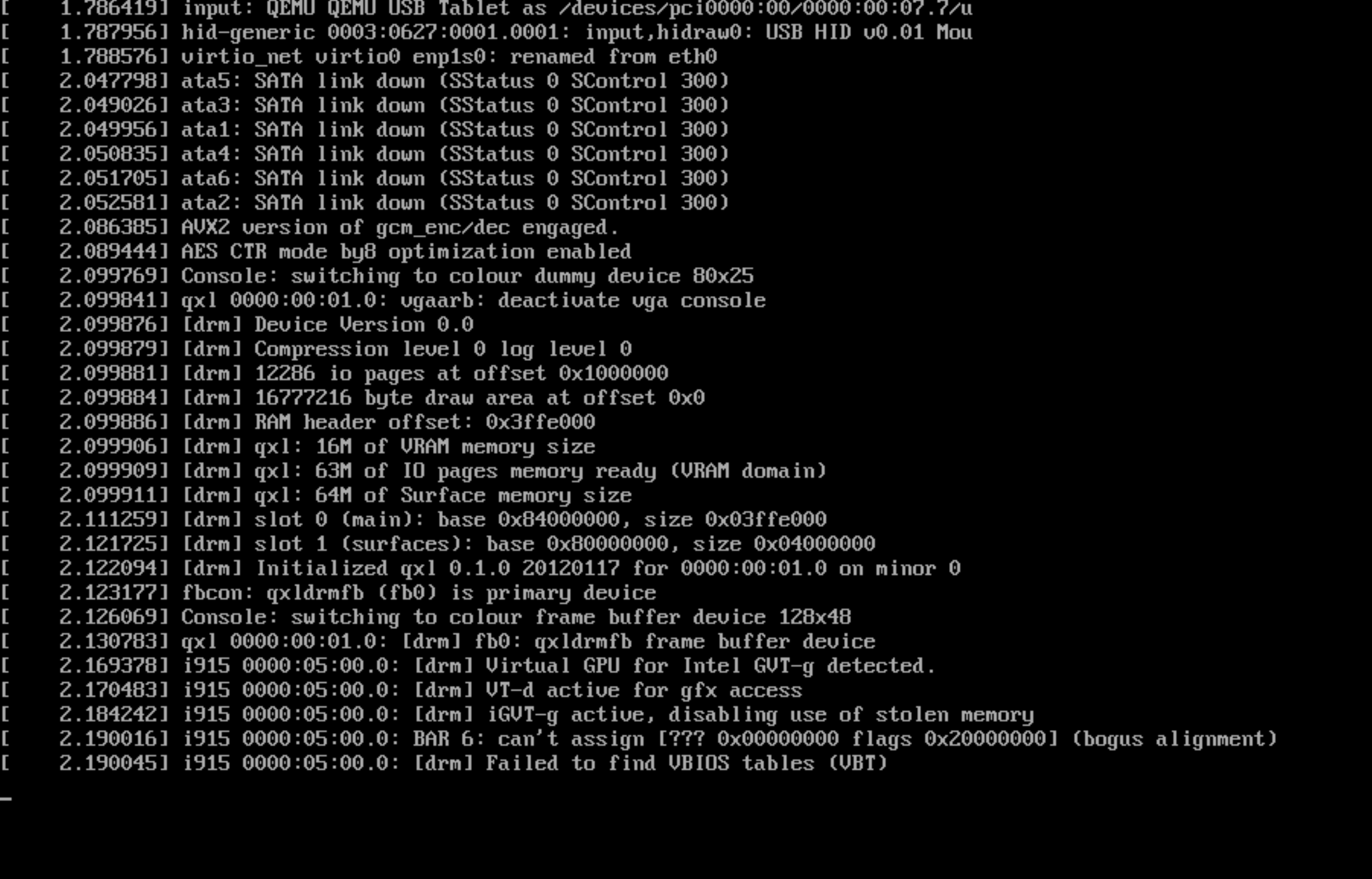

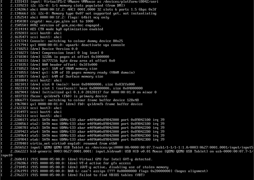

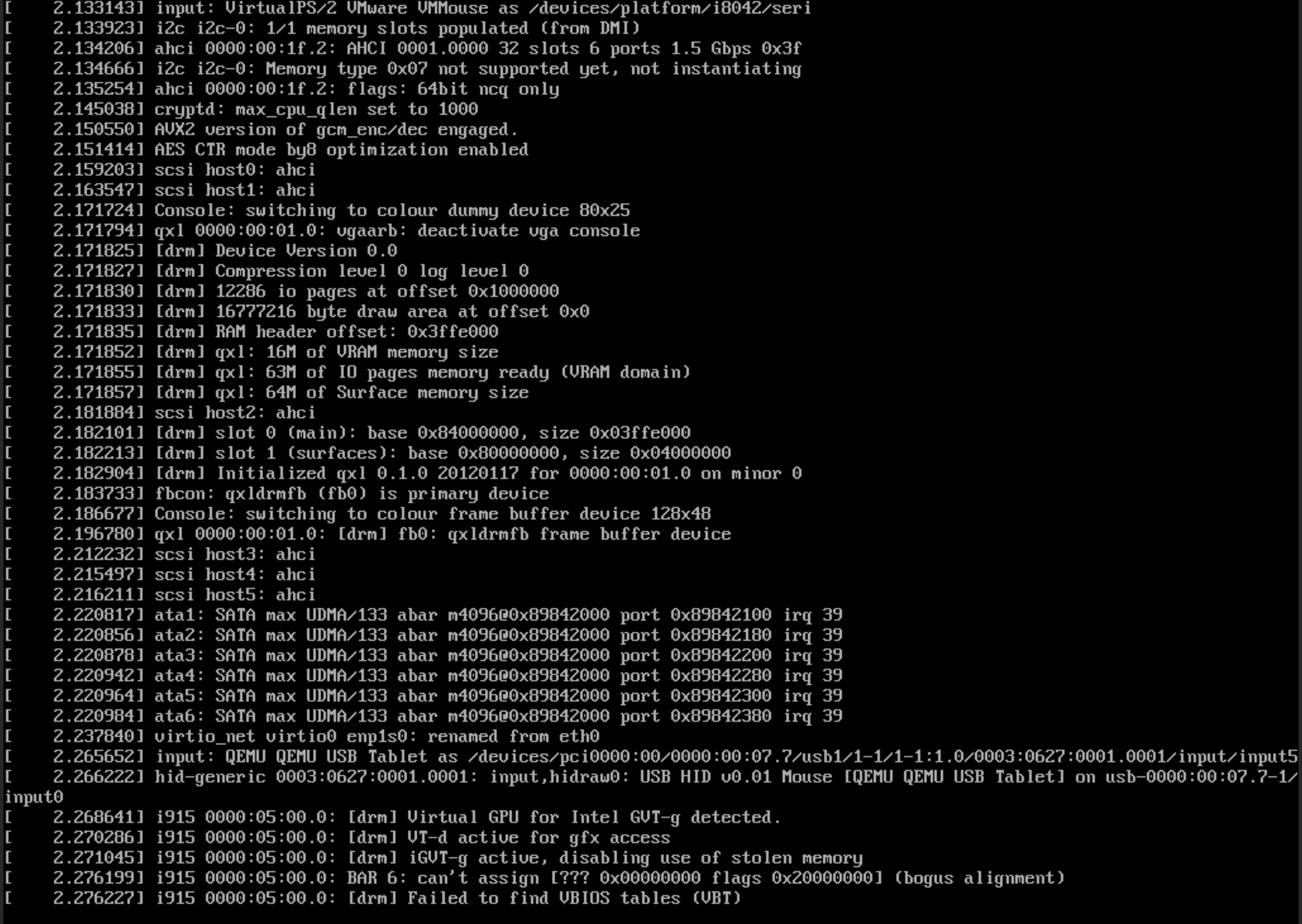

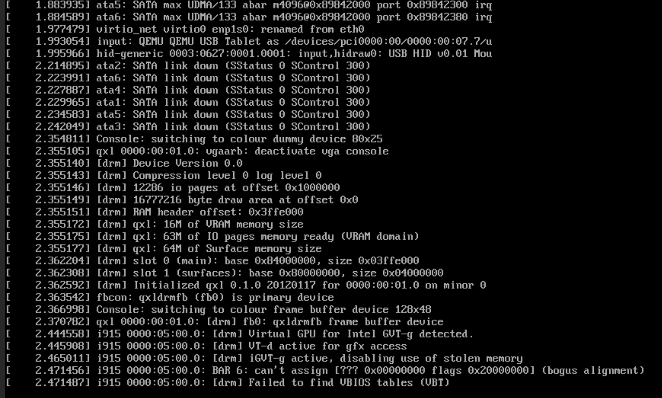

  4. Every time you restart the Ubuntu VM, you may get the error shown in the picture, but sometimes it will work normally.

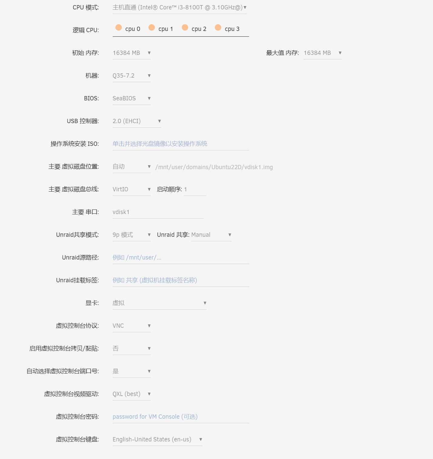

  5. gvt-g works fine in version 6.12,but 7.0 not work in ubuntu,and in another Synology vm, gvt-g works fine I not find useful logs cpu 8100t ubuntu 22.04 server ubuntu boot log,always stuck here other log ubuntu xml <?xml version='1.0' encoding='UTF-8'?> <domain type='kvm' id='2'> <name>Ubuntu22S</name> <uuid>42241007-8a01-c840-e9f2-592fb9002ec3</uuid> <metadata> <vmtemplate xmlns="unraid" name="Ubuntu" icon="ubuntu.png" os="ubuntu"/> </metadata> <memory unit='KiB'>16777216</memory> <currentMemory unit='KiB'>8388608</currentMemory> <memoryBacking> <nosharepages/> </memoryBacking> <vcpu placement='static'>4</vcpu> <cputune> <vcpupin vcpu='0' cpuset='0'/> <vcpupin vcpu='1' cpuset='1'/> <vcpupin vcpu='2' cpuset='2'/> <vcpupin vcpu='3' cpuset='3'/> </cputune> <resource> <partition>/machine</partition> </resource> <os> <type arch='x86_64' machine='pc-q35-7.2'>hvm</type> <loader readonly='yes' type='pflash'>/usr/share/qemu/ovmf-x64/OVMF_CODE-pure-efi.fd</loader> <nvram>/etc/libvirt/qemu/nvram/42241007-8a01-c840-e9f2-592fb9002ec3_VARS-pure-efi.fd</nvram> </os> <features> <acpi/> <apic/> </features> <cpu mode='host-passthrough' check='none' migratable='on'> <topology sockets='1' dies='1' cores='4' threads='1'/> <cache mode='passthrough'/> </cpu> <clock offset='utc'> <timer name='rtc' tickpolicy='catchup'/> <timer name='pit' tickpolicy='delay'/> <timer name='hpet' present='no'/> </clock> <on_poweroff>destroy</on_poweroff> <on_reboot>restart</on_reboot> <on_crash>restart</on_crash> <devices> <emulator>/usr/local/sbin/qemu</emulator> <disk type='file' device='disk'> <driver name='qemu' type='raw' cache='writeback'/> <source file='/mnt/disk1/domains/Ubuntu22S/vdisk1.img' index='1'/> <backingStore/> <target dev='hdc' bus='virtio'/> <serial>vdisk1</serial> <boot order='1'/> <alias name='virtio-disk2'/> <address type='pci' domain='0x0000' bus='0x03' slot='0x00' function='0x0'/> </disk> <controller type='usb' index='0' model='ich9-ehci1'> <alias name='usb'/> <address type='pci' domain='0x0000' bus='0x00' slot='0x07' function='0x7'/> </controller> <controller type='usb' index='0' model='ich9-uhci1'> <alias name='usb'/> <master startport='0'/> <address type='pci' domain='0x0000' bus='0x00' slot='0x07' function='0x0' multifunction='on'/> </controller> <controller type='usb' index='0' model='ich9-uhci2'> <alias name='usb'/> <master startport='2'/> <address type='pci' domain='0x0000' bus='0x00' slot='0x07' function='0x1'/> </controller> <controller type='usb' index='0' model='ich9-uhci3'> <alias name='usb'/> <master startport='4'/> <address type='pci' domain='0x0000' bus='0x00' slot='0x07' function='0x2'/> </controller> <controller type='pci' index='0' model='pcie-root'> <alias name='pcie.0'/> </controller> <controller type='pci' index='1' model='pcie-root-port'> <model name='pcie-root-port'/> <target chassis='1' port='0x10'/> <alias name='pci.1'/> <address type='pci' domain='0x0000' bus='0x00' slot='0x02' function='0x0' multifunction='on'/> </controller> <controller type='pci' index='2' model='pcie-root-port'> <model name='pcie-root-port'/> <target chassis='2' port='0x11'/> <alias name='pci.2'/> <address type='pci' domain='0x0000' bus='0x00' slot='0x02' function='0x1'/> </controller> <controller type='pci' index='3' model='pcie-root-port'> <model name='pcie-root-port'/> <target chassis='3' port='0x12'/> <alias name='pci.3'/> <address type='pci' domain='0x0000' bus='0x00' slot='0x02' function='0x2'/> </controller> <controller type='pci' index='4' model='pcie-root-port'> <model name='pcie-root-port'/> <target chassis='4' port='0x13'/> <alias name='pci.4'/> <address type='pci' domain='0x0000' bus='0x00' slot='0x02' function='0x3'/> </controller> <controller type='pci' index='5' model='pcie-root-port'> <model name='pcie-root-port'/> <target chassis='5' port='0x14'/> <alias name='pci.5'/> <address type='pci' domain='0x0000' bus='0x00' slot='0x02' function='0x4'/> </controller> <controller type='virtio-serial' index='0'> <alias name='virtio-serial0'/> <address type='pci' domain='0x0000' bus='0x02' slot='0x00' function='0x0'/> </controller> <controller type='sata' index='0'> <alias name='ide'/> <address type='pci' domain='0x0000' bus='0x00' slot='0x1f' function='0x2'/> </controller> <interface type='bridge'> <mac address='52:54:00:23:57:96'/> <source bridge='br0'/> <target dev='vnet1'/> <model type='virtio-net'/> <alias name='net0'/> <address type='pci' domain='0x0000' bus='0x01' slot='0x00' function='0x0'/> </interface> <serial type='pty'> <source path='/dev/pts/1'/> <target type='isa-serial' port='0'> <model name='isa-serial'/> </target> <alias name='serial0'/> </serial> <console type='pty' tty='/dev/pts/1'> <source path='/dev/pts/1'/> <target type='serial' port='0'/> <alias name='serial0'/> </console> <channel type='unix'> <source mode='bind' path='/run/libvirt/qemu/channel/2-Ubuntu22S/org.qemu.guest_agent.0'/> <target type='virtio' name='org.qemu.guest_agent.0' state='disconnected'/> <alias name='channel0'/> <address type='virtio-serial' controller='0' bus='0' port='1'/> </channel> <input type='tablet' bus='usb'> <alias name='input0'/> <address type='usb' bus='0' port='1'/> </input> <input type='mouse' bus='ps2'> <alias name='input1'/> </input> <input type='keyboard' bus='ps2'> <alias name='input2'/> </input> <graphics type='vnc' port='5901' autoport='yes' websocket='5701' listen='0.0.0.0' keymap='en-us'> <listen type='address' address='0.0.0.0'/> </graphics> <audio id='1' type='none'/> <video> <model type='qxl' ram='65536' vram='65536' vgamem='16384' heads='1' primary='yes'/> <alias name='video0'/> <address type='pci' domain='0x0000' bus='0x00' slot='0x01' function='0x0'/> </video> <hostdev mode='subsystem' type='mdev' managed='no' model='vfio-pci' display='off'> <source> <address uuid='c2fc2331-2c48-4d80-a013-49d45d317501'/> </source> <alias name='hostdev0'/> <address type='pci' domain='0x0000' bus='0x05' slot='0x00' function='0x0'/> </hostdev> <watchdog model='itco' action='reset'> <alias name='watchdog0'/> </watchdog> <memballoon model='virtio'> <alias name='balloon0'/> <address type='pci' domain='0x0000' bus='0x04' slot='0x00' function='0x0'/> </memballoon> </devices> <seclabel type='dynamic' model='dac' relabel='yes'> <label>+0:+100</label> <imagelabel>+0:+100</imagelabel> </seclabel> </domain> Synology vm xml <?xml version='1.0' encoding='UTF-8'?> <domain type='kvm' id='3'> <name>DSM</name> <uuid>c9fac45e-cdaf-ac3c-2e61-f4a86c88079c</uuid> <description>群辉</description> <metadata> <vmtemplate xmlns="unraid" name="Linux" icon="linux.png" os="linux"/> </metadata> <memory unit='KiB'>8388608</memory> <currentMemory unit='KiB'>8388608</currentMemory> <memoryBacking> <nosharepages/> </memoryBacking> <vcpu placement='static'>4</vcpu> <cputune> <vcpupin vcpu='0' cpuset='0'/> <vcpupin vcpu='1' cpuset='1'/> <vcpupin vcpu='2' cpuset='2'/> <vcpupin vcpu='3' cpuset='3'/> </cputune> <resource> <partition>/machine</partition> </resource> <os> <type arch='x86_64' machine='pc-q35-5.1'>hvm</type> </os> <features> <acpi/> <apic/> </features> <cpu mode='host-passthrough' check='none' migratable='on'> <topology sockets='1' dies='1' cores='4' threads='1'/> <cache mode='passthrough'/> </cpu> <clock offset='utc'> <timer name='rtc' tickpolicy='catchup'/> <timer name='pit' tickpolicy='delay'/> <timer name='hpet' present='no'/> </clock> <on_poweroff>destroy</on_poweroff> <on_reboot>restart</on_reboot> <on_crash>restart</on_crash> <devices> <emulator>/usr/local/sbin/qemu</emulator> <disk type='file' device='disk'> <driver name='qemu' type='raw' cache='writeback'/> <source file='/mnt/user/MARIO/DS918_7.X.img' index='1'/> <backingStore/> <target dev='hdc' bus='usb'/> <serial>vdisk1</serial> <boot order='1'/> <alias name='usb-disk2'/> <address type='usb' bus='0' port='1'/> </disk> <controller type='sata' index='0'> <alias name='ide'/> <address type='pci' domain='0x0000' bus='0x00' slot='0x1f' function='0x2'/> </controller> <controller type='pci' index='0' model='pcie-root'> <alias name='pcie.0'/> </controller> <controller type='pci' index='1' model='pcie-root-port'> <model name='pcie-root-port'/> <target chassis='1' port='0x18'/> <alias name='pci.1'/> <address type='pci' domain='0x0000' bus='0x00' slot='0x03' function='0x0' multifunction='on'/> </controller> <controller type='pci' index='2' model='pcie-root-port'> <model name='pcie-root-port'/> <target chassis='2' port='0x19'/> <alias name='pci.2'/> <address type='pci' domain='0x0000' bus='0x00' slot='0x03' function='0x1'/> </controller> <controller type='pci' index='3' model='pcie-root-port'> <model name='pcie-root-port'/> <target chassis='3' port='0x1a'/> <alias name='pci.3'/> <address type='pci' domain='0x0000' bus='0x00' slot='0x03' function='0x2'/> </controller> <controller type='pci' index='4' model='pcie-root-port'> <model name='pcie-root-port'/> <target chassis='4' port='0x1b'/> <alias name='pci.4'/> <address type='pci' domain='0x0000' bus='0x00' slot='0x03' function='0x3'/> </controller> <controller type='pci' index='5' model='pcie-root-port'> <model name='pcie-root-port'/> <target chassis='5' port='0x1c'/> <alias name='pci.5'/> <address type='pci' domain='0x0000' bus='0x00' slot='0x03' function='0x4'/> </controller> <controller type='pci' index='6' model='pcie-root-port'> <model name='pcie-root-port'/> <target chassis='6' port='0x1d'/> <alias name='pci.6'/> <address type='pci' domain='0x0000' bus='0x00' slot='0x03' function='0x5'/> </controller> <controller type='pci' index='7' model='pcie-root-port'> <model name='pcie-root-port'/> <target chassis='7' port='0x1e'/> <alias name='pci.7'/> <address type='pci' domain='0x0000' bus='0x00' slot='0x03' function='0x6'/> </controller> <controller type='pci' index='8' model='pcie-to-pci-bridge'> <model name='pcie-pci-bridge'/> <alias name='pci.8'/> <address type='pci' domain='0x0000' bus='0x02' slot='0x00' function='0x0'/> </controller> <controller type='virtio-serial' index='0'> <alias name='virtio-serial0'/> <address type='pci' domain='0x0000' bus='0x01' slot='0x00' function='0x0'/> </controller> <controller type='usb' index='0' model='qemu-xhci' ports='15'> <alias name='usb'/> <address type='pci' domain='0x0000' bus='0x00' slot='0x07' function='0x0'/> </controller> <interface type='bridge'> <mac address='52:54:00:2b:8b:63'/> <source bridge='br0'/> <target dev='vnet2'/> <model type='virtio-net'/> <alias name='net0'/> <address type='pci' domain='0x0000' bus='0x03' slot='0x00' function='0x0'/> </interface> <serial type='pty'> <source path='/dev/pts/2'/> <target type='isa-serial' port='0'> <model name='isa-serial'/> </target> <alias name='serial0'/> </serial> <console type='pty' tty='/dev/pts/2'> <source path='/dev/pts/2'/> <target type='serial' port='0'/> <alias name='serial0'/> </console> <channel type='unix'> <source mode='bind' path='/run/libvirt/qemu/channel/3-DSM/org.qemu.guest_agent.0'/> <target type='virtio' name='org.qemu.guest_agent.0' state='disconnected'/> <alias name='channel0'/> <address type='virtio-serial' controller='0' bus='0' port='1'/> </channel> <input type='tablet' bus='usb'> <alias name='input0'/> <address type='usb' bus='0' port='2'/> </input> <input type='mouse' bus='ps2'> <alias name='input1'/> </input> <input type='keyboard' bus='ps2'> <alias name='input2'/> </input> <graphics type='vnc' port='5902' autoport='yes' websocket='5702' listen='0.0.0.0' keymap='en-us'> <listen type='address' address='0.0.0.0'/> </graphics> <audio id='1' type='none'/> <video> <model type='qxl' ram='65536' vram='65536' vgamem='16384' heads='1' primary='yes'/> <alias name='video0'/> <address type='pci' domain='0x0000' bus='0x00' slot='0x01' function='0x0'/> </video> <hostdev mode='subsystem' type='pci' managed='yes'> <driver name='vfio'/> <source> <address domain='0x0000' bus='0x00' slot='0x17' function='0x0'/> </source> <alias name='hostdev0'/> <address type='pci' domain='0x0000' bus='0x08' slot='0x01' function='0x0'/> </hostdev> <hostdev mode='subsystem' type='pci' managed='yes'> <driver name='vfio'/> <source> <address domain='0x0000' bus='0x03' slot='0x00' function='0x0'/> </source> <alias name='hostdev1'/> <address type='pci' domain='0x0000' bus='0x04' slot='0x00' function='0x0'/> </hostdev> <hostdev mode='subsystem' type='mdev' managed='no' model='vfio-pci' display='off'> <source> <address uuid='483dbc02-a82b-4eb7-97c1-dc06cf22e7de'/> </source> <alias name='hostdev2'/> <address type='pci' domain='0x0000' bus='0x05' slot='0x00' function='0x0'/> </hostdev> <watchdog model='itco' action='reset'> <alias name='watchdog0'/> </watchdog> <memballoon model='none'/> </devices> <seclabel type='dynamic' model='dac' relabel='yes'> <label>+0:+100</label> <imagelabel>+0:+100</imagelabel> </seclabel> </domain>
  6. gvt-g works fine in version 6.12,but 7.0 not work in ubuntu,and in another Synology vm, gvt-g works fine I not find useful logs ubuntu boot log,always stuck here other log cpu 8100t ubuntu 22.04 server ubuntu xml <?xml version='1.0' encoding='UTF-8'?> <domain type='kvm' id='2'> <name>Ubuntu22S</name> <uuid>42241007-8a01-c840-e9f2-592fb9002ec3</uuid> <metadata> <vmtemplate xmlns="unraid" name="Ubuntu" icon="ubuntu.png" os="ubuntu"/> </metadata> <memory unit='KiB'>16777216</memory> <currentMemory unit='KiB'>8388608</currentMemory> <memoryBacking> <nosharepages/> </memoryBacking> <vcpu placement='static'>4</vcpu> <cputune> <vcpupin vcpu='0' cpuset='0'/> <vcpupin vcpu='1' cpuset='1'/> <vcpupin vcpu='2' cpuset='2'/> <vcpupin vcpu='3' cpuset='3'/> </cputune> <resource> <partition>/machine</partition> </resource> <os> <type arch='x86_64' machine='pc-q35-7.2'>hvm</type> <loader readonly='yes' type='pflash'>/usr/share/qemu/ovmf-x64/OVMF_CODE-pure-efi.fd</loader> <nvram>/etc/libvirt/qemu/nvram/42241007-8a01-c840-e9f2-592fb9002ec3_VARS-pure-efi.fd</nvram> </os> <features> <acpi/> <apic/> </features> <cpu mode='host-passthrough' check='none' migratable='on'> <topology sockets='1' dies='1' cores='4' threads='1'/> <cache mode='passthrough'/> </cpu> <clock offset='utc'> <timer name='rtc' tickpolicy='catchup'/> <timer name='pit' tickpolicy='delay'/> <timer name='hpet' present='no'/> </clock> <on_poweroff>destroy</on_poweroff> <on_reboot>restart</on_reboot> <on_crash>restart</on_crash> <devices> <emulator>/usr/local/sbin/qemu</emulator> <disk type='file' device='disk'> <driver name='qemu' type='raw' cache='writeback'/> <source file='/mnt/disk1/domains/Ubuntu22S/vdisk1.img' index='1'/> <backingStore/> <target dev='hdc' bus='virtio'/> <serial>vdisk1</serial> <boot order='1'/> <alias name='virtio-disk2'/> <address type='pci' domain='0x0000' bus='0x03' slot='0x00' function='0x0'/> </disk> <controller type='usb' index='0' model='ich9-ehci1'> <alias name='usb'/> <address type='pci' domain='0x0000' bus='0x00' slot='0x07' function='0x7'/> </controller> <controller type='usb' index='0' model='ich9-uhci1'> <alias name='usb'/> <master startport='0'/> <address type='pci' domain='0x0000' bus='0x00' slot='0x07' function='0x0' multifunction='on'/> </controller> <controller type='usb' index='0' model='ich9-uhci2'> <alias name='usb'/> <master startport='2'/> <address type='pci' domain='0x0000' bus='0x00' slot='0x07' function='0x1'/> </controller> <controller type='usb' index='0' model='ich9-uhci3'> <alias name='usb'/> <master startport='4'/> <address type='pci' domain='0x0000' bus='0x00' slot='0x07' function='0x2'/> </controller> <controller type='pci' index='0' model='pcie-root'> <alias name='pcie.0'/> </controller> <controller type='pci' index='1' model='pcie-root-port'> <model name='pcie-root-port'/> <target chassis='1' port='0x10'/> <alias name='pci.1'/> <address type='pci' domain='0x0000' bus='0x00' slot='0x02' function='0x0' multifunction='on'/> </controller> <controller type='pci' index='2' model='pcie-root-port'> <model name='pcie-root-port'/> <target chassis='2' port='0x11'/> <alias name='pci.2'/> <address type='pci' domain='0x0000' bus='0x00' slot='0x02' function='0x1'/> </controller> <controller type='pci' index='3' model='pcie-root-port'> <model name='pcie-root-port'/> <target chassis='3' port='0x12'/> <alias name='pci.3'/> <address type='pci' domain='0x0000' bus='0x00' slot='0x02' function='0x2'/> </controller> <controller type='pci' index='4' model='pcie-root-port'> <model name='pcie-root-port'/> <target chassis='4' port='0x13'/> <alias name='pci.4'/> <address type='pci' domain='0x0000' bus='0x00' slot='0x02' function='0x3'/> </controller> <controller type='pci' index='5' model='pcie-root-port'> <model name='pcie-root-port'/> <target chassis='5' port='0x14'/> <alias name='pci.5'/> <address type='pci' domain='0x0000' bus='0x00' slot='0x02' function='0x4'/> </controller> <controller type='virtio-serial' index='0'> <alias name='virtio-serial0'/> <address type='pci' domain='0x0000' bus='0x02' slot='0x00' function='0x0'/> </controller> <controller type='sata' index='0'> <alias name='ide'/> <address type='pci' domain='0x0000' bus='0x00' slot='0x1f' function='0x2'/> </controller> <interface type='bridge'> <mac address='52:54:00:23:57:96'/> <source bridge='br0'/> <target dev='vnet1'/> <model type='virtio-net'/> <alias name='net0'/> <address type='pci' domain='0x0000' bus='0x01' slot='0x00' function='0x0'/> </interface> <serial type='pty'> <source path='/dev/pts/1'/> <target type='isa-serial' port='0'> <model name='isa-serial'/> </target> <alias name='serial0'/> </serial> <console type='pty' tty='/dev/pts/1'> <source path='/dev/pts/1'/> <target type='serial' port='0'/> <alias name='serial0'/> </console> <channel type='unix'> <source mode='bind' path='/run/libvirt/qemu/channel/2-Ubuntu22S/org.qemu.guest_agent.0'/> <target type='virtio' name='org.qemu.guest_agent.0' state='disconnected'/> <alias name='channel0'/> <address type='virtio-serial' controller='0' bus='0' port='1'/> </channel> <input type='tablet' bus='usb'> <alias name='input0'/> <address type='usb' bus='0' port='1'/> </input> <input type='mouse' bus='ps2'> <alias name='input1'/> </input> <input type='keyboard' bus='ps2'> <alias name='input2'/> </input> <graphics type='vnc' port='5901' autoport='yes' websocket='5701' listen='0.0.0.0' keymap='en-us'> <listen type='address' address='0.0.0.0'/> </graphics> <audio id='1' type='none'/> <video> <model type='qxl' ram='65536' vram='65536' vgamem='16384' heads='1' primary='yes'/> <alias name='video0'/> <address type='pci' domain='0x0000' bus='0x00' slot='0x01' function='0x0'/> </video> <hostdev mode='subsystem' type='mdev' managed='no' model='vfio-pci' display='off'> <source> <address uuid='c2fc2331-2c48-4d80-a013-49d45d317501'/> </source> <alias name='hostdev0'/> <address type='pci' domain='0x0000' bus='0x05' slot='0x00' function='0x0'/> </hostdev> <watchdog model='itco' action='reset'> <alias name='watchdog0'/> </watchdog> <memballoon model='virtio'> <alias name='balloon0'/> <address type='pci' domain='0x0000' bus='0x04' slot='0x00' function='0x0'/> </memballoon> </devices> <seclabel type='dynamic' model='dac' relabel='yes'> <label>+0:+100</label> <imagelabel>+0:+100</imagelabel> </seclabel> </domain> Synology vm xml <?xml version='1.0' encoding='UTF-8'?> <domain type='kvm' id='3'> <name>DSM</name> <uuid>c9fac45e-cdaf-ac3c-2e61-f4a86c88079c</uuid> <description>群辉</description> <metadata> <vmtemplate xmlns="unraid" name="Linux" icon="linux.png" os="linux"/> </metadata> <memory unit='KiB'>8388608</memory> <currentMemory unit='KiB'>8388608</currentMemory> <memoryBacking> <nosharepages/> </memoryBacking> <vcpu placement='static'>4</vcpu> <cputune> <vcpupin vcpu='0' cpuset='0'/> <vcpupin vcpu='1' cpuset='1'/> <vcpupin vcpu='2' cpuset='2'/> <vcpupin vcpu='3' cpuset='3'/> </cputune> <resource> <partition>/machine</partition> </resource> <os> <type arch='x86_64' machine='pc-q35-5.1'>hvm</type> </os> <features> <acpi/> <apic/> </features> <cpu mode='host-passthrough' check='none' migratable='on'> <topology sockets='1' dies='1' cores='4' threads='1'/> <cache mode='passthrough'/> </cpu> <clock offset='utc'> <timer name='rtc' tickpolicy='catchup'/> <timer name='pit' tickpolicy='delay'/> <timer name='hpet' present='no'/> </clock> <on_poweroff>destroy</on_poweroff> <on_reboot>restart</on_reboot> <on_crash>restart</on_crash> <devices> <emulator>/usr/local/sbin/qemu</emulator> <disk type='file' device='disk'> <driver name='qemu' type='raw' cache='writeback'/> <source file='/mnt/user/MARIO/DS918_7.X.img' index='1'/> <backingStore/> <target dev='hdc' bus='usb'/> <serial>vdisk1</serial> <boot order='1'/> <alias name='usb-disk2'/> <address type='usb' bus='0' port='1'/> </disk> <controller type='sata' index='0'> <alias name='ide'/> <address type='pci' domain='0x0000' bus='0x00' slot='0x1f' function='0x2'/> </controller> <controller type='pci' index='0' model='pcie-root'> <alias name='pcie.0'/> </controller> <controller type='pci' index='1' model='pcie-root-port'> <model name='pcie-root-port'/> <target chassis='1' port='0x18'/> <alias name='pci.1'/> <address type='pci' domain='0x0000' bus='0x00' slot='0x03' function='0x0' multifunction='on'/> </controller> <controller type='pci' index='2' model='pcie-root-port'> <model name='pcie-root-port'/> <target chassis='2' port='0x19'/> <alias name='pci.2'/> <address type='pci' domain='0x0000' bus='0x00' slot='0x03' function='0x1'/> </controller> <controller type='pci' index='3' model='pcie-root-port'> <model name='pcie-root-port'/> <target chassis='3' port='0x1a'/> <alias name='pci.3'/> <address type='pci' domain='0x0000' bus='0x00' slot='0x03' function='0x2'/> </controller> <controller type='pci' index='4' model='pcie-root-port'> <model name='pcie-root-port'/> <target chassis='4' port='0x1b'/> <alias name='pci.4'/> <address type='pci' domain='0x0000' bus='0x00' slot='0x03' function='0x3'/> </controller> <controller type='pci' index='5' model='pcie-root-port'> <model name='pcie-root-port'/> <target chassis='5' port='0x1c'/> <alias name='pci.5'/> <address type='pci' domain='0x0000' bus='0x00' slot='0x03' function='0x4'/> </controller> <controller type='pci' index='6' model='pcie-root-port'> <model name='pcie-root-port'/> <target chassis='6' port='0x1d'/> <alias name='pci.6'/> <address type='pci' domain='0x0000' bus='0x00' slot='0x03' function='0x5'/> </controller> <controller type='pci' index='7' model='pcie-root-port'> <model name='pcie-root-port'/> <target chassis='7' port='0x1e'/> <alias name='pci.7'/> <address type='pci' domain='0x0000' bus='0x00' slot='0x03' function='0x6'/> </controller> <controller type='pci' index='8' model='pcie-to-pci-bridge'> <model name='pcie-pci-bridge'/> <alias name='pci.8'/> <address type='pci' domain='0x0000' bus='0x02' slot='0x00' function='0x0'/> </controller> <controller type='virtio-serial' index='0'> <alias name='virtio-serial0'/> <address type='pci' domain='0x0000' bus='0x01' slot='0x00' function='0x0'/> </controller> <controller type='usb' index='0' model='qemu-xhci' ports='15'> <alias name='usb'/> <address type='pci' domain='0x0000' bus='0x00' slot='0x07' function='0x0'/> </controller> <interface type='bridge'> <mac address='52:54:00:2b:8b:63'/> <source bridge='br0'/> <target dev='vnet2'/> <model type='virtio-net'/> <alias name='net0'/> <address type='pci' domain='0x0000' bus='0x03' slot='0x00' function='0x0'/> </interface> <serial type='pty'> <source path='/dev/pts/2'/> <target type='isa-serial' port='0'> <model name='isa-serial'/> </target> <alias name='serial0'/> </serial> <console type='pty' tty='/dev/pts/2'> <source path='/dev/pts/2'/> <target type='serial' port='0'/> <alias name='serial0'/> </console> <channel type='unix'> <source mode='bind' path='/run/libvirt/qemu/channel/3-DSM/org.qemu.guest_agent.0'/> <target type='virtio' name='org.qemu.guest_agent.0' state='disconnected'/> <alias name='channel0'/> <address type='virtio-serial' controller='0' bus='0' port='1'/> </channel> <input type='tablet' bus='usb'> <alias name='input0'/> <address type='usb' bus='0' port='2'/> </input> <input type='mouse' bus='ps2'> <alias name='input1'/> </input> <input type='keyboard' bus='ps2'> <alias name='input2'/> </input> <graphics type='vnc' port='5902' autoport='yes' websocket='5702' listen='0.0.0.0' keymap='en-us'> <listen type='address' address='0.0.0.0'/> </graphics> <audio id='1' type='none'/> <video> <model type='qxl' ram='65536' vram='65536' vgamem='16384' heads='1' primary='yes'/> <alias name='video0'/> <address type='pci' domain='0x0000' bus='0x00' slot='0x01' function='0x0'/> </video> <hostdev mode='subsystem' type='pci' managed='yes'> <driver name='vfio'/> <source> <address domain='0x0000' bus='0x00' slot='0x17' function='0x0'/> </source> <alias name='hostdev0'/> <address type='pci' domain='0x0000' bus='0x08' slot='0x01' function='0x0'/> </hostdev> <hostdev mode='subsystem' type='pci' managed='yes'> <driver name='vfio'/> <source> <address domain='0x0000' bus='0x03' slot='0x00' function='0x0'/> </source> <alias name='hostdev1'/> <address type='pci' domain='0x0000' bus='0x04' slot='0x00' function='0x0'/> </hostdev> <hostdev mode='subsystem' type='mdev' managed='no' model='vfio-pci' display='off'> <source> <address uuid='483dbc02-a82b-4eb7-97c1-dc06cf22e7de'/> </source> <alias name='hostdev2'/> <address type='pci' domain='0x0000' bus='0x05' slot='0x00' function='0x0'/> </hostdev> <watchdog model='itco' action='reset'> <alias name='watchdog0'/> </watchdog> <memballoon model='none'/> </devices> <seclabel type='dynamic' model='dac' relabel='yes'> <label>+0:+100</label> <imagelabel>+0:+100</imagelabel> </seclabel> </domain>
  7. 今天测试了很多可能会有问题的虚拟机配置和ubuntu安装配置,也测试了ubuntu24,全部都是一样的问题😓

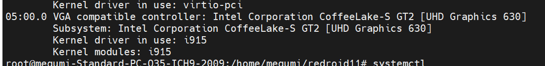

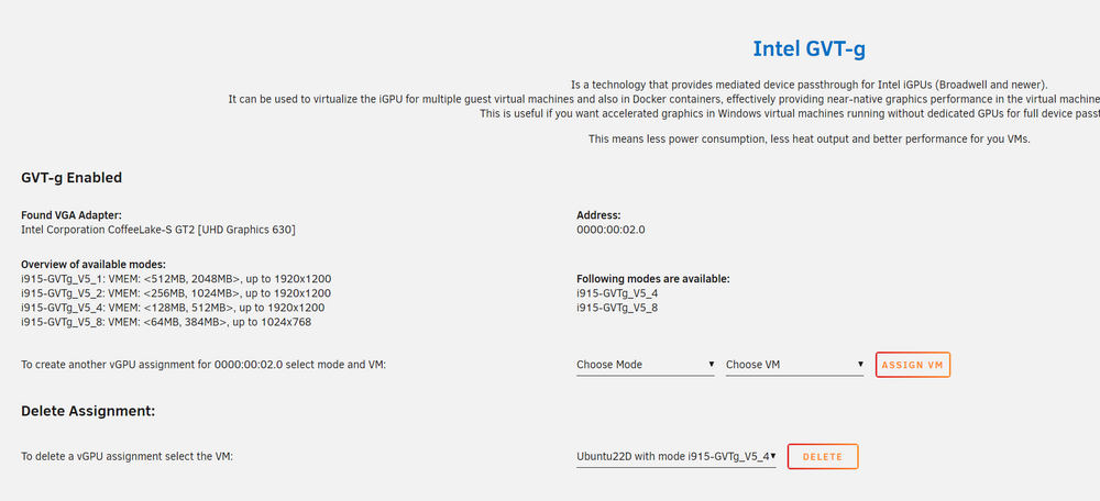

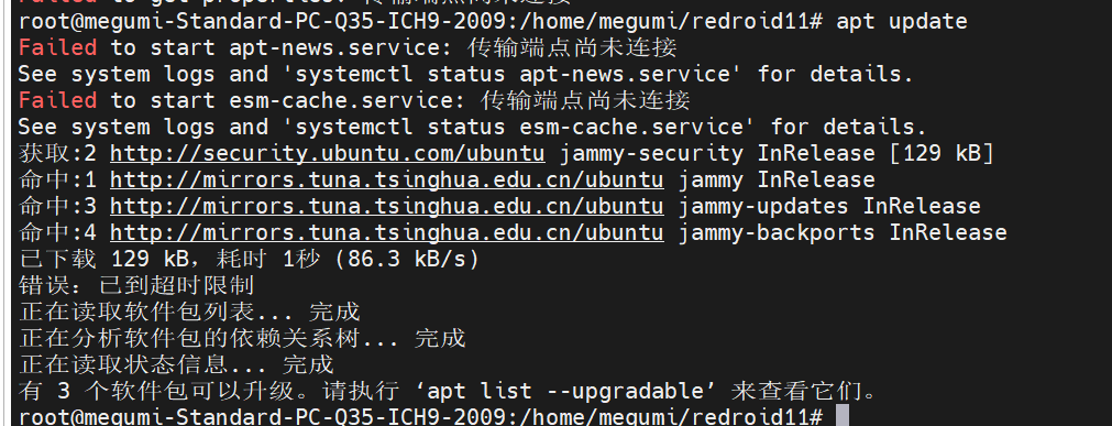

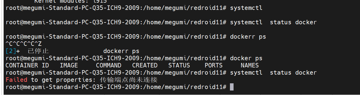

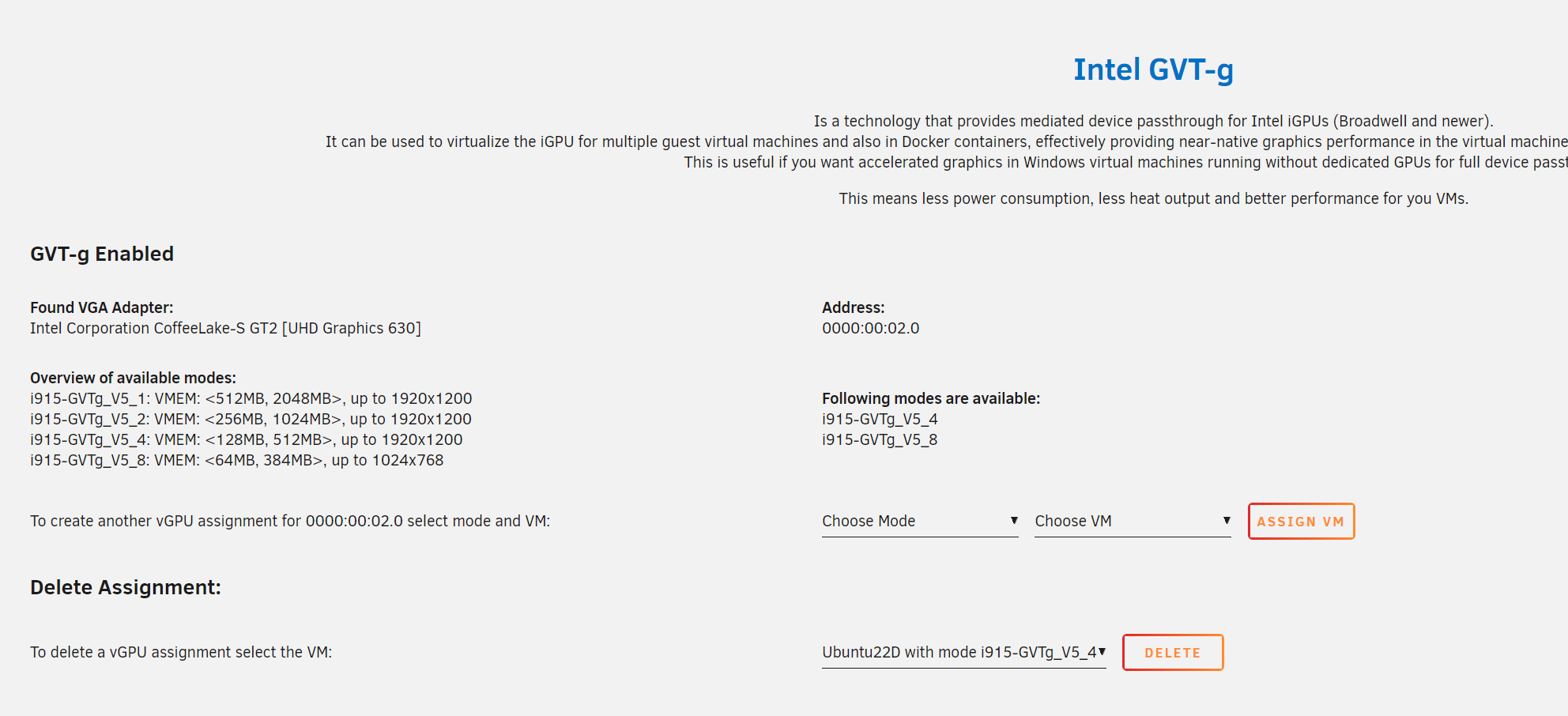

  8. unraid version 6.12.6/6.12.10 ubuntu version 22.04 desktop cpu 8100t Only docker is installed in ubuntu. After booting, all commands are executed normally, but after about 5 minutes, systemctl, apt, reboot, shutdown and some other commands will be stuck and report error: Transport endpoint is not connected,after deleting the gvt-g settings, everything is normal。 Can anyone help me? Thanks gvt-g setting: vm setting: lspci: error: “传输端点尚未连接“ is "Transport endpoint is not connected"
  9. unraid版本 6.12.6 ubuntu版本 22.04 desktop cpu 8100t ubuntu中只安装了docker,开机后,所有命令执行正常,大约5分钟以后systemctl、apt、reboot、shutdown和一些其他命令会卡死并报错,当把gvt-g的集显设置删除以后,一切都很正常。有没有大佬知道问题的原因或者协助排查一下 gvt-g设置: 虚拟机设置: 开机后正常识别集显: 报错截图:
