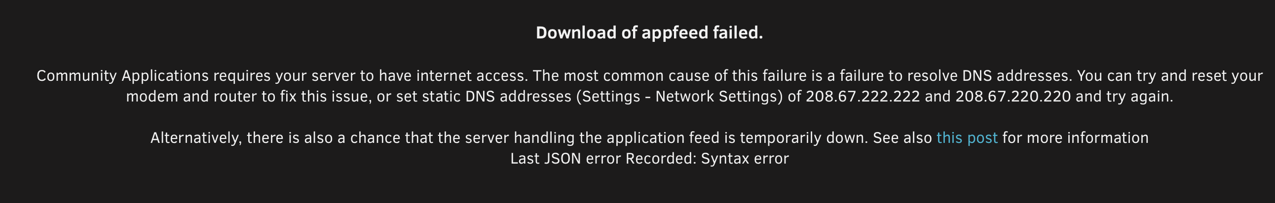

  4. Hey, after update to 7 seems to have million issues. If Tailscale is enabled, Unraid cannot access web, and neither can Docker containers (although they are separated now, no?). Also seems to have a lot of routes under network settings - is this normal?
  5. Hey All, I've just updated to 7 and have the same issue. It seems to be caused by Tailscale (which I used and worked ok on 6.10). I disabled DNS from Tailscale and added it to the settings with no avail. Disabling Tailscale seems to work.
