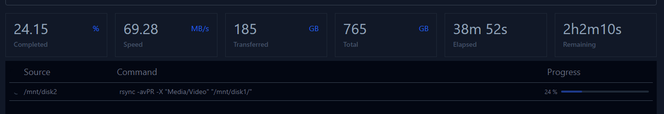

  7. Ok, As per advice, i have installed Unbalanced plugin and started transfer. Thanks everyone for advices, comments etc. One more question. How does statistics look to you as per attached picture? Parity drive is 8T SAS and 8T (Disk1)and 4TB (Disk2) drive is SATA. Best Regards, Tim
