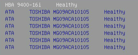

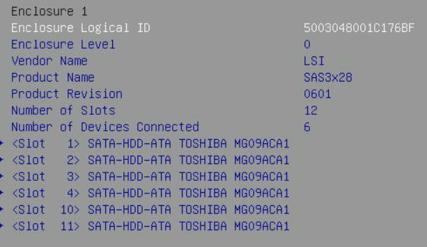

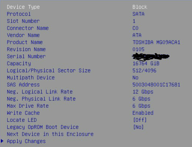

It looks like "Refresh Topology" in the HBA BIOS solved the problem. (https://www.h3c.com/en/d_202207/1655193_294551_0.htm#_Ref533597481) Since that action I have done a lot of heavy writing operations on the system without increase in UDMA CRC Errors on any attached disk. Operations run so far: Rebuild of parity moving 17,5 GB of Data from single disk (new disk6) to Array (Array emulating disk1). preclearing disk1 and adding it to array with rebuild of its contents

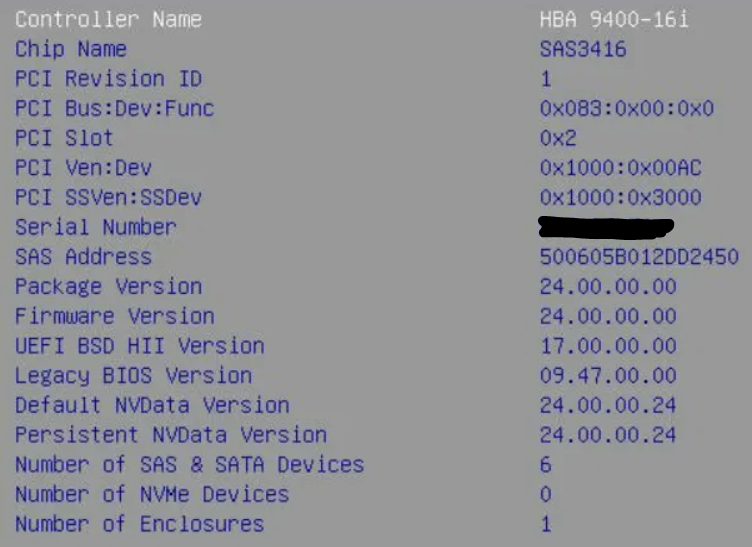

Strangely the system is running fine currently. Only thing I did was to gather the HBA information in the BIOS. Since that I do not see any increase in UDMA CRC Errors on the disks and the preclear is doing fine. I did see strange behavior of smartctl in the preclear (18TB TOSHIBA MG09ACA18TE disk): Oct 20 22:14:15 preclear_disk_SN_6258: Preclear Disk Version: 1.0.30 Oct 20 22:14:16 preclear_disk_SN_6258: Disk size: 18000207937536 Oct 20 22:14:16 preclear_disk_SN_6258: Disk blocks: 4394582016 Oct 20 22:14:16 preclear_disk_SN_6258: Blocks (512 bytes): 35156656128 Oct 20 22:14:16 preclear_disk_SN_6258: Block size: 4096 Oct 20 22:14:16 preclear_disk_SN_6258: Start sector: 0 Oct 20 22:14:21 preclear_disk_SN_6258: Pre-read: pre-read verification started 1 of 5 retries... Oct 21 02:36:48 preclear_disk_SN_6258: Pre-Read: progress - 25% read @ 277 MB/s Oct 21 07:23:18 preclear_disk_SN_6258: Pre-Read: progress - 50% read @ 246 MB/s Oct 21 12:59:07 preclear_disk_SN_6258: Pre-Read: progress - 75% read @ 198 MB/s Oct 21 20:39:07 preclear_disk_SN_6258: Pre-Read: elapsed time - 22:24:43 Oct 21 20:39:07 preclear_disk_SN_6258: Pre-read: pre-read verification completed! Oct 21 20:39:08 preclear_disk_SN_6258: Zeroing: zeroing the disk started 1 of 5 retries... Oct 21 20:39:08 preclear_disk_SN_6258: Zeroing: emptying the MBR. Oct 22 01:00:29 preclear_disk_SN_6258: Zeroing: progress - 25% zeroed @ 278 MB/s Oct 22 05:46:46 preclear_disk_SN_6258: Zeroing: progress - 50% zeroed @ 244 MB/s Oct 22 11:21:50 preclear_disk_SN_6258: Zeroing: progress - 75% zeroed @ 201 MB/s Oct 22 19:01:35 preclear_disk_SN_6258: killing smartctl with pid 26573 - probably stalled ... Oct 22 19:01:35 preclear_disk_SN_6258: Pause (smartctl run time: 34s) Oct 22 19:01:35 preclear_disk_SN_6258: Paused Oct 22 19:01:56 preclear_disk_SN_6258: killing smartctl with pid 26573 - probably stalled ... Oct 22 19:02:18 preclear_disk_SN_6258: killing smartctl with pid 26573 - probably stalled ... Oct 22 19:02:40 preclear_disk_SN_6258: killing smartctl with pid 26573 - probably stalled ... Oct 22 19:03:02 preclear_disk_SN_6258: killing smartctl with pid 26573 - probably stalled ... Oct 22 19:03:23 preclear_disk_SN_6258: killing smartctl with pid 26573 - probably stalled ... Oct 22 19:03:45 preclear_disk_SN_6258: killing smartctl with pid 26573 - probably stalled ... Oct 22 19:04:07 preclear_disk_SN_6258: Resumed Oct 22 19:04:09 preclear_disk_SN_6258: Zeroing: zeroing the disk completed! Oct 22 19:04:10 preclear_disk_SN_6258: Signature: writing signature... Oct 22 19:04:12 preclear_disk_SN_6258: Signature: verifying Unraid's signature on the MBR ... Oct 22 19:04:13 preclear_disk_SN_6258: Signature: Unraid preclear signature is valid! Oct 22 19:04:14 preclear_disk_SN_6258: Post-Read: post-read verification started 1 of 5 retries... Oct 22 19:04:14 preclear_disk_SN_6258: Post-Read: verifying the beginning of the disk. Oct 22 19:04:14 preclear_disk_SN_6258: Post-Read: verifying the rest of the disk. Oct 22 23:26:41 preclear_disk_SN_6258: Post-Read: progress - 25% verified @ 273 MB/s Oct 23 04:13:16 preclear_disk_SN_6258: Post-Read: progress - 50% verified @ 248 MB/s I will get back with updates.
