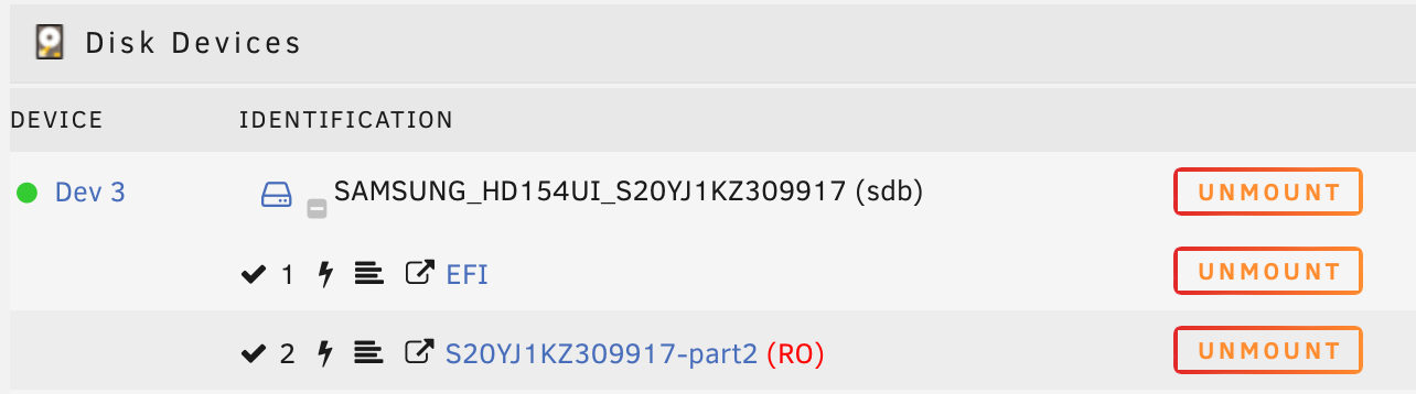

Hi all, thanks for this great plugin @dlandon. I'm trying to understand the following… The drive in the picture is an APFS (Apple File System) drive mounted via UD+. The partition with all the data (I notice this with all macOS formatted APFS drives) is Read Only. I presumed (maybe incorrectly) that UD+ could mount APFS in R/W mode. - Can Unnassigned Devices Plus mount APFS in R/W-mode? If not, all clear. - If it should be able to mount the drive in R/W I'm wondering what could cause the RO lockup and how to solve this. Note that I have not set RO in the drive's preferences. - Does anyone know what the EFI partition means and why it's there? I've never seen this on my macOS system. Thanks a lot, Jan
