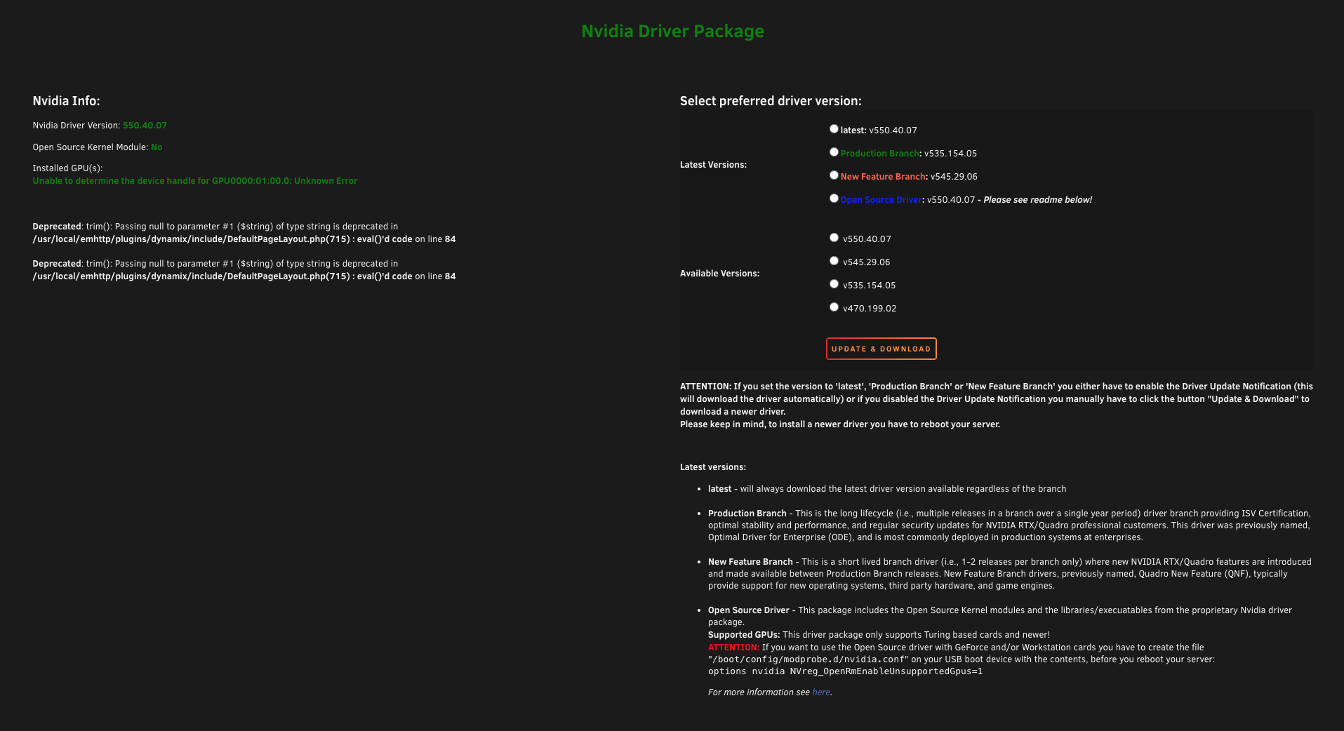

  2. For some reason the GPU card shows when I boot, and then it falls off the system. I caan't see the card details in the nVidia driver section, and I can't see. it in the GPU Statistics plugin. Am I doing something wrong, or is it a bad gpu? What is another alternate GPU you would recomment that won't break the bank?

  5. I do also notice that I get a failure on the GPU plugin in Unraid on occasion. Do I need to disable the onboard video now that I am running the Tesla P4?Or do I have a bad GPU as well?

  13. I went to the bash command and made sure all appdata / domains / system shares were moved to the cache using: rsync -av --remove-source-files /mnt/disk2/appdata/ /mnt/cache/appdata/ It moved all files. I then removed all empty folders left behind: find /mnt/disk2/appdata/ -type d -empty -delete I corrected appdata folder permissions: chmod -R 755 /mnt/cache/appdata/ chown -R nobody:users /mnt/cache/appdata/ I made sure that the appdata / domains / system shares were all now cache only in my shares menu. I made sure that the data & iCloud-drive-sync shares were all now pointing to array in my shares menu. I reloaded the nvidia driver, and installed the gpu statistics plug-in. I removed changed the macvlan to ipvlan. I have checked the cache pool and It's still pretty full (I think). I have a 2tb ssd and a 256GB ssd. Do I need a larger cache pool? What am I missing? And before I forget, huge thanks to trurl & JorgeB for all your help. I really appreciate the time you are taking!
