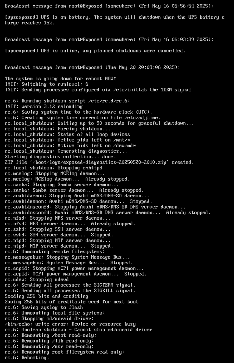

  1. Update on my end too. While updating to 7.0.0 and above solved my issue (will not boot unless I remove power from the computer all together), It did not entirely solved it. From time to time, my unraid won't boot, showing the same issue with USB devices as previously. Soft reboot don't solve this, I still have to unplug the power from the power supply for some seconds, then plug-in back in. Sometime this won't be enough though, so repeating this procedure will at some point, work. Fortunately it only happen once every 5 reboot i'd say. Honestly I think my motherboard is the issue here. BIOS is up to date ofc, I check almost every month.
  2. Thanks @JorgeB ! You are always so quick to answer! I will do that. EDIT: Probably will confirm, but this is the CLI output from me restarting Unraid.
  3. Hello, It happened a few times and I did not think much of it and just restarted the server (very uncleanly because the "normal" shutdown wouldn't work), but I think my server has a deeper issue: The server seems in a limbo states randomly where everything seems to works and not work at the same time. Most dockers seems responsive when I reach their web UI, others are not. The Docker tab in Unraid UI says "Docker Service failed to start." but in a weird way. Unraid UI is not updating the dashboard, but I can navigate the menus fine. Here is my diagnostics attached that I could download from that exact state. Would anyone knows why? Is it a memory issue? Thank you! exposed-diagnostics-20250520-1942.zip

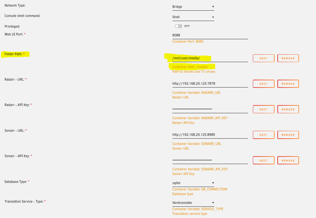

  5. Hi dglb99, quick question to you as the maintainer of the unraid template : updating a working seafile 11 to 12 will not work as is right ? I've read the seafile provides a script to facilitate this update, but I fail to understand how to run that inside my running container, then pushing changing the "11" to "12" tag. Is it something you can add to the template ? like to sort of Yes/No "I'm want to update from seafile 11" ?
  6. Yes it replace /app/media/movies and shows. I've removed them from the template and replaced them with what I shown in my screenshot, and now Lingarr is correctly working. I noticed that the paths were invalid when I saw the amount of lines in the logs that showd errors "not found" with the location path being "/media/movies/name of movie" instead of what I expected to see considering the OG template which was "/movies/name of movie" directly. The issue were all settings (radarr/sonarr adress, API, etc) disapears with stoping/starting the docker is still going strong. I haven't made any progress on this. PS: i'm on Unraid 6.12.15
  7. I just want to provide an info for the LINGARR app : Because lingarr dev's have changed the way it internally map, you now need to map the /media/ folder of the docker to your own /media/ folder in your unraid. Otherwise Lingarr doesn't work at all. Hopefully your /media/ folder contain your movie folder AND tv show folder. If not, i'm not sure if it will work at all. Also, all the field for the URL and API key of the ARRs, and also translation services don't work and you will need to complet them inside of lingarr. Note that each time the app is restarted, all of this if forget for some reason. I suspect an issue with the way data is stored.
  8. Just an update for my case (Nothing worked, fast boot or such, systematically unraid won't do a reboot. I have to remove power from the server and plug-it back): Updating to UnRaid 7 fixed fully this boot issue.

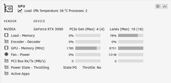

  10. Sorry I don't think I tagged you properly. I want to add something : I was messing around with my network, and during some movin arround my switches connection, the icons came back for a few second. Next refresh : gone. Maybe this issue isn't related at all with your plugin... I didn't manage to reproduce when I messed up with my local network and the icon showed up randomly.
  11. @SimonF result of gpujson while Plex was running : I want to add something : I was messing around with my network, and during some movin arround my switches connection, the icons came back for a few second. Next refresh : gone. Maybe this issue isn't related at all with your plugin...
  12. I just did that : Remove the plugin, check that it is correctly removed, rebooted the server, reinstall the pluging. Unfortunatly, it is still not working as expected. Whatever happens next, I just want to thanks you for the time spend troobleshooting this minor issue with me!
  13. Well ok. What can I do? Uninstall/Reinstall? Provide more logs or information?
  14. output.txtSure, here you go.

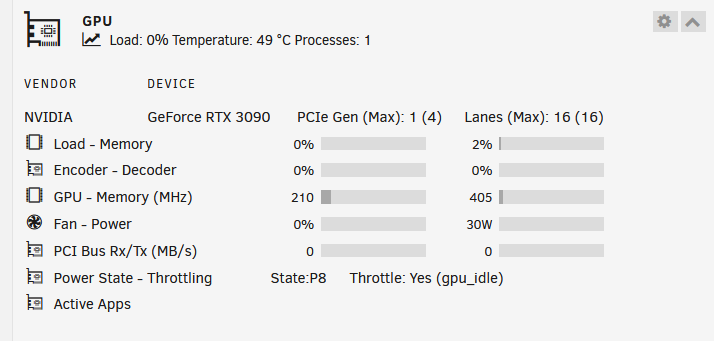

  15. Hello, Since a few weeks, the "Active Apps" section doesn't show anything when the GPU is being used. It was working fine, but now doesn't. Is this something fixable? GPU not being used: GPU being used: Thank you! exposed-diagnostics-20250309-2017.zip
