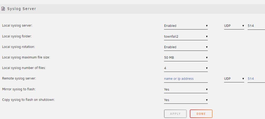

  11. As of now, I have enabled the syslog server. I think this set option will be sufficient; townfall2 is in my shared array. Remote syslog server is additionally set to my unraid server's IP. Unfortunately, this solution does not work when I have to manually restart the server.
