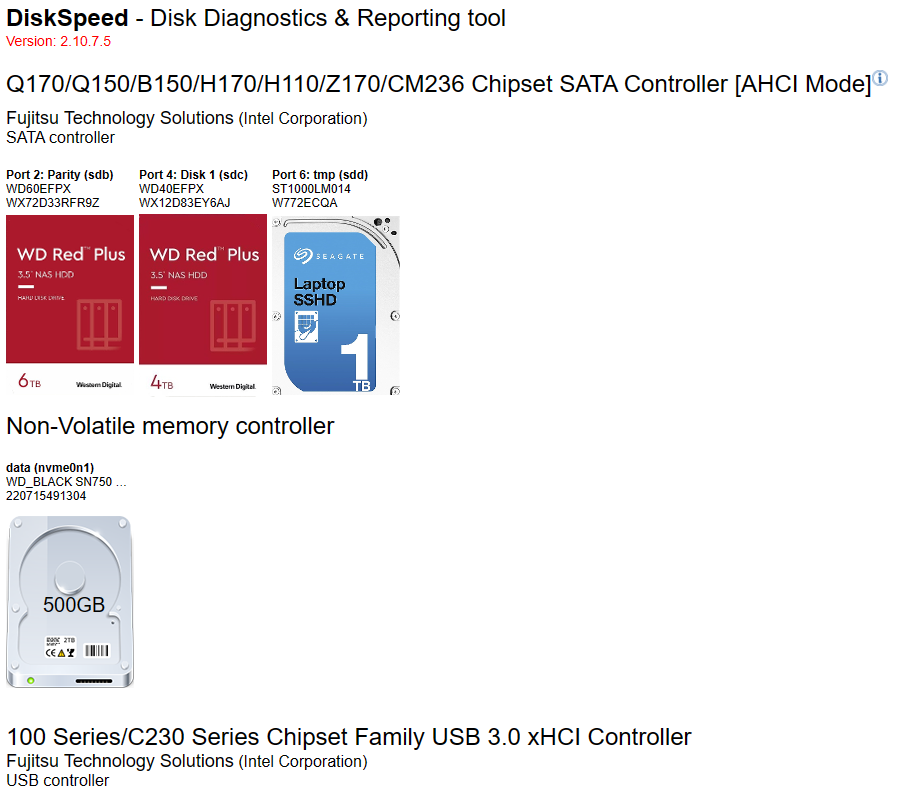

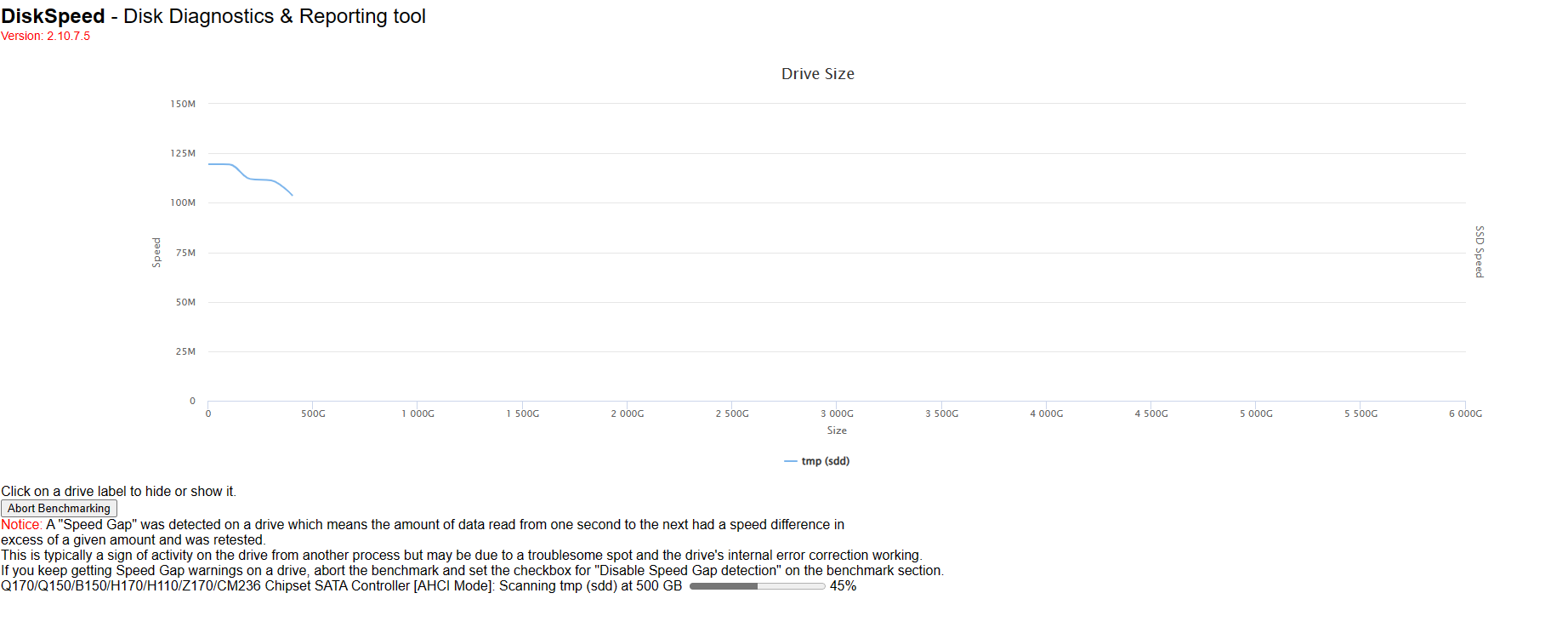

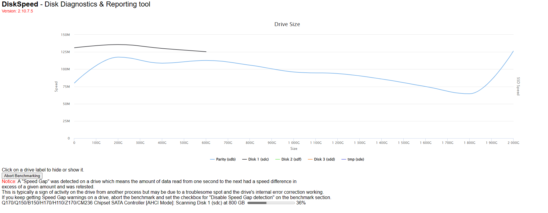

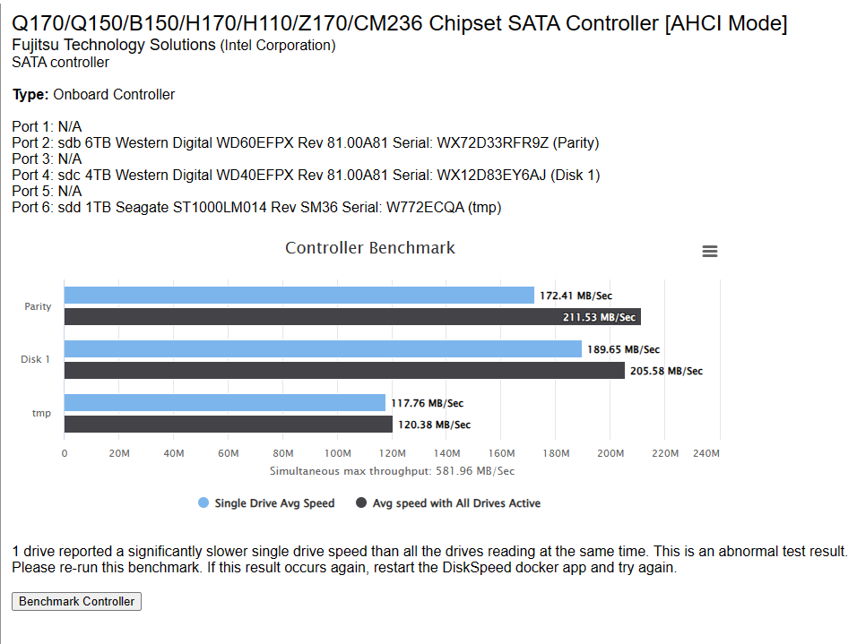

  10. I have sent you the debug file. I also have an update. When I started a full benchmark on all disk, on my main unRAID server, the WD Red Plus disks are not taken into the benchmark. On my backup unRAID server, where I don't have any WD Red Plus drivers, the benchmark takes all the disks. I suppose it has something to do with these disks. Also, testing the controller seems to see all disk (including the WD Red Plus ones).

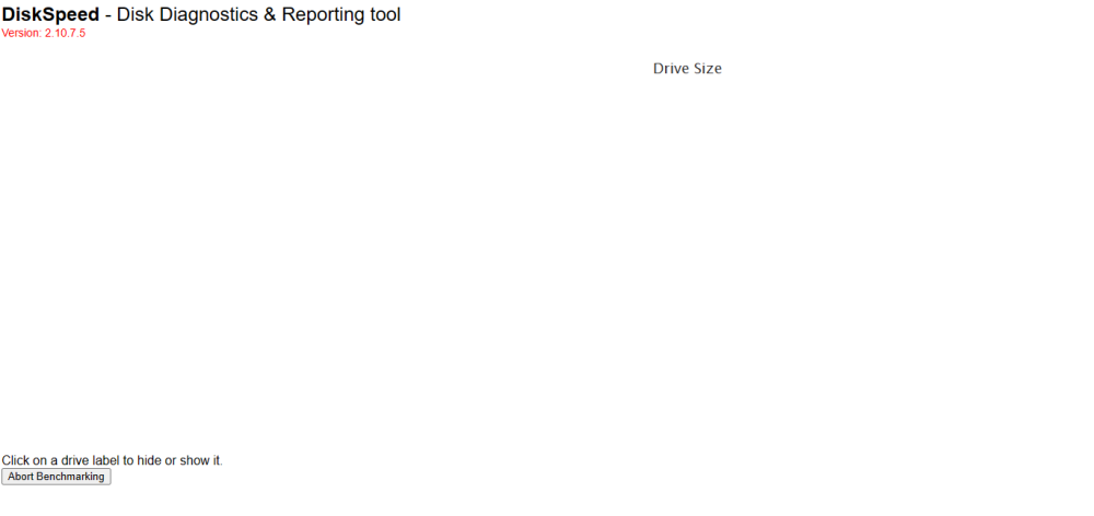

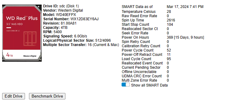

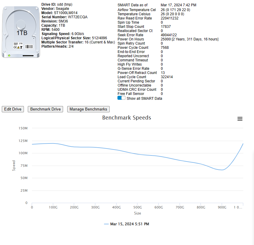

  12. I am trying to benchmark one of my HDDs from my array and I get a blank page. Also, in the browser console I can see this error Benchmark.cfm:166 Uncaught TypeError: Cannot read properties of null (reading 'style') at CheckForFinished (Benchmark.cfm:166:42) at Benchmark.cfm:173:1 My HDD is a WD WD40EFPX Any reason why this is happening? I tried with an old HDD that is not part of the array and it worked fine. I am using Version: 2.10.7.5 Thanks!
