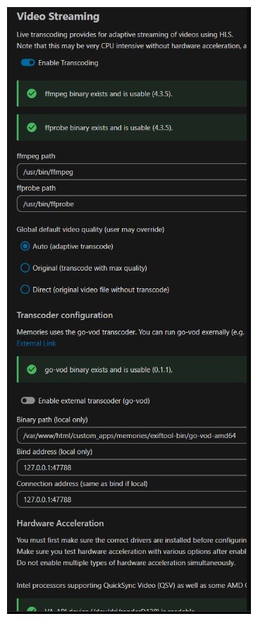

  9. i have found the memories settings. Looks like i am getting only a couple of errors. Please let me know if these would cause me to not have thumbnails or how i can resolve them. - `Database triggers not set up; trigger compatibility mode in use. See the documentation for information on how to resolve this. External Link` Sorry for being a pest, i have worked alonggggg time on this and i think, even my wife, is ready for me to be done Thanks Kilrah!
  10. Hello Kilrah! I have downloaded your repo (plugin) for Nextcloud with FFmpeg and i am loving it! Finally got it all configed. I have researched and researched on how i can get it to display the video thumbnails, and i just can't get it. it's driving me nuts! PLEASE help me out! I have my cron jobs up and running every 15 min. Please let me know any other details you might need. i have edited my config PHP to add the enable preview, I've downloaded the preview generator app, etc.. Also, how are you getting to this area attached?
