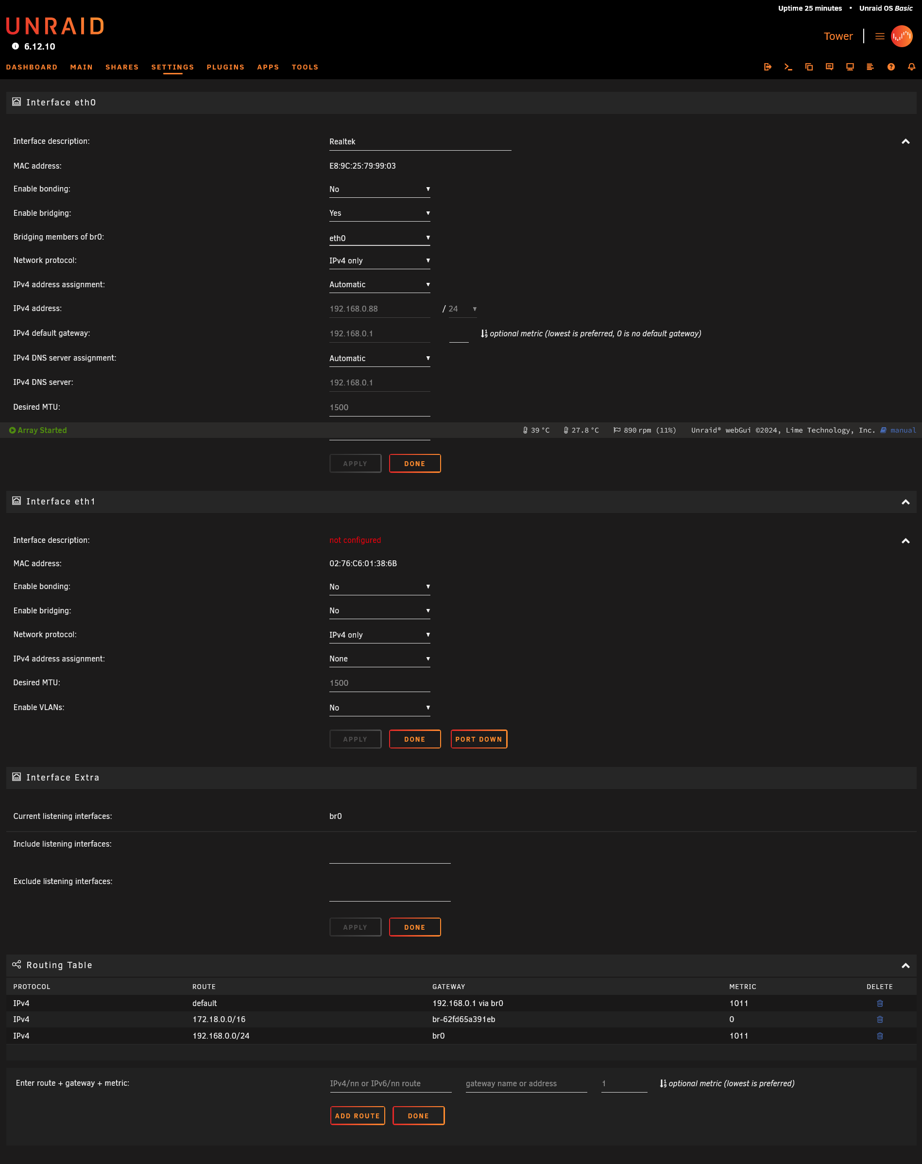

PCIe NIC is not visible in Unraid when motherboard NIC is disabled in Bios
My motherboard has only one pcie slot :(, I must live with Realtek and maximum C3 state
Ok I did like you said, after that I disable realtek in bios and remove network.cfg. No I see Device eth0 does not exist and igc: probe of 0000:02:00:0 failed with error -13
Should I run "append pci=realloc=off initrd=/bzroot" in Unraid console?
Hi all, I bought PCIe NIC Intel i226 for replacing Realtek that is on my motherboard. When I disable Realtek NIC in Bios Unraid doesn't see any NIC, I see error that there is no eth0. When I leave realtek NIC enabled in Bios, Unraid see two cards and after reboot randomly pick eth0 us Intel or Realtek. How to force Unraid to use only pcie nic and do not use motherboard nic? I want to switch to intel beacuse realtek prevent higher C states. diagnostictower-diagnostics-20240417-0955.zip
Bought new NIC, how to change eth0 to use it?
When I disable Realtek NIC in BIOS Unraid doesn’t see any eth

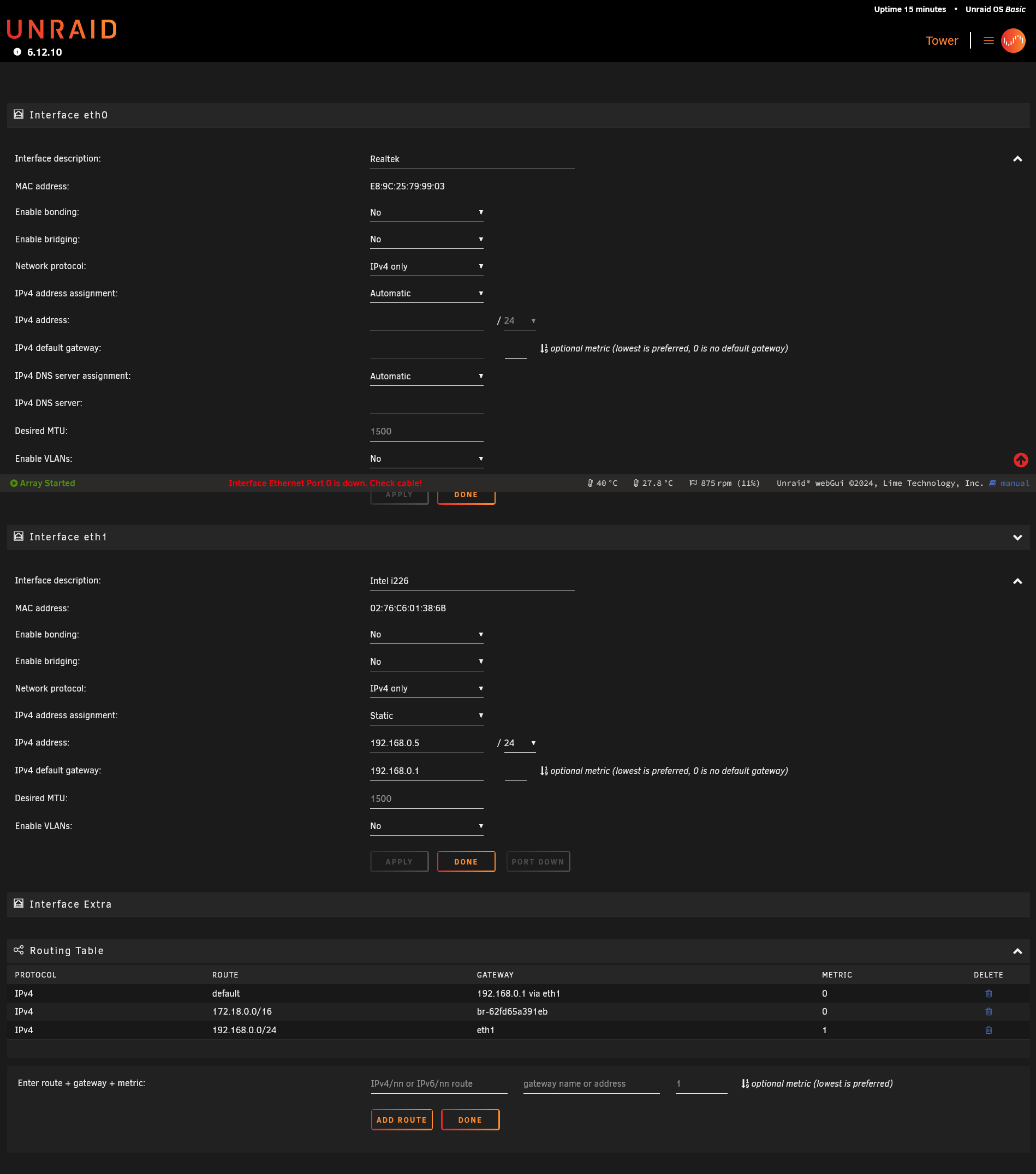

Thanks JorgeB for fast response. I connect both NIC with router and now settings looks like this: Still I want to remove Realtek and make Intel my default NIC
Hi all, My motherboard has Realtek NIC buldin, I want to disable it in bios and use only Intel i226-v that I connect in pcie. How to change unraid setup to make Intel NIC default and disable Realtek?
Replace build-in Realtek NIC
Hi all, My motherboard has a built-in Realtek chipset which causes blocking of higher processor C states. I intend to buy a PCI network card, I don’t know which one will better cooperate with Unraid, I care about the best possible compatibility, should I choose Intel i225-v b3 or Intel i226? I226 https://a.aliexpress.com/_EjHJPMT I225 https://a.aliexpress.com/_ExxT7s7 or maybe I should choose something else? I don’t need 2,5gb because my network is 1gb

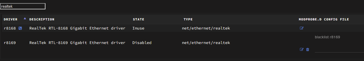

[Plugin] Realtek R8125 R8126 R8168 and R8152\6\7 drivers
Everything was enabled (last image) after install this plugin the version of driver is different r8168 vs r8169 is it ok?

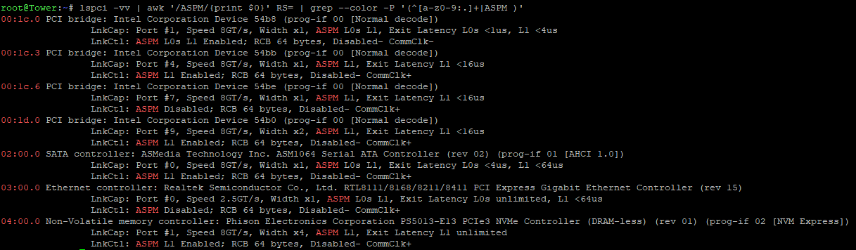

Reduce power consumption with powertop
everybody with Realtek network card like me, try to run this command to force aspm: echo 1 | sudo tee /sys/bus/pci/drivers/r8169/0000\:0*\:00.0/link/l1_aspm replace 0* with your card id after this I am reaching C8 and everything has aspm: enabled
