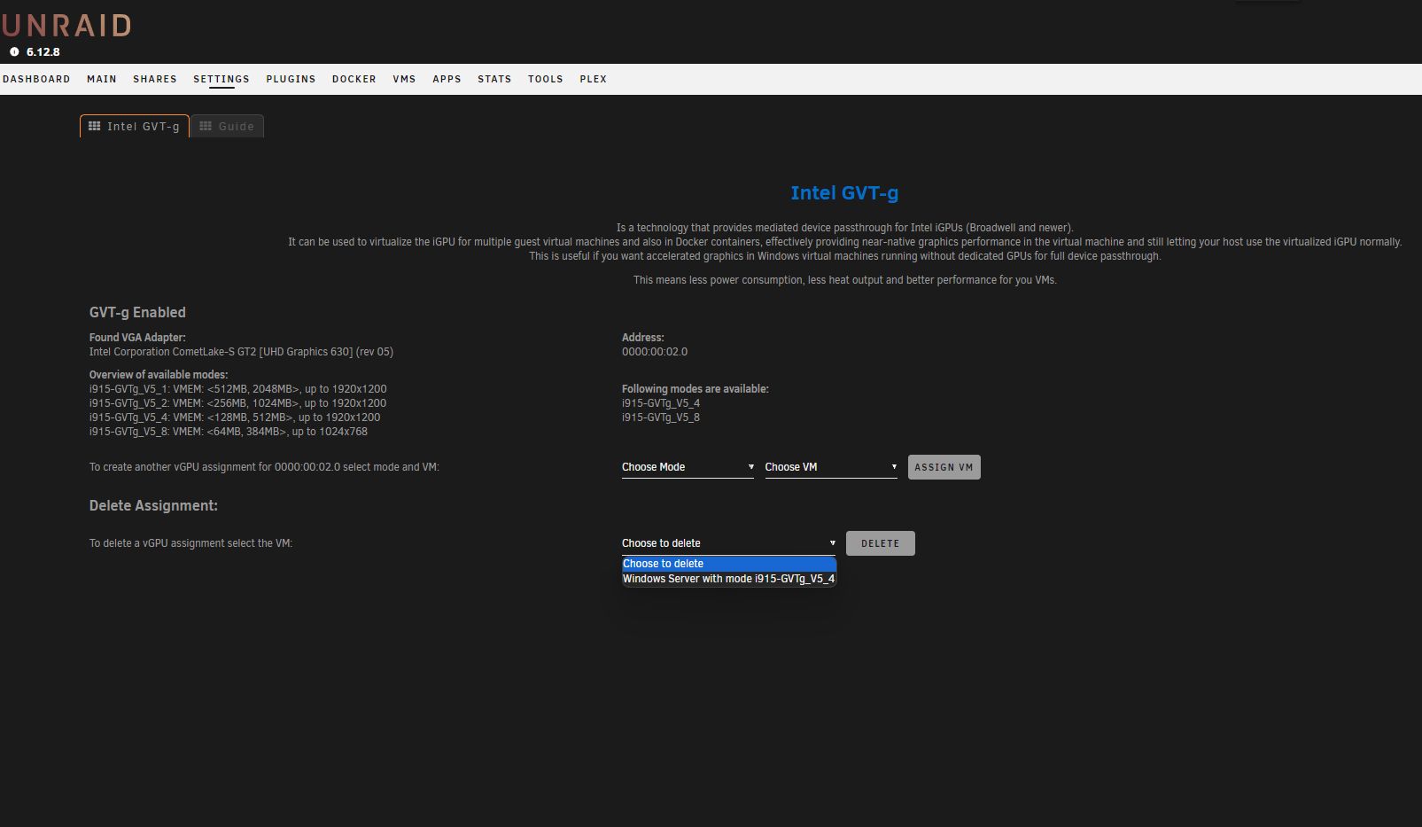

  8. Thanks. Edited post.
  9. Hello, I have an Intel I7-10700K. I have followed all the directions as closely as I could. Asus Bios: IGPU is set as primary in Asus bios, and multimonitor is enabled. I do have a Nvidia Quadro P4000 installed as well. UNRAID: VFIO not binded to any VFIO Windows Server 2022: Machine Type: q35-7.2 BIOS: SeaBIOS Graphics Card: Intel UHD Graphics In the plugin, I have two modes available i915-GVTg_V5_4 i915-GVTg_V5_8 I've tried both mode but I'm getting device not found: mediated device '2a0ea9b5-b532-439d-a8a9-2ceb3ed8851b' not found. When I look in the syslog I'm seeing this. Unraid kernel: i915 0000:00:02.0: [drm] *ERROR* conflict detected with stolen region: [mem 0x3f800000-0x7f7fffff] Unraid kernel: i915 0000:00:02.0: Direct firmware load for i915/gvt/vid_0x8086_did_0x9bc5_rid_0x05.golden_hw_state failed with error -2 Unraid kernel: debugfs: Directory 'gvt' with parent '/' already present! Unraid kernel: i915 0000:00:02.0: MDEV: Registered Unraid kernel: i915 0000:00:02.0: [drm] Finished loading DMC firmware i915/kbl_dmc_ver1_04.bin (v1.4) Unraid kernel: i915 0000:00:02.0: [drm] failed to retrieve link info, disabling eDP Unraid kernel: [drm] Initialized i915 1.6.0 20201103 for 0000:00:02.0 on minor 1 Unraid kernel: ACPI: video: Video Device [GFX0] (multi-head: yes rom: no post: no) 10:38:42 Unraid kernel: input: Video Bus as /devices/LNXSYSTM:00/LNXSYBUS:00/PNP0A08:00/LNXVIDEO:00/input/input13 10:38:42 Unraid kernel: fbcon: i915drmfb (fb0) is primary device 10:38:42 Unraid kernel: Console: switching to colour frame buffer device 240x67 10:38:42 Unraid kernel: i915 0000:00:02.0: [drm] fb0: i915drmfb frame buffer device Any help would be appreciated. diagnostics-20240307-1413.zip
