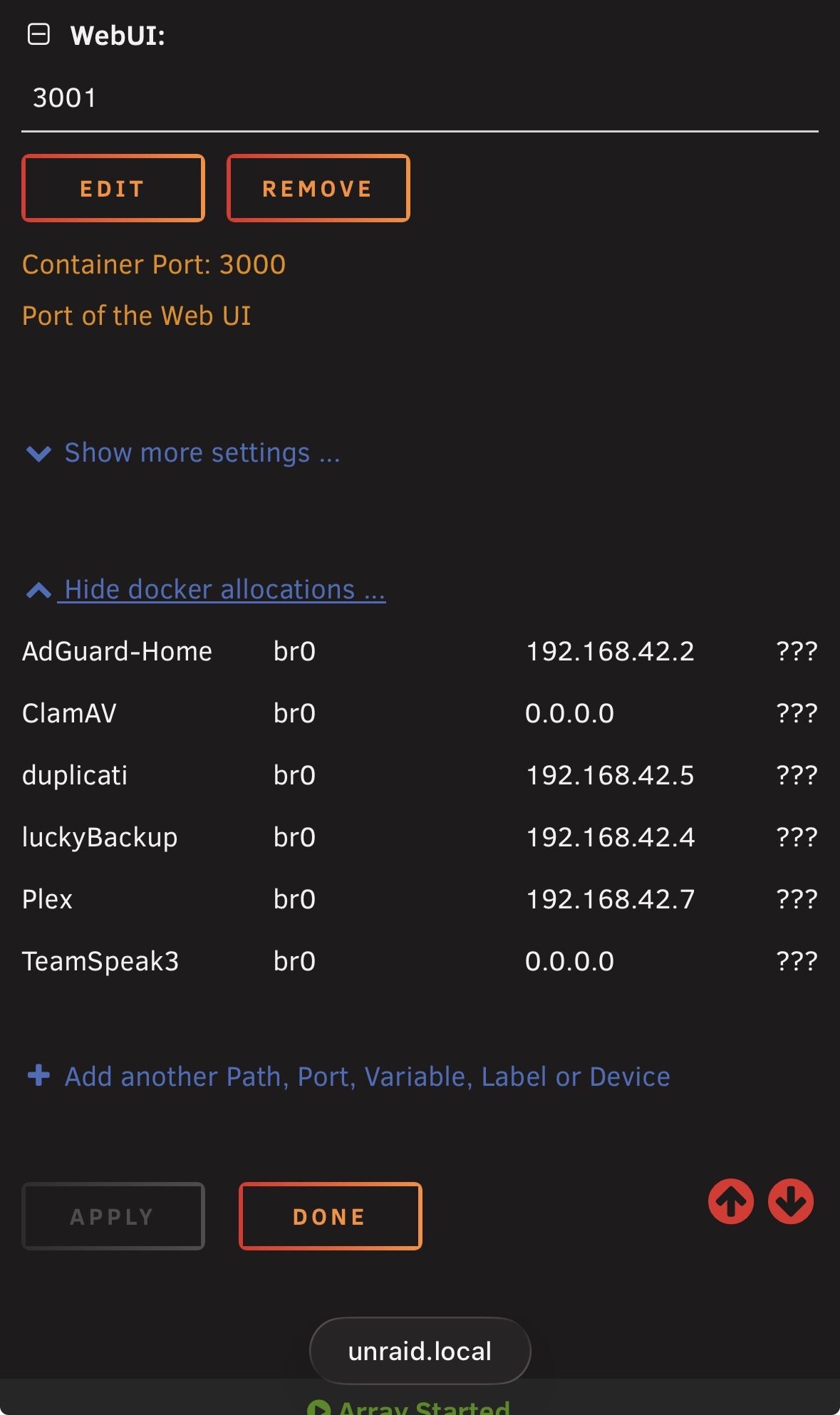

  7. Hi, All my docker running on br0. I thought for backup, adguard and clamAV I need br0. I‘m running the latest version of unraid 7.2.4 The Screenshot is showing a docker, when I expand the docker allocations

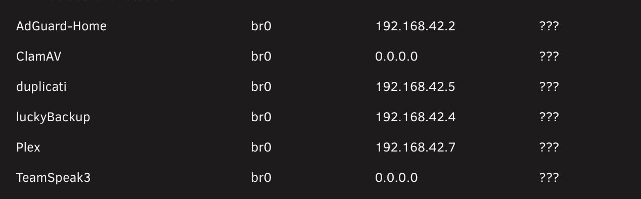

  8. I googled over the day and found this: Check Container Network Mode: If a container uses Host network mode, it does not use port mapping in the traditional sense, which can cause ??? to appear. Change the container to Bridge mode if you need to manage the ports, or accept that ??? is normal for host-mode containers. Cannsomeone verify this? Thanks Patrick
  9. Hi everyone, I don‘t know for how long, but I don’t see used ports allocated to my docker container. Any idea why? ClamAV and TeamSpeak are not running at the moment. Thanks in advance, Kind regards Patrick

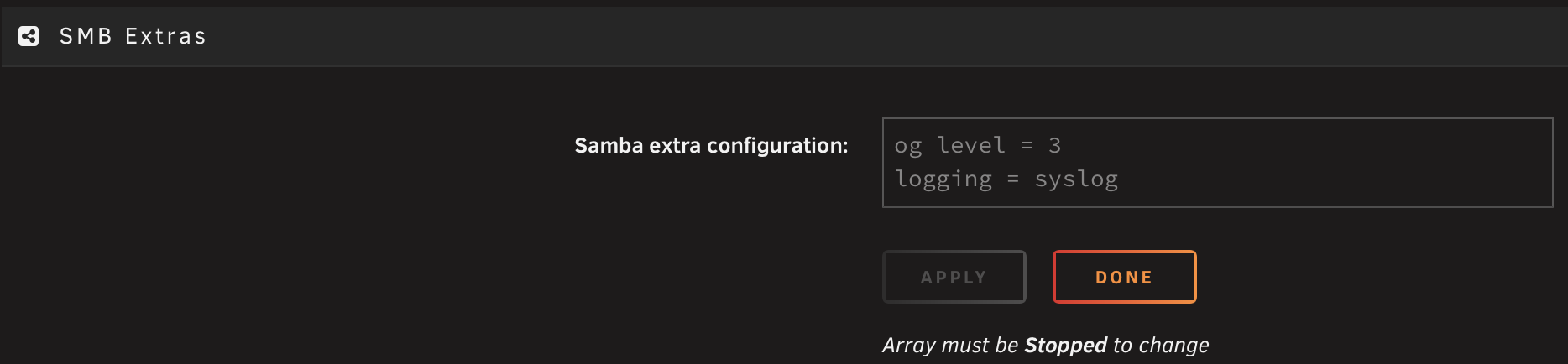

  11. Thanks a lot, that was the hint I needed. found this: I now remember why I enter this. Was for some old printer to scan to SMB share on my unraid. So next and hopefully last question, how do I clean up my /var/log folder?
  12. Ok. What is the smb-extra file? And how do I fix this?
