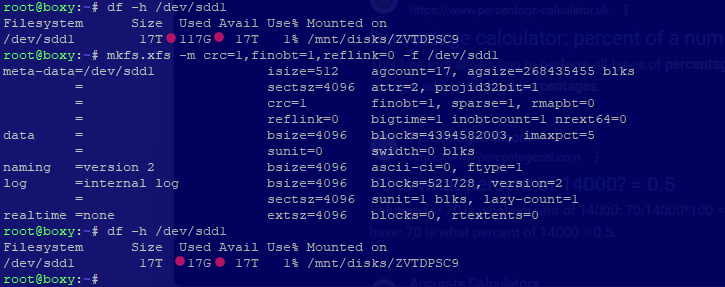

  8. This issue is WAY worse than I thought, 100GB of wasted space!! This is a brand new blank 18TB Exos X20, model ST18000NM003D. Formatted through Unassigned Devices, then from the CLI without reflink.

  11. Thanks for helping me chase this down. This is wasted filesystem overhead, they will not show with "du" or "ls". I've cited a source in my original post. I'm familiar with those XFS tools, how can they be applied here?
  12. Thanks for your reply, I see you have the reflink "stolen" space. The missing space is subtracted from the "SIZE" column of your screen shot of your spinning drives. It's wasted file system overhead.
  13. OK, so this is a known issue. Looks like reformatting is required to reclaim the space. I imagine Unraid is using the defaults. As there's no use case (that I'm aware of) for reflink/COW support this might be a bug.
