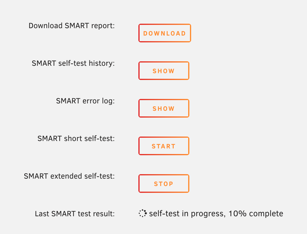

  4. Thanks! The extended SMART test ran. I had to reboot it and shutdown and start it quite a few times for the disk to appear again. However, it has been detected. Sadly, its been stuck on `self-test in progress, 10% complete`.valkyrie-smart-20250414-1330.zip valkyrie-diagnostics-20250414-1333.zip

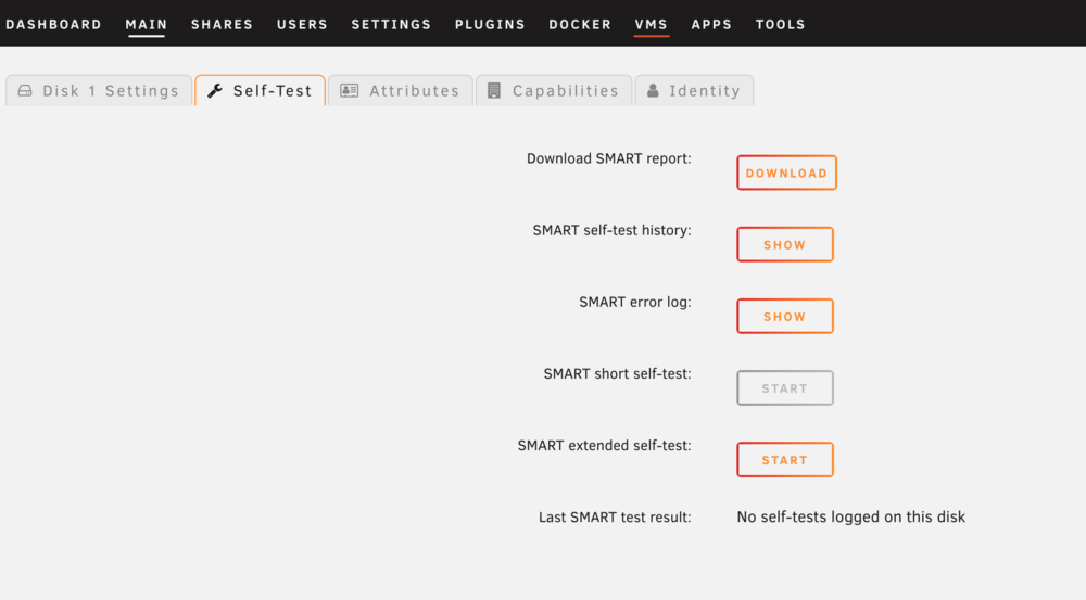

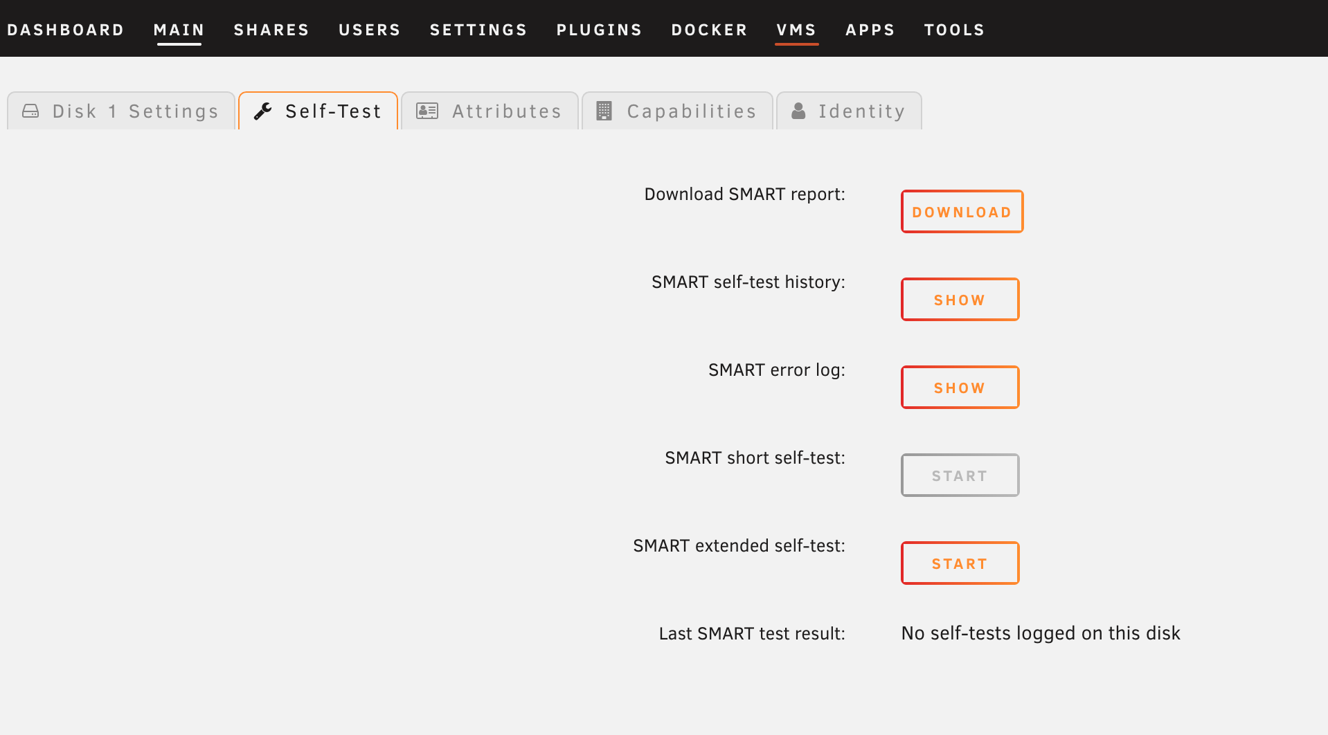

  6. Screen Recording 2025-04-14 at 10.00.19.mov When attempting to run an extended SMART test, the button just goes back to `start` and doesn't actually do the test. The spindown time is set to never.

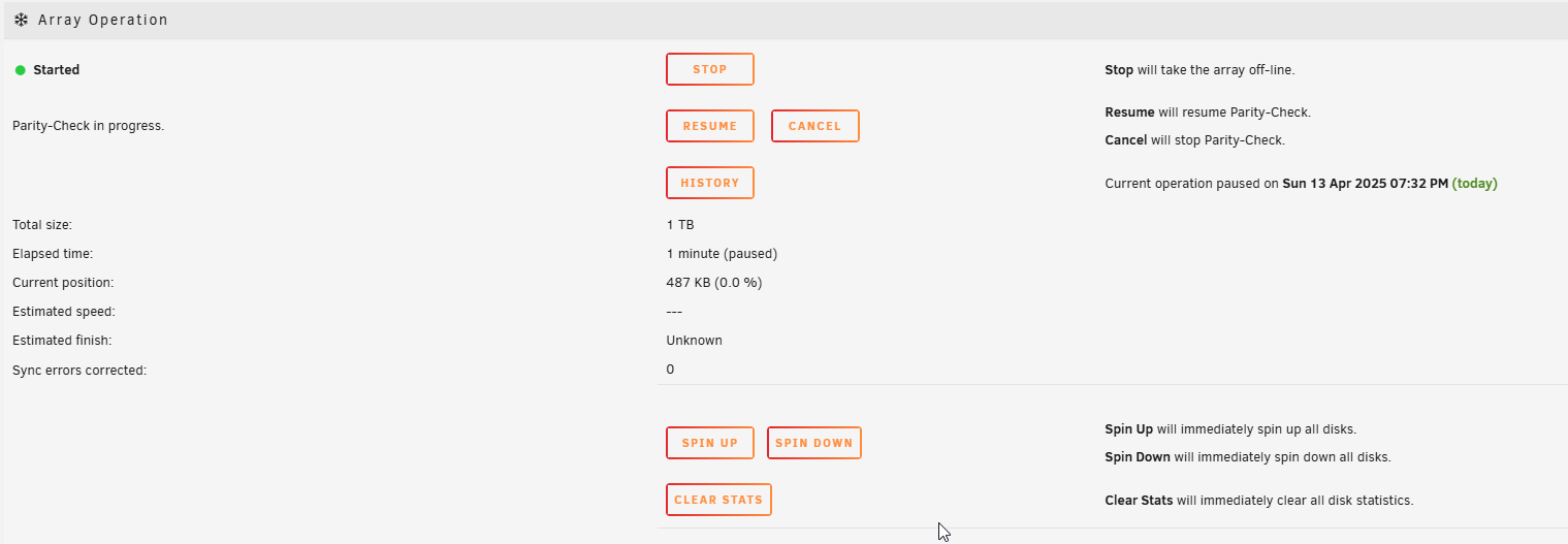

  7. When I press the array start button, this is what happens:

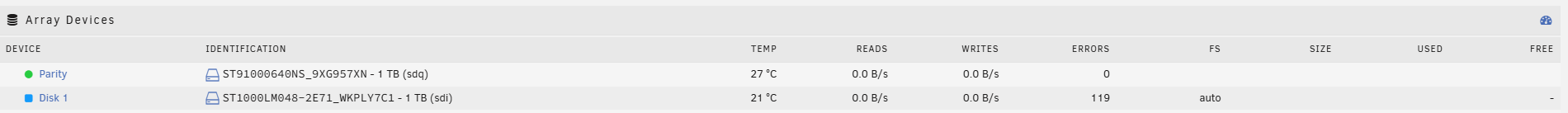

  9. Hiya Unraid Wizards! I've got a quick question here. So I purchased a used hard drive recently, and just got around to putting it in today. However, the drive seems to be erroring/not being detected by unraid. When installing, I went through the usual process, and it showed up in `main` as unallocated (great!), so I assigned it to a slot, and started the array. After 8 seconds, it stopped due to 137 errors. I thought that was weird so I took the drive out and moved it to a new slot in my server, with sadly a similar error appearing again. I gave it a restart, and now it's not detecting the drive at all. I was wondering if any of you knew wether the drive is just busted, or I've done something wrong? I've attached my diagnostics below, it's the Seagate ST1000.valkyrie-diagnostics-20250413-1839.zip Thanks everyone!
