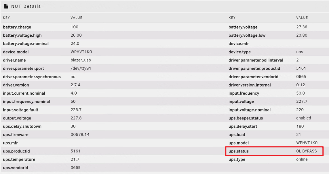

  4. I asked the manufacturer. 1, They responded with some instructions for ECO mode, which works like a backup-UPS, but with a little difference. When the input voltage meets the set range (for example 220v±5v), it directly outputs 220v±5v, the rectifier and inverter are not working but are standby, which can save energy and reduce heat generation. When the input voltage exceeds the set range, (for example 230v), the inverter works to provide stable pure sinusoidal 220v AC power output with a conversion time of 0ms. When there is a power outage, the inverter works and is powered by the battery, outputting 220v AC power with a conversion time of 1.8ms (< 4ms). 2, The manufacturer responded with some instructions about ups.status. ups.status OL means Online mode ups.status OL BYPASS means ECO mode ups.status OL CHRG means Online mode, charging ups.status BYPASS means Bypass mode ups.status OVER BYPASS means Bypass mode, overloaded ups.status OB means Battery mode ups.status LB means Low battery .... Personally, Saves energy reduces heat and fan noise are more important for me than the stable pure sinusoidal AC output. so I choose to use Eco mode. I was confused why they chose to use "OL BYPASS" for their ECO mode. Anyway, as long as it works normally, this warning doesn't matter. Thanks again.
  5. Hello, thanks to the greate plugin, Network UPS Tools (NUT) for UNRAID, works well. And I have a small question to ask. My UPS has 6 modes listed here: Online mode When the input voltage is within the allowable range, the inverter works to provide stable pure sinusoidal AC power output and charge the battery at the same time. In the event of a power outage, the switching time to battery power is 0ms. ECO mode When the input voltage is within the set voltage range, the UPS will switch to bypass mode to achieve energy saving. In the event of a power outage, the switching time to battery power is <4ms. Frequency Conversion mode When the input frequency is within the set allowable range, the UPS can set the output frequency to 50Hz or 60Hz, and the UPS will charge the battery at the same time. Battery mode When the input voltage is abnormal or there is a power outage, the UPS switches to battery mode and the buzzer sounds once every 4 seconds, and the UPS will be powered by battery power. Bypass mode When the UPS is operating in online mode and is overloaded, if the input voltage is within the allowable range, the UPS will automatically enter bypass mode. Standby mode When the UPS is plugged into the mains supply and not turned on, the UPS works in standby mode, only charging the battery, and the UPS has no output. Personally, I use Eco mode, because it saves energy and reduces heat and fan noise. The UPS works on Eco mode, But the NUT says “On Line - UPS bypass circuit is active (no battery protection is available)” What can I do to solve the alert? or Could you add an option to set whether to hide this alert? Thanks a lot.
