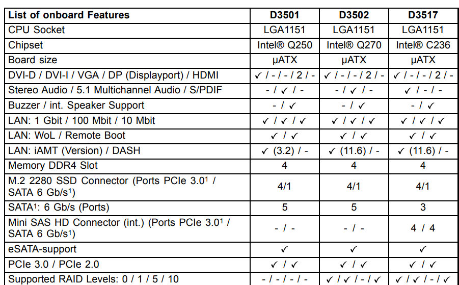

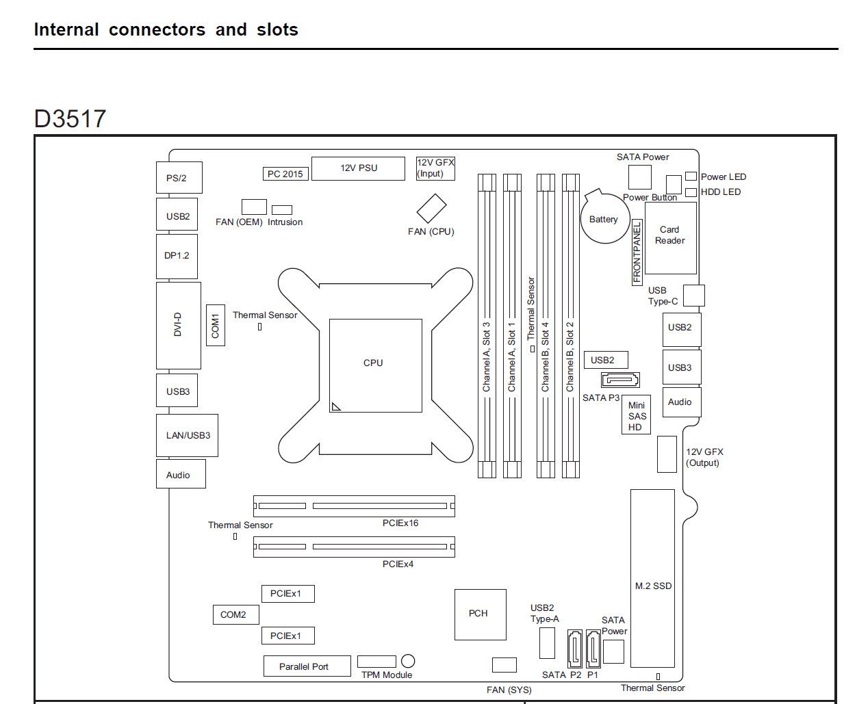

  3. Hi, as Unraid is not setup yet that proves to be difficult at the moment. However the drives should already show up in the BIOS. When using the original Fujitsu cable they do, so I don't expect any changes when installing Unraid, right?
