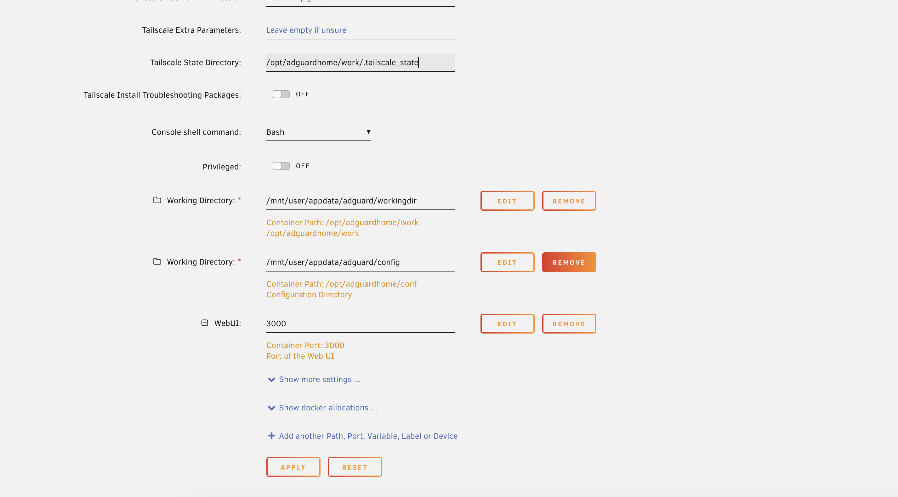

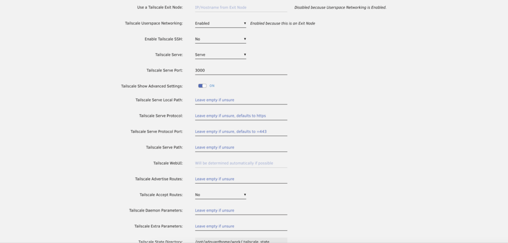

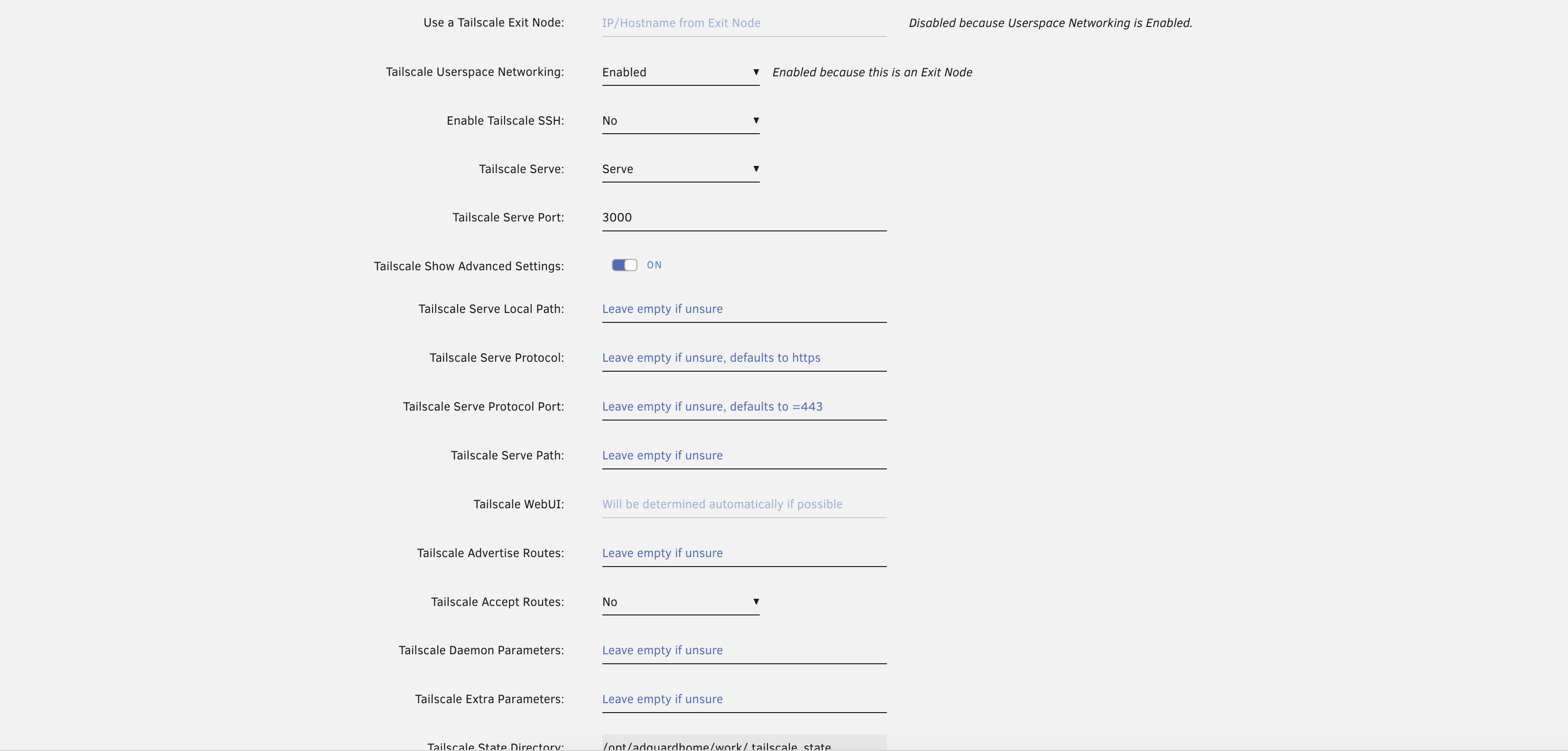

  7. Yes, the router also uses AdGuard as DNS. Changing to dedicated DNS for the adguard container worked. Was able to authenticate the container in tailscale now. But now this is the log: xecuting Unraid Docker Hook for Tailscale Detecting Package Manager... Detected Alpine Package Keeper! Installing packages... Please wait... Packages installed! Tailscale not found, downloading... Please wait... Download from Tailscale version 1.78.1 successful! Installation Done! Settings Tailscale state dir to: /opt/adguardhome/work/.tailscale_state Enabling userspace networking! Tailscale DNS not available Setting host name to "AdGuard" Configuring container as Exit Node! See https://tailscale.com/kb/1103/exit-nodes Starting tailscaled with log file location: /var/log/tailscaled Starting tailscale Some peers are advertising routes but --accept-routes is false ERROR: Enable MagicDNS and HTTPS on your Tailscale account to use Tailscale Serve/Funnel. See: https://tailscale.com/kb/1153/enabling-https ERROR: Unraid Docker Hook script throw an error! Starting container without Tailscale! Starting container... ======================= Actually I only need a tailscale exit node on my unraid. I wanted to use my unraid itself as exit node, but it does not work, as I mentioned above. So I thought I just install tailscale in the AdGuard Container and use this as exit node. If I could use unraid as exit node, I would not need any tailscale in the AdGaurd container at all.
  8. Yes, I used the adguard container as DNS also for unraid. Changed that to 1.1.1.1 now. Disabled "Be a Tailscale Exit Node" in the container setup. Still same problem: Executing Unraid Docker Hook for Tailscale Detecting Package Manager... Detected Alpine Package Keeper! Installing packages... Please wait... ERROR: Installing packages! fetch https://dl-cdn.alpinelinux.org/alpine/v3.18/main/x86_64/APKINDEX.tar.gz WARNING: updating and opening https://dl-cdn.alpinelinux.org/alpine/v3.18/main: temporary error (try again later) fetch https://dl-cdn.alpinelinux.org/alpine/v3.18/community/x86_64/APKINDEX.tar.gz WARNING: updating and opening https://dl-cdn.alpinelinux.org/alpine/v3.18/community: temporary error (try again later) 4 unavailable, 0 stale; 20 distinct packages available fetch https://dl-cdn.alpinelinux.org/alpine/v3.18/main/x86_64/APKINDEX.tar.gz WARNING: updating and opening https://dl-cdn.alpinelinux.org/alpine/v3.18/main: temporary error (try again later) fetch https://dl-cdn.alpinelinux.org/alpine/v3.18/community/x86_64/APKINDEX.tar.gz WARNING: updating and opening https://dl-cdn.alpinelinux.org/alpine/v3.18/community: temporary error (try again later) ERROR: unable to select packages: jq (no such package): required by: world[jq] wget (no such package): required by: world[wget] ERROR: Unraid Docker Hook script throw an error! Starting container without Tailscale! Starting container... ======================= 2024/12/19 13:25:29.987164 [info] AdGuard Home, version v0.107.55 2024/12/19 13:25:29.992691 [info] tls: using default ciphers 2024/12/19 13:25:30.005301 [info] Initializing auth module: /opt/adguardhome/work/data/sessions.db 2024/12/19 13:25:30.005464 [info] auth: initialized. users:1 sessions:4 2024/12/19 13:25:30.005469 [info] web: initializing 2024/12/19 13:25:30.100838 [info] dnsproxy: upstream mode is set mode=parallel 2024/12/19 13:25:30.100849 [info] dnsproxy: cache enabled size=4096 2024/12/19 13:25:30.100853 [info] dnsproxy: max goroutines is set count=300 2024/12/19 13:25:30.100874 [info] dnsproxy: cache ttl override is enabled min=600 max=10800 2024/12/19 13:25:30.100876 [info] dnsproxy: ratelimit is enabled rps=100 ipv4_subnet_mask_len=24 ipv6_subnet_mask_len=56 2024/12/19 13:25:30.100878 [info] dnsproxy: server will refuse requests of type any 2024/12/19 13:25:30.100881 [info] dnsproxy: upstream mode is set mode=parallel 2024/12/19 13:25:30.100883 [info] dnsproxy: cache enabled size=990000000 2024/12/19 13:25:30.100885 [info] dnsproxy: max goroutines is set count=300 2024/12/19 13:25:30.100991 [info] addrproc: processing addresses 2024/12/19 13:25:30.101395 [info] AdGuard Home is available at the following addresses: 2024/12/19 13:25:30.101480 [info] go to http://127.0.0.1:80 2024/12/19 13:25:30.101483 [info] go to http://[::1]:80 2024/12/19 13:25:30.101484 [info] go to http://192.168.2.10:80 2024/12/19 13:25:30.805480 [info] dnsproxy: starting dns proxy server 2024/12/19 13:25:30.805497 [info] dnsproxy: creating udp server socket addr=0.0.0.0:53 2024/12/19 13:25:30.805547 [info] dnsproxy: listening to udp addr=[::]:53 2024/12/19 13:25:30.805553 [info] dnsproxy: creating tcp server socket addr=0.0.0.0:53 2024/12/19 13:25:30.805570 [info] dnsproxy: listening to tcp addr=[::]:53 2024/12/19 13:25:30.805609 [info] dnsproxy: entering udp listener loop addr=[::]:53 2024/12/19 13:25:30.805786 [info] dnsproxy: entering listener loop proto=tcp addr=[::]:53
  9. I get this errors in the log now... Executing Unraid Docker Hook for Tailscale Detecting Package Manager... Detected Alpine Package Keeper! Installing packages... Please wait... ERROR: Installing packages! fetch https://dl-cdn.alpinelinux.org/alpine/v3.18/main/x86_64/APKINDEX.tar.gz WARNING: updating and opening https://dl-cdn.alpinelinux.org/alpine/v3.18/main: temporary error (try again later) fetch https://dl-cdn.alpinelinux.org/alpine/v3.18/community/x86_64/APKINDEX.tar.gz WARNING: updating and opening https://dl-cdn.alpinelinux.org/alpine/v3.18/community: temporary error (try again later) 4 unavailable, 0 stale; 20 distinct packages available fetch https://dl-cdn.alpinelinux.org/alpine/v3.18/main/x86_64/APKINDEX.tar.gz WARNING: updating and opening https://dl-cdn.alpinelinux.org/alpine/v3.18/main: temporary error (try again later) fetch https://dl-cdn.alpinelinux.org/alpine/v3.18/community/x86_64/APKINDEX.tar.gz WARNING: updating and opening https://dl-cdn.alpinelinux.org/alpine/v3.18/community: temporary error (try again later) ERROR: unable to select packages: jq (no such package): required by: world[jq] wget (no such package): required by: world[wget] ERROR: Unraid Docker Hook script throw an error! Starting container without Tailscale! Starting container... =======================
  10. If I try to use unraid as my exit node with this command: tailscale set --advertise-exit-node I get this message: Tailscale exit nodes cannot be used on unraid

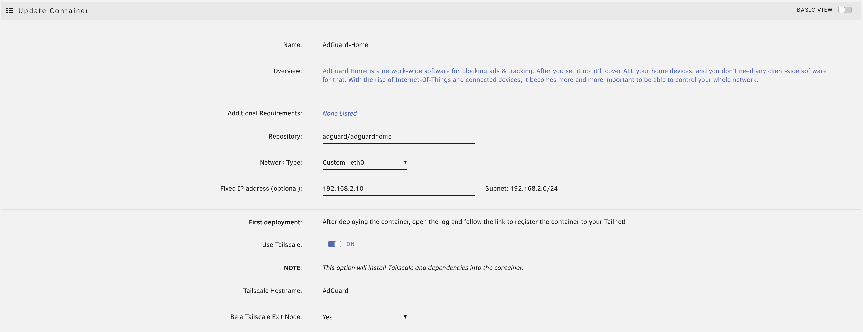

  11. Using this container from the communitiy apps: https://registry.hub.docker.com/r/adguard/adguardhome In the container setup of unraid I just activate tailscale.
  12. I cannot enable unraid as an exit node. It seems to be an issue with that: https://github.com/tailscale/tailscale/issues/14372 So is it at all possible to use unraid as an exit node? I also cannot install tailscale into the docker-container of my Adguard. Would consider to use that as exit node instead. Any Idea, why I cannot install it into the container? Here is the log: Executing Unraid Docker Hook for Tailscale Detecting Package Manager... Detected Alpine Package Keeper! Installing packages... Please wait... Packages installed! Tailscale not found, downloading... Please wait... Download from Tailscale version 1.78.1 successful! Installation Done! Settings Tailscale state dir to: /config/.tailscale_state Enabling userspace networking! Tailscale DNS not available Setting host name to "AdGuard" Starting tailscaled with log file location: /var/log/tailscaled Starting tailscale
