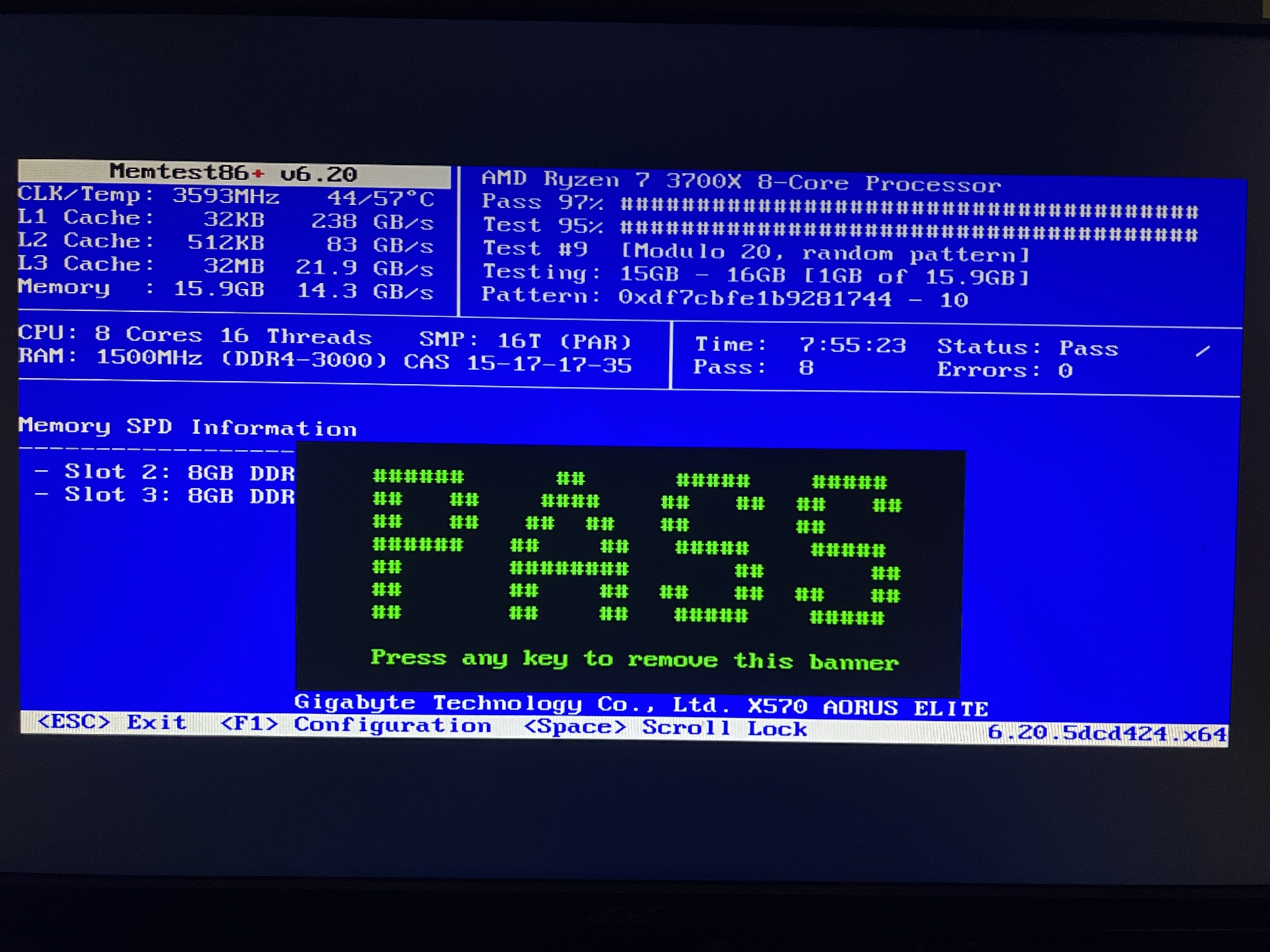

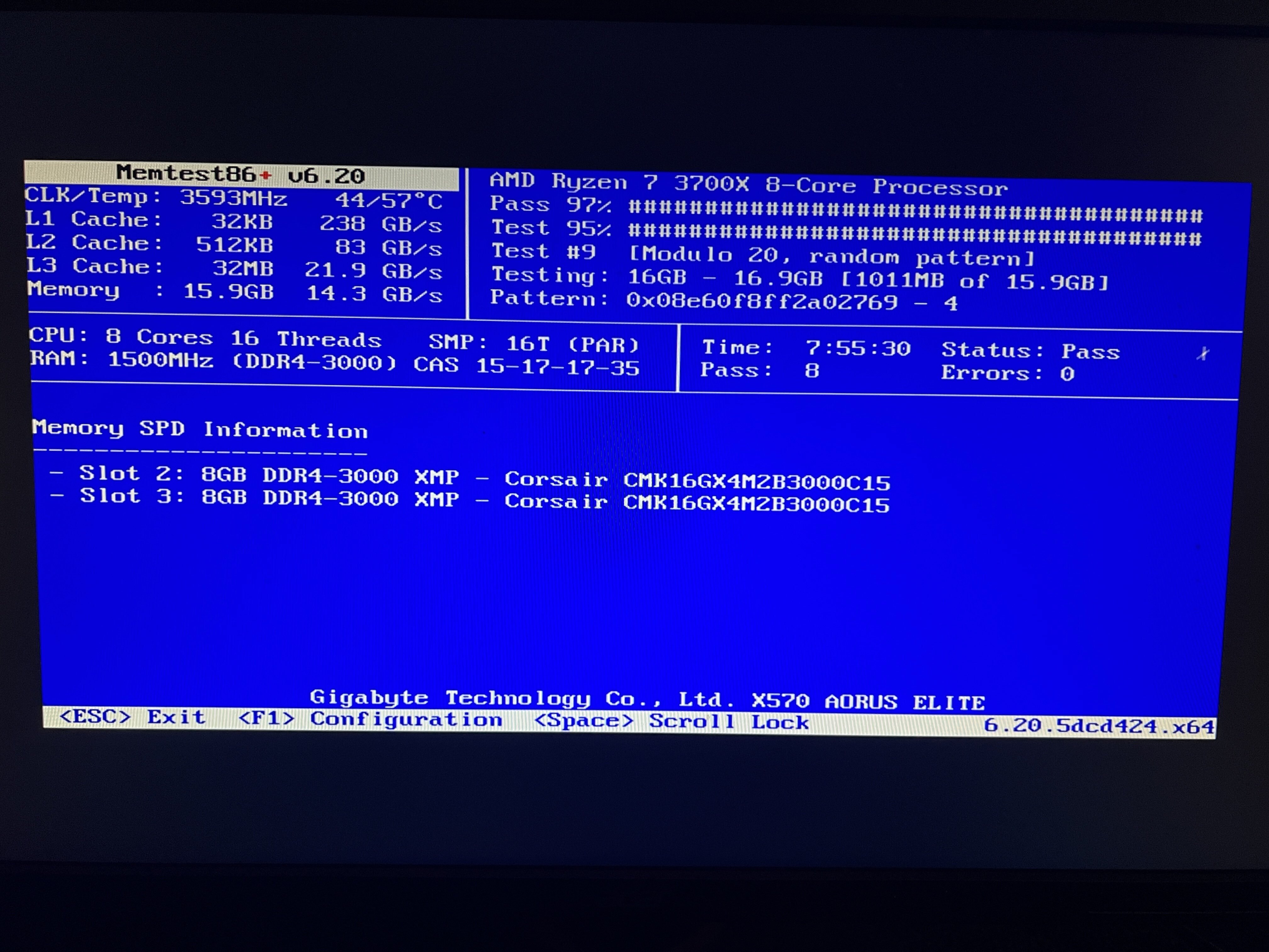

  2. Thankyou for your reply! I never mentioned but for the record I am running Unraid v7.0.0 now, but this issue began on the previous v6.12.10 I believe it was? I ran a couple Memtests86+ (v6.20) via the Unraid startup menu. Both tests have reported 0 errors. I ran the first quickly. I let it do 3 passes, which showed a 'Pass' and reported 0 errors. Just for the record- I then, based on something I read, simply swapped my RAM sticks positions, i.e. swapped the two sticks over A2 to B2 and B2 to A2, still adhering to the population order marking on the X570 MOBO. I read somewhere this was one of those strange random things that magically fixed an issue for someone so I thought why not. Then last night, I started a 2nd Memtest86+ again via Unraid startup menu, and left this overnight. When I returned this morning, I had a 'Pass' screen, and again with 0 errors reported. It had completed 8 passes. Here are pictures I took of the screen after returning to this run. I shall have a look at diagnostics & syslogs when I get a spare moment! So now that I have completed this, is this definitive evidence that my RAM is not the issue? What else can I do to diagnose? What are we thinking now?
