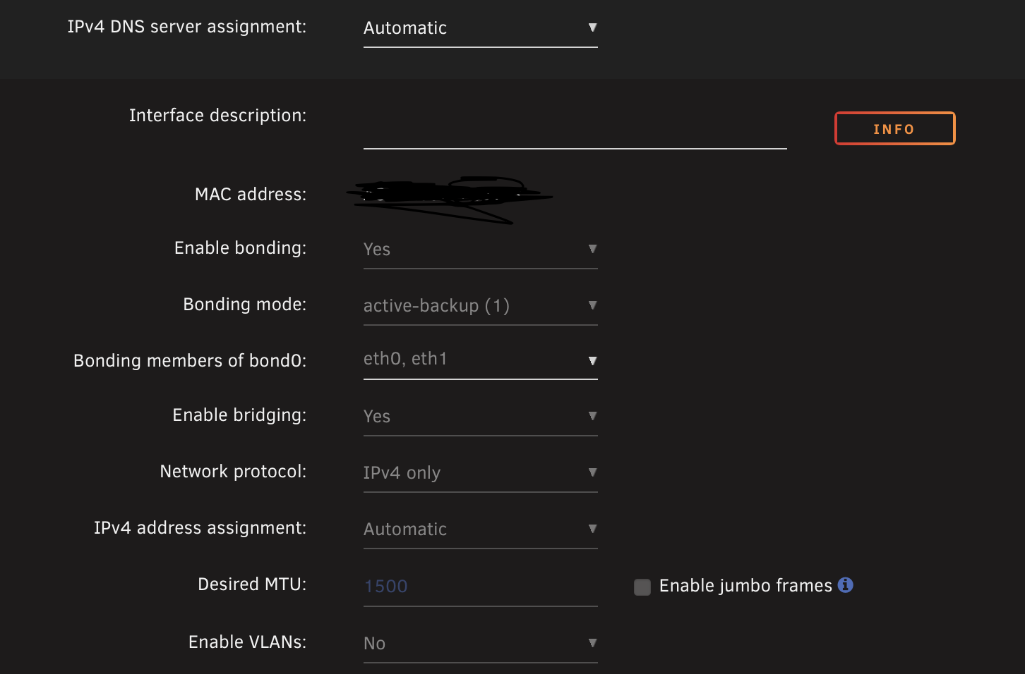

  2. I'm trying to figure out what could be causing it? Any idea? Eth0 is my router connection via cable Eth1 is the internal server connection? I don't really understand networking too well. This is how my Network settings look: Should I change anything?
