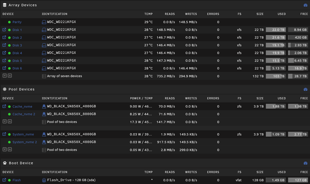

  12. I tried moving large files from the cache to a new 22TB drive with less than 25% usage and still getting transfer speeds of less than 150 MB/s. What could possibly be causing this bottleneck???
