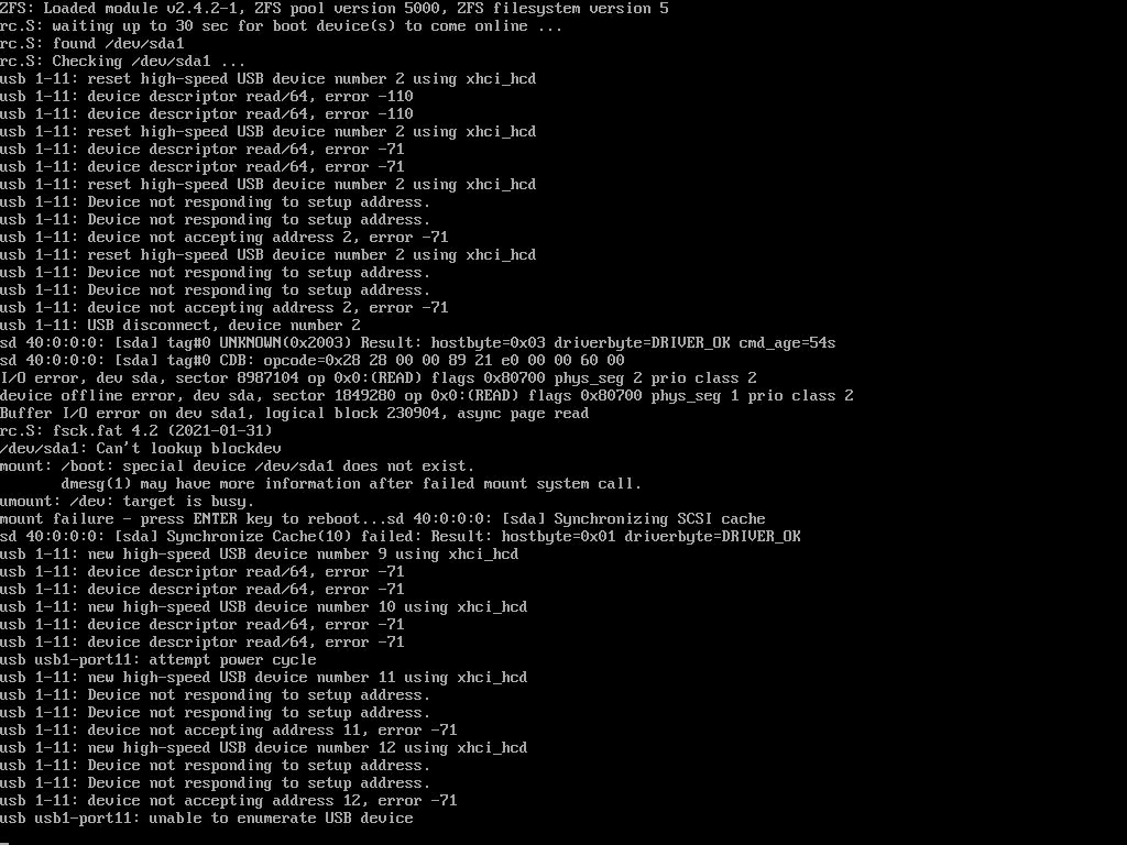

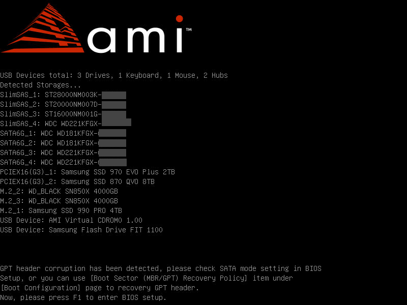

  4. After preclearing a new disk in Unraid booting the PC shows this: This has never happened before. Then again, I don't think I have ever done a full preclear before either.

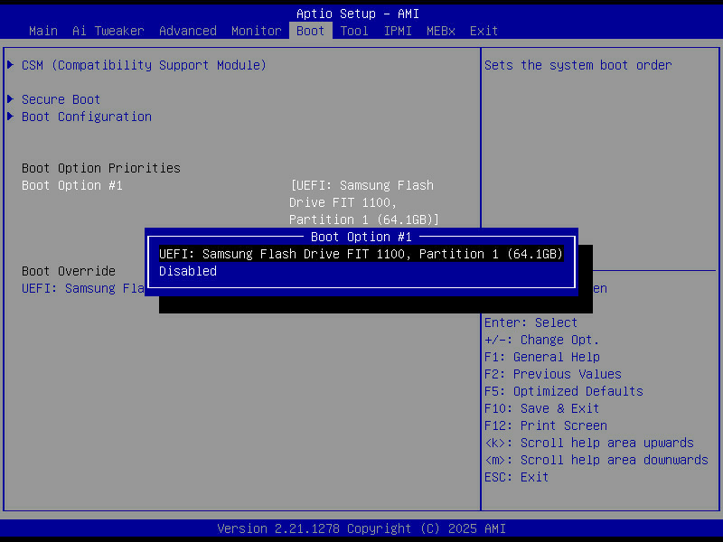

  5. I noticed that in BIOS the flash drive was not available as a boot device. Kind of strange. Another reboot seems to have solved the issue.

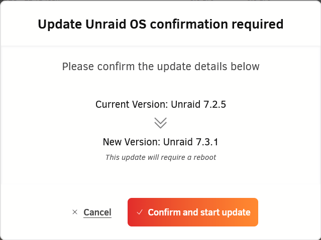

  6. Upgrading from 7.2.5 to 7.3.1: After a reboot: Now what?

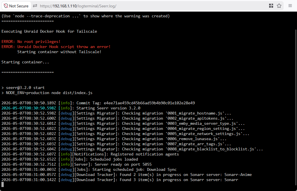

  7. Is there a guide for how to configure this? I can install Tailscale-Docker but I have no idea how to set it.
  8. I also have this problem. Any advice would be great.
  9. I also have this problem and I have no idea how to configure Tailscale Services.

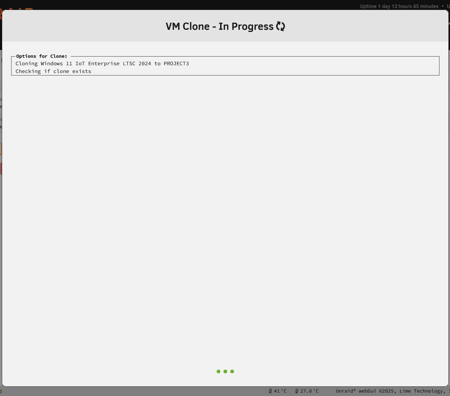

  10. Cloning VM is stuck. Syslog shows nothing. Seems like the GUI doesn't even reach the cloning phase. It’s stuck before execution.

  14. The flash disk is simply not available as a boot drive after upgrading to version 7.2.5 and restarting. If I add the flash drive to my Windows computer I can navigate the directories on the flash drive. Seems like something broke. Where should I begin?

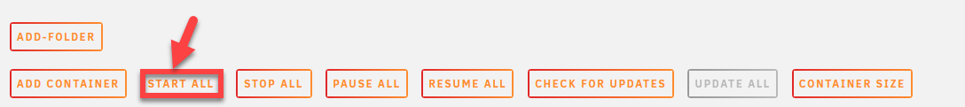

  15. In that case it is definitely not working for me. If I click START ALL only some containers will start. The containers that does not start doesn't have any errors. Manually starting them through the WebGUI works so I am not sure why.
