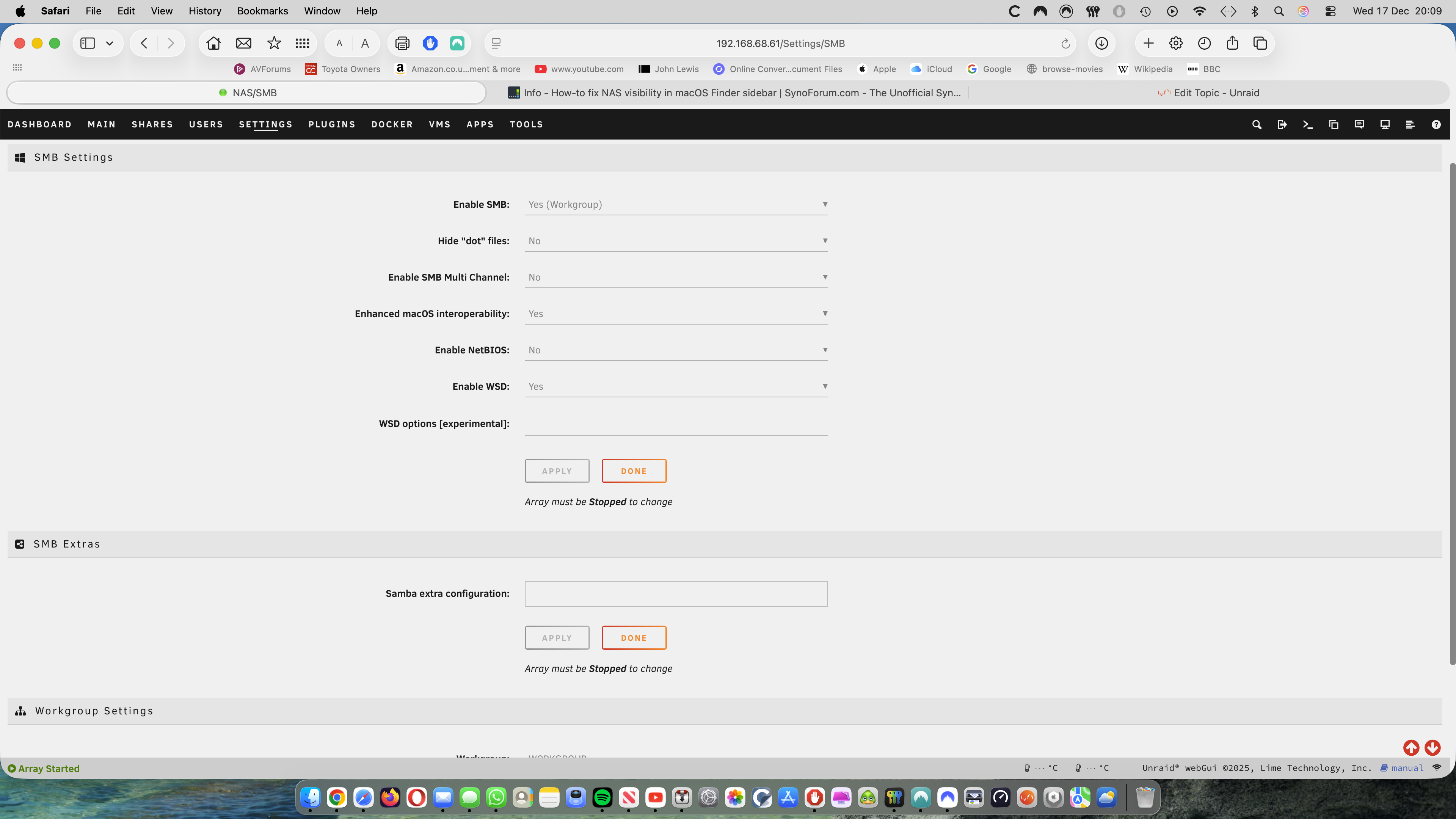

  3. Sorted Turns out I was looking in the wrong settings section for Connect To Server DOH! Found it under GO. Typed in IP for NAS and everything is there now in Finder.......told you it was something simple....me!
  4. Since rebuilding my NAS OS everything works OK. I can stream media to my TV and I can access my NAS on my Mac via IP. But it doesnt show in finder. I dont have a "Connect to Server" option in finder despite it being selected in OS settings on Mac. SMB is set to Yes in UNRAID settings. I get the feeling this is a MAC issue but I just dont know. I get the feeling it is something simple...... Any help appreciated
