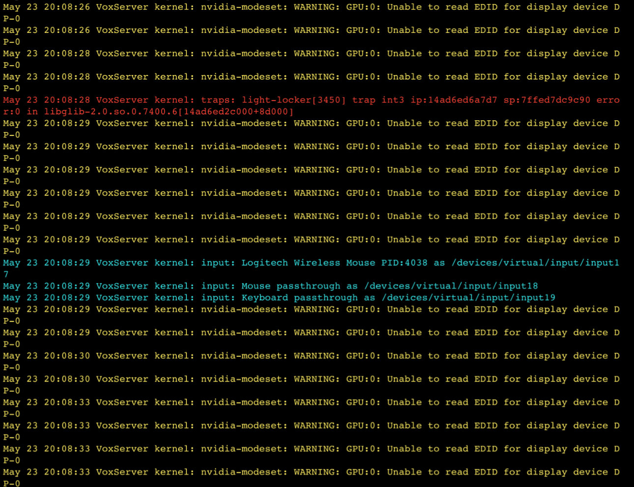

  1. Hello. Could somebody help me please. I habe this weird errors when i star steamheadless. It don't effects anything for now, but i want to know i i will have some problem with this.
