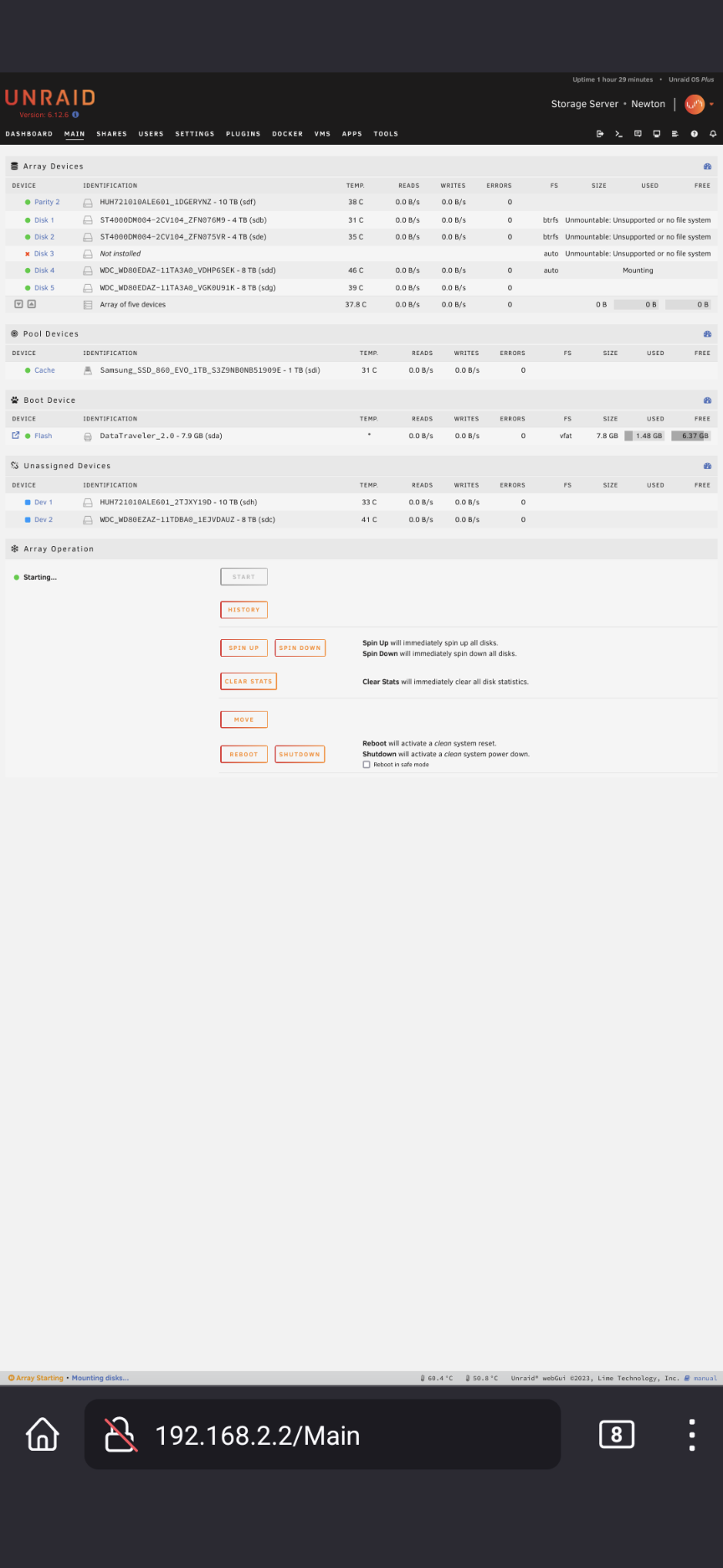

  3. I performed the steps but see the disk is shown with a mount error (see screenshot). And indeed as suspected it got stuck at the next disk trying to mount. newton-diagnostics-20240514-1538.zip

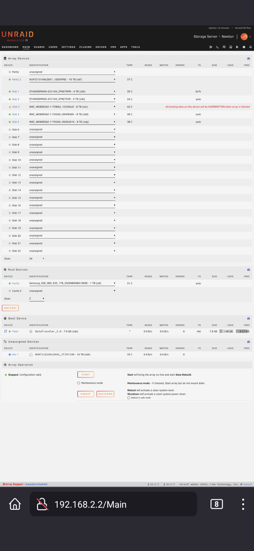

  5. Very strange indeed. My disks are fine, they worked and only the bad disk failed thus I performed the parity swap procedure. I performed all steps of the parity swap procedure up untill and step 14. I was not able to start the array as I refreshed the tab and it wanted me to perform the copy again. So I found this thread and performed the steps to circumvent it. Create new config with perserve all selected. Run the command mdcmd set invalidslot 3 29. (It so happens my third disk failing) And then I started the array, which crashed before mounting disks. It just showed starting array. On which I sought help through this thread. And now it keeps crashing on the mount step.

  11. A that is good news! I tried rebooting, but it is unresponsive through the GUI and CLI. So I will physically reboot by holding the power button. And that would be it?
