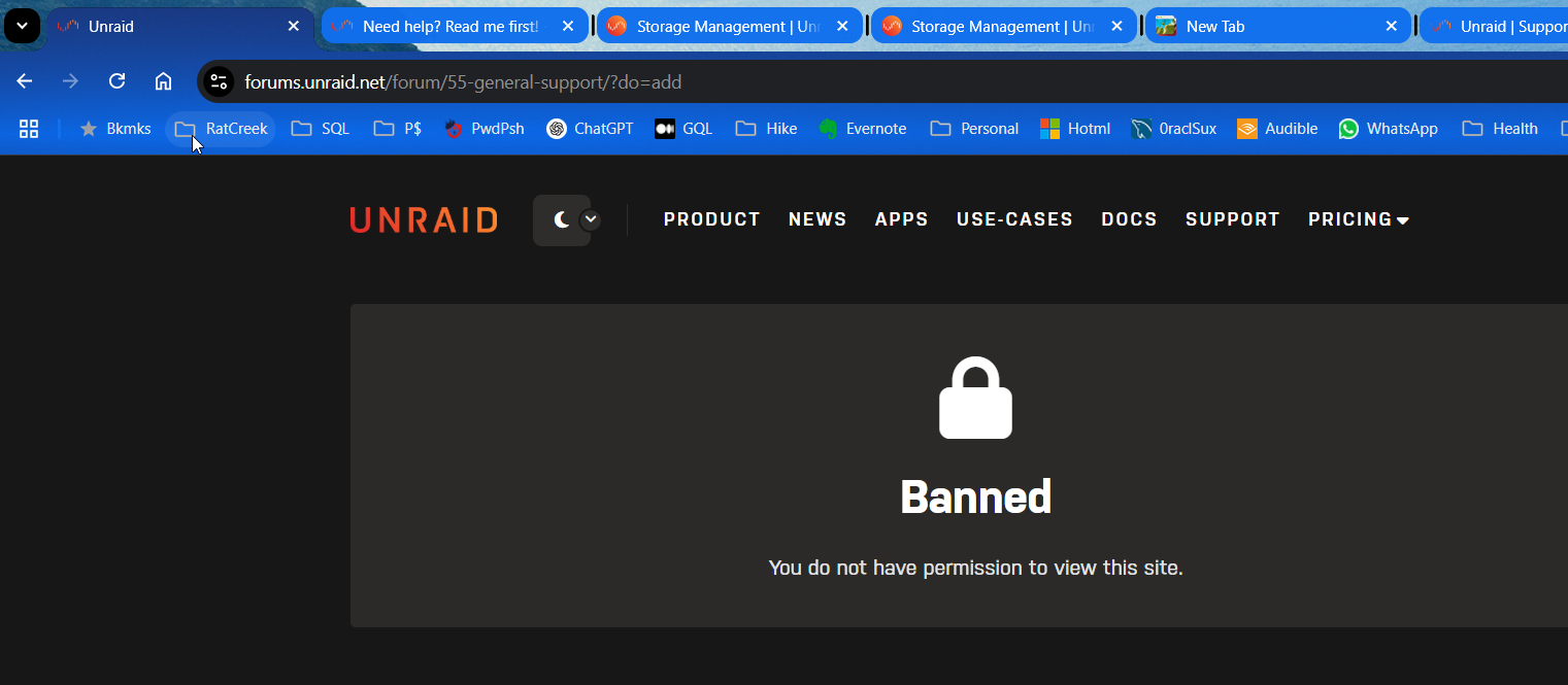

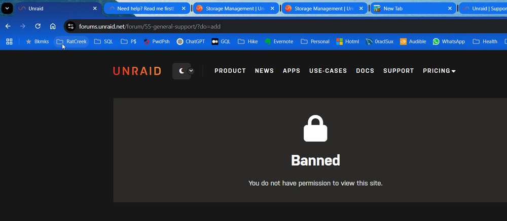

  8. When I (logged in with my year-old account) submit my 100-line request with screenshot and diagnostics attached, Forum Submit returns, "Banned You do not have permission to view this site." Attempting to contact Limetech rejects my creds following password reset, sends me to https://limetechnology.myfreshworks.com/org/login?error=bad_credentials .
